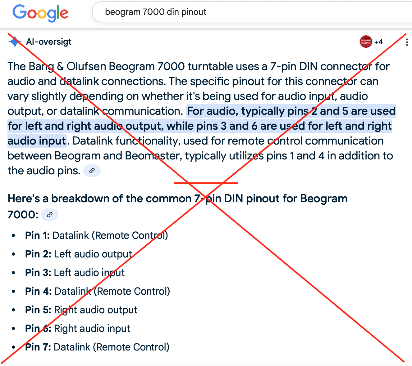

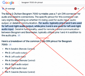

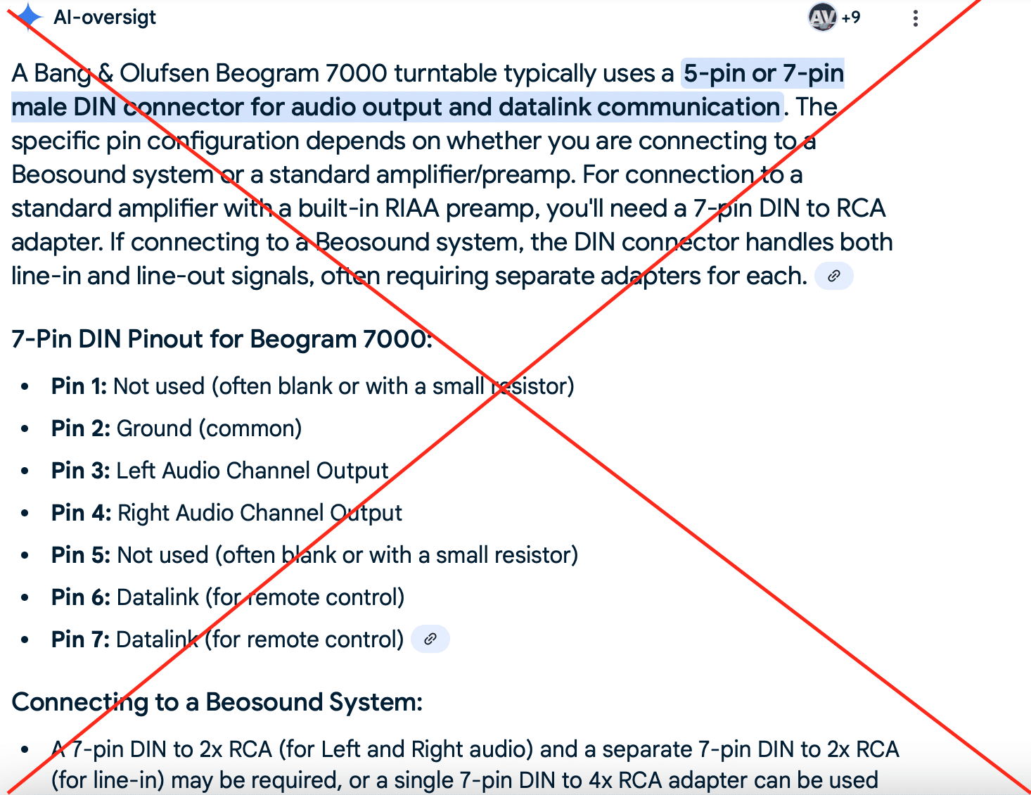

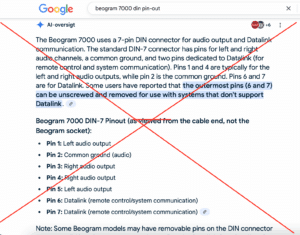

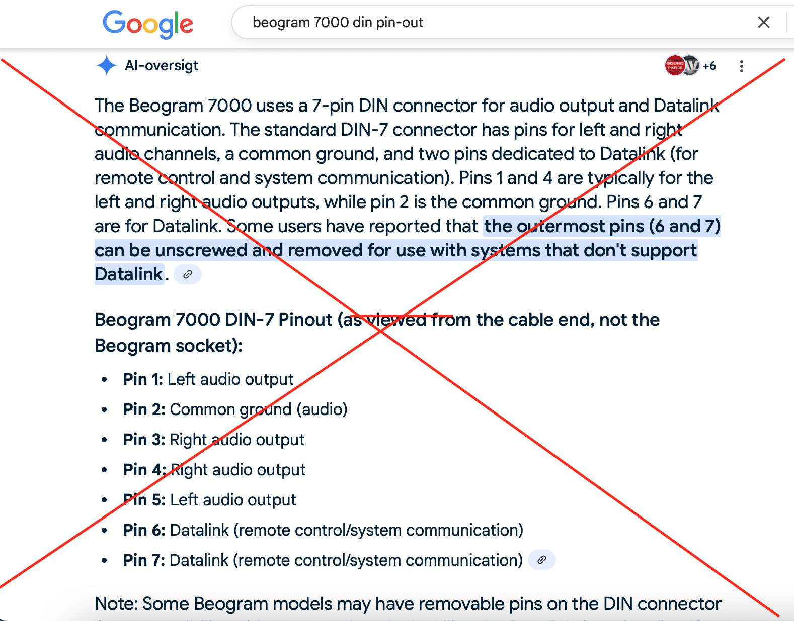

5 July 2025 at 17:55 #66817Madskp
GOLD Membermost of the time pin numbers are as in the attached photo, looking at the inside of the DIN plug, the solder side. Also, see some online information specifically for the BG7000 system, BUT in this case, I can’t be sure if the numbers are from the solder side or the face-side of the plug…
Please be aware that the Google AI suggestion in one of the attached pictures is not showing the correct pinout as it shows pin 1 and 4 for audio output where the correct ones are pin 3 and 5, so I would not trust these AI results for anything usefull
To prove my point I tried to do the same google search with 3 different ways to spell pinout and got three different suggestions for the pinout (all wrong and crossed out to avoid spread of misinformation).
I have a hard time trusting these AI results where and old fashion search would have given similar results even if I did not spell pinout the same way 😖
———- Rant over ————
Instead I would refer to something like this
and this thread that might also be helpfull
https://forum.beoworld.org/forums/topic/how-to-wire-7-din-plug-to-beogram/

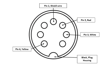

6 July 2025 at 10:33 #66827Nebojsa Jankovic
BRONZE MemberHello Madskp, I cannot agree more with you! I just posted those to illustrate my point, made and summarized very explicitly earlier! I have also done multiple cross-checks for the online information and have concluded that I can only trust what I see and what I probe. On the image posted by Layesera, I can see clearly white (to pin 3) and red (to pin 5) wires, left and right high signal, yellow for data (to pin 6), but then 3 other wires all seem black, so one of them should go to pin 2 (shield), one to plug housing… And this image is a view from the solder side of the DIN plug, inside of the plug.
