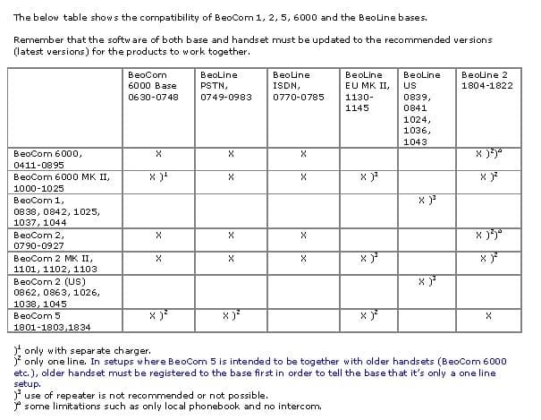

    What version of PSTN are you using?  Is it the second one along on the table below?
    Check compatibility between phone and PSTN using the table – for example there could be problems using BC6000 Mk1 with Beoline EU Mk2.

    That’s a Beoline EU Mk2.  If you take the second to fifth digits of the number under Beoline (1113068 GB), I can see that its Type Number is 1130, and then you can make reference to that table.  The GB next to the number indicates that it is built for the UK market and should be able to provide caller ID with compatible phones.
    Unfortunately the table indicate that the BC6000 Mk1 is incompatible with that PSTN  – basically not all functions work.  I had a similar problem connecting a BC2 Mk1 to a Beoline Mk2 where everything worked except clock and phonebook.
    First I would be tempted to try your original PSTN again, resetting phones and PSTN before setting up the whole system from scratch.
    Failing this, I would be tempted to replace your three BC6000 Mk1s with the much more capable and reliable BC6000 Mk2s – they are quite good value on UK eBay currently.
