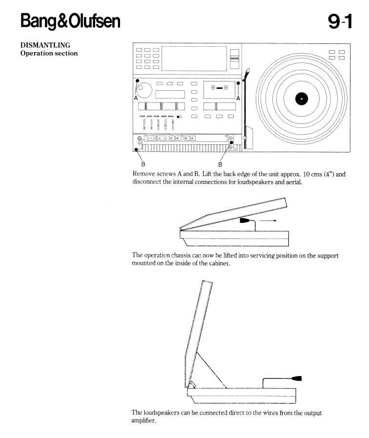

    And also found the 7002 manual now – thanks again! Had been pressing buttons a little haphazardly but that now suggests Tape + P1 to activate Aux; unless anybody knows of a key combination wrinkle on the 7000 I guess the problem must be on the inside? Anybody have any clues? Or even a basic instruction for how to open the thing up? 😮
    Again many thanks for any help!
    #48561
    Guy
    From the Service Manual (avail on this site for Silver/Gold Members) – I will give you this sneak preview for free!  A technician would want the full manual which includes the circuit diagrams.

    I actually have the circuit board layout from the non-user manual, mais en Francais! Might as well be Chinese frankly ftho, for all the sense I can make of it 🙂
    Will try to have a pole around tomorrow, and in the meantime any tips still gratefully appreciated!
