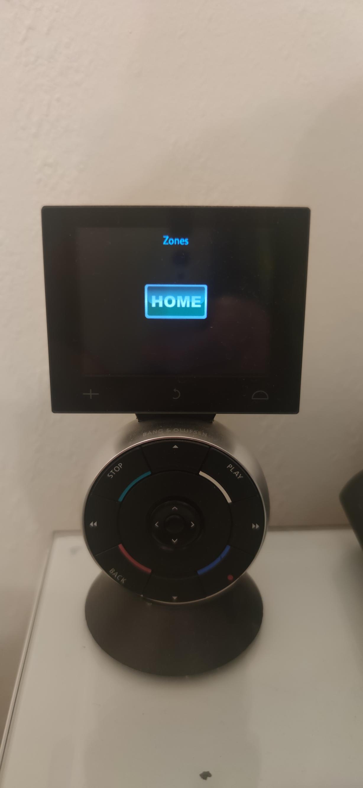

    I love to make it work for my installation (i am quircky indusrial designer ;)) so laove to see how it works (never got it setup since i acquired it second hand). Nils
    I enjoy designing things and made buttons for my Beo5 /Beo6. Here are some photos. They look far better in real life than in the pictures.
    Good luck and enjoy programming.
