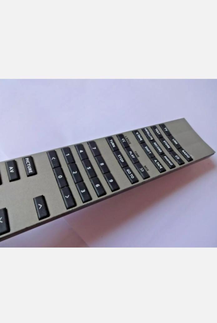

    currently i get the code  display when powered on and it remains dormant for hours and then comes to life,but as the glass panels are both lose it cant be controlled manually and seems to be on some kind a timer (it was  my friends dads who has passed away) so im trying to reset it some how and bring it back to life, as its complete with original speakers turntable etc. (pic to follow once ive dusted it off)
    one Query is i have 2 remote controls beolink 1000 and beolink 5000 and im wondering what models the beolink 1000 controls? Thanks Screenshot_20241127_131449_com_android_chrome_ChromeTabbedActivity_edit_214792188752725Screenshot_20241127_131518_com_android_chrome_ChromeTabbedActivity_edit_214679412559718

    The BL1000 should be fine for controlling the BC9500 also. You can check that a remote is transmitting by viewing the end with an iPhone selfie camera.
    If the BC9500 displays CODE, you should then use the BL1000 to press 1271 and then disconnect the Beoxenter from the mains for a minute. A frequent display of code suggests that the microprocessors backup battery needs replacing.

    did the 1000 remote come with a unit as standard? would it control a beosound 9000 i wonder?
    as ive been asked but have no idea.
    and is it easy to factory reset the 9500?

    The BL1000 was the standard ‘workhorse’ remote for many years and was supplied with many B&O systems. It will control the BS9000.
    The BL5000 was offered with systems that allowed two-way remote control, such as BC9500.
    if fully working and set in two-way mode, you should be able to use the BL5000 to remove any timers set on the BC9500.
    It would be worth having a good read of the BC9500 and BL1000 user manuals.
    I am away from home at the moment so can advise about BC9500 reset tomorrow, but if you have the service manual it explains how to enter test mode by shorting two pins under the lower panel.
