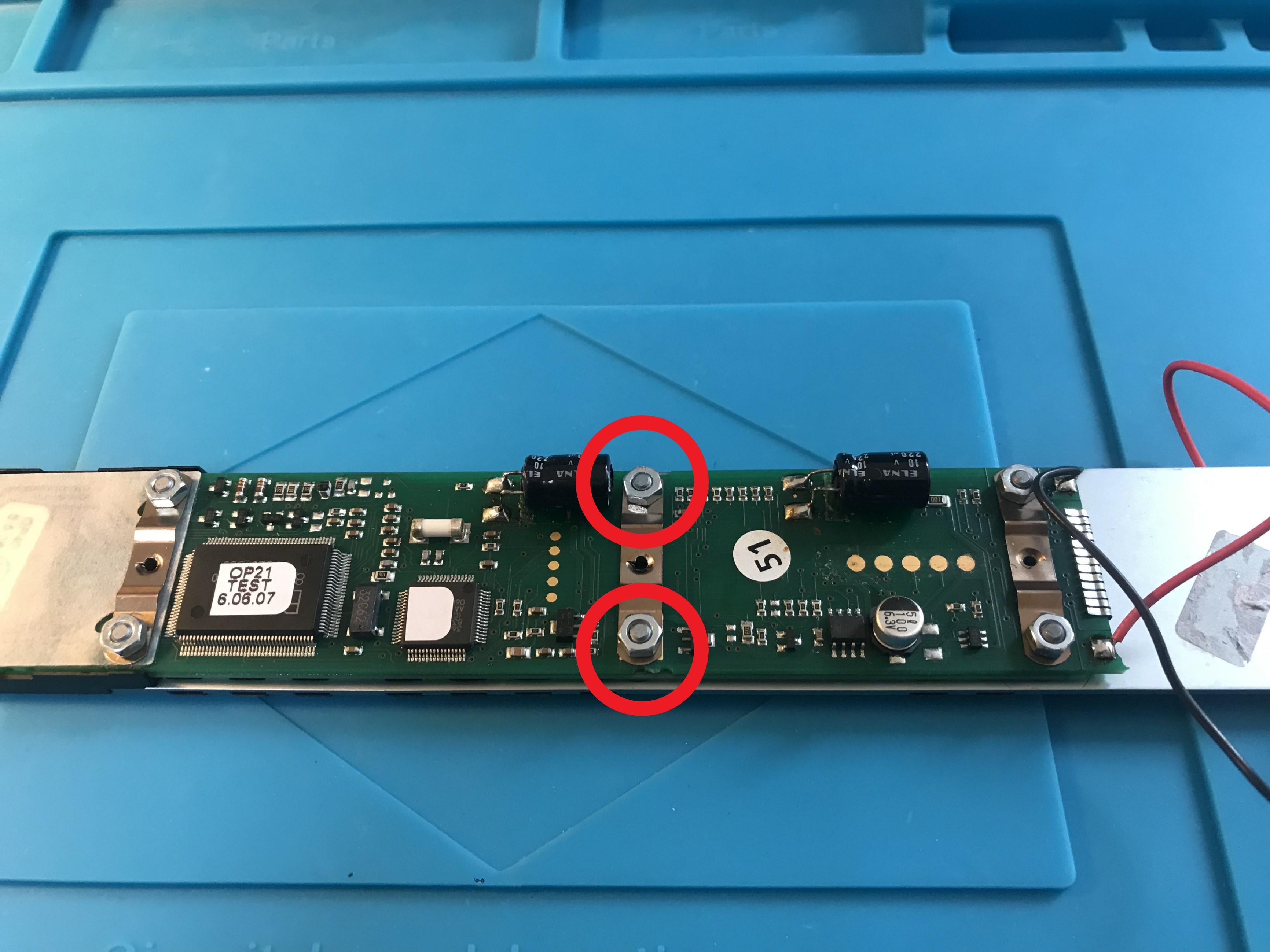

    Here’s a couple of photos:
    Firstly to show the amount that I tighten the nuts! (middle two circled ):
    (You can also see the little clip on the right edge of the PCB)
    IMG_5412

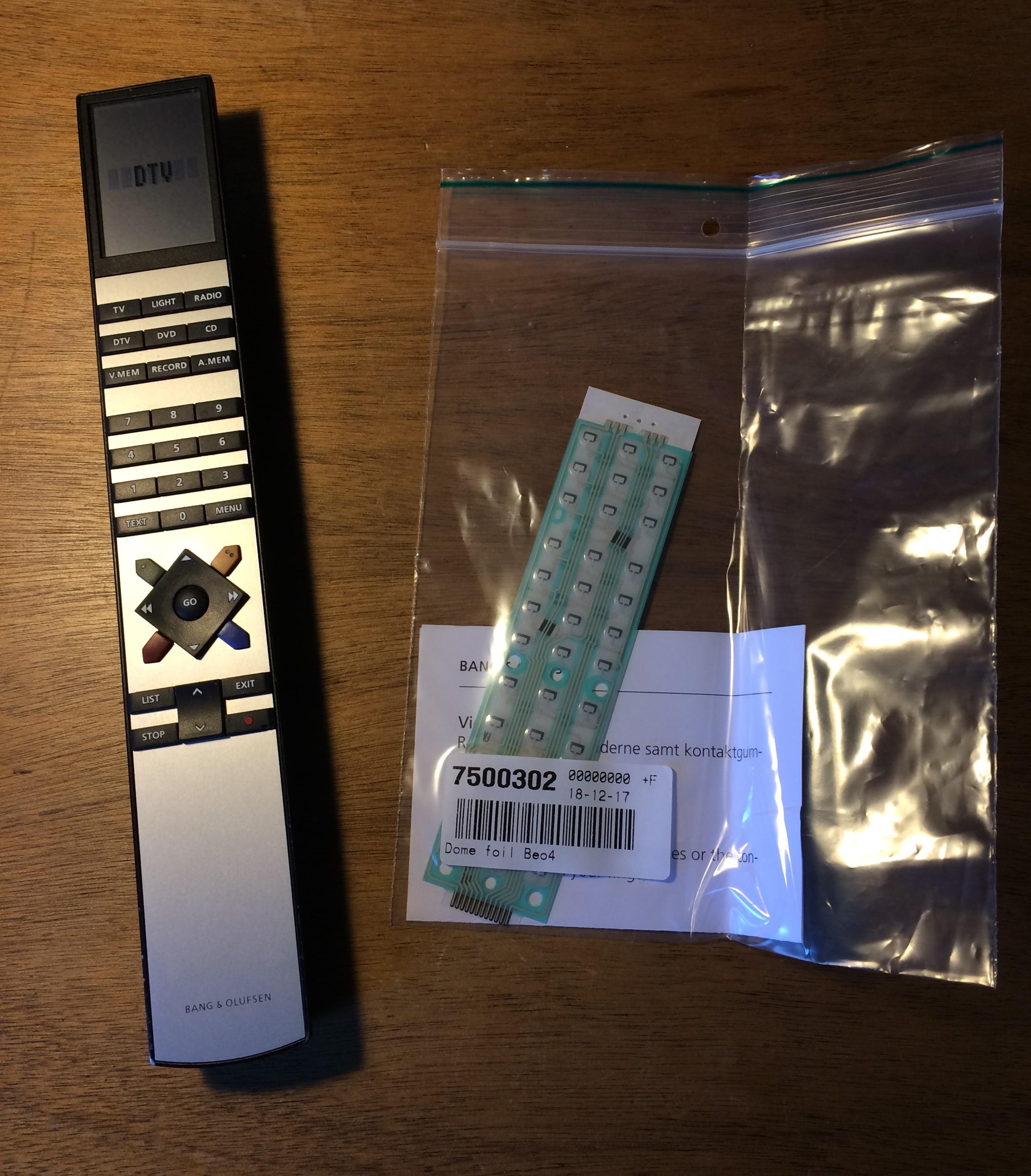

    And to show the foil part no:
    IMG_2608
