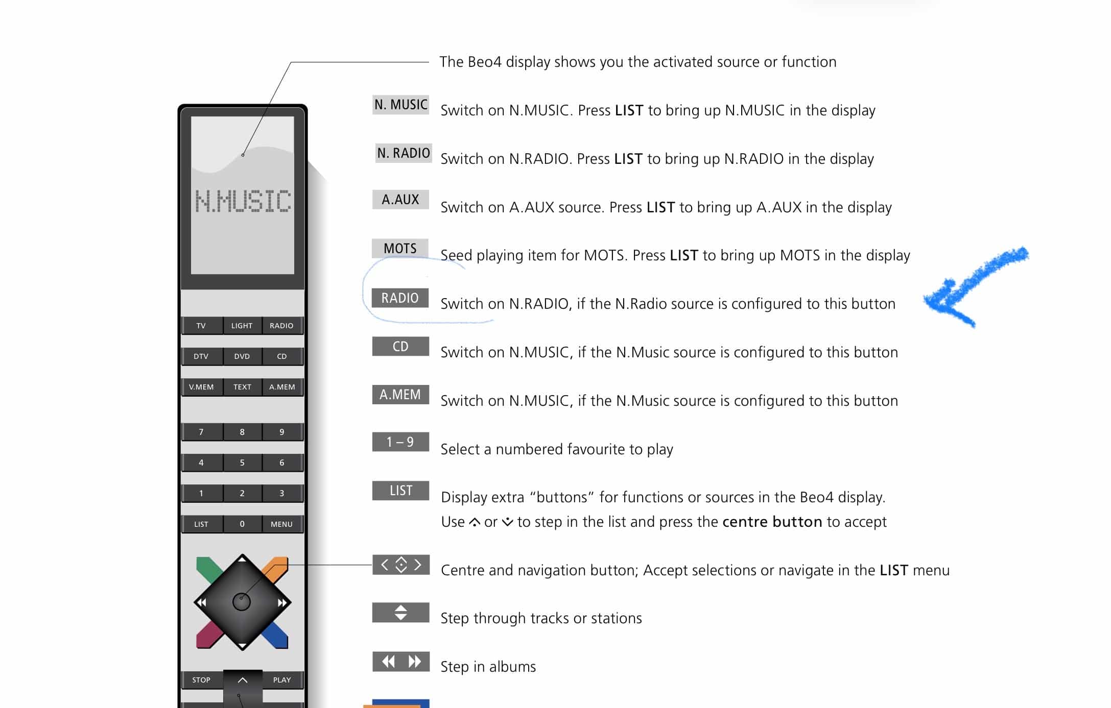

The normal Beo4s do not have a ‘music’ button. I assume you have a ‘hotel’ version – is N.MUSIC available in LIST?
Normal versions are as shown below – note button labels:

16 February 2026 at 20:37 #73902Juergen kress
BRONZE Memberthanks for the documentation link how can i please configure:
Switch on N.RADIO, if the N.Radio source is configured to this button
Dankeschön = big thanks
