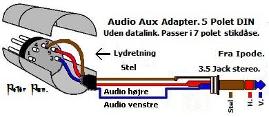

    Check that the lead is sending the L & R audio to DIN pins 3 and 5 respectively.  Pin 2 is ground.
    Viewing the socket:
    Screenshot (171)

    Use a multimeter or continuity tester to check for continuity between the tip and ring of the 3.5mm plug and pins 3 and 5 of the DIN plug.
    This may help:

    I did two tests. I first checked the continuity of the wire with a multimeter and its there is continuity.
    The second test I did was to insert a needle into the auxiliary holes at points 3 and 5 (right and left speakers) and noise is heard. But when I connect the wire, points 3 and 5 on the wire don’t make contact with the points I touched with the needle.
    My conclusion is that the cable has the speaker points backwards, that is, point three at point 1 and point 5 at point 4.
    Could be?
    Next Saturday I will go to Bang and Olufsen Mexico to have it checked by a technician.
    That sounds to me as if your cable is an output (from the DIN socket) rather than an input. (Pins 1 and 4 are the line output from the BS3200 Aux socket.) Hopefully a new cable and/or help from mexking will resolve the problem.
