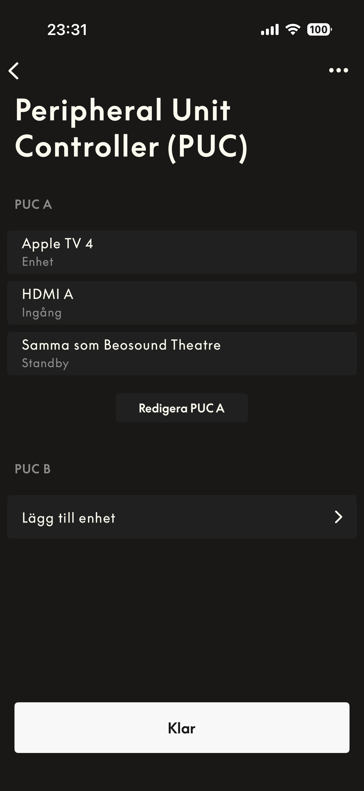

    #124782
    Bill Lumbergh
    I also think my AppleTV changed the settings once after a tvOS update.
    Let us start with securing that you have correct settings in AppleTV (unfortunately I have Swedish interface so my translations might be a bit wrong):
    1) In Settings select “Remote controls and units”
    2) Go to “Home cinema settings” In the bottom om the list
    3) Secure that “Control TV and receiver” is set to “ON”, that “Volume control” is set to “Auto through HDMI (receiver)”, and finally that “Show volume at screen” is set to “Hide”.
    Attached screenshot show my settings in the B&O app for the PUC. I don’t think there are any other settings in the B&O app that is related to this.
    if you have your AppleTV and B&O set as above we can continue with LG. Though some of their settings are quite hidden.
    • This reply was modified 2 months, 3 weeks ago by Bill Lumbergh.
