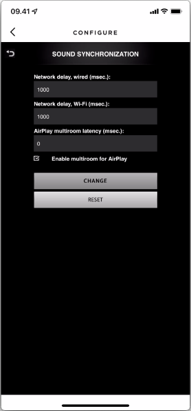

    In the Beolink settings in my devices there is an  option to enable Airplay over Multiroom.
    Configure Airplay
    In a recent dialogue with B&O support, they said I should de-select this box since its being replaced by Airplay 2.
    I recently tested a usecase I have and that is Airplay from my iPhone to my Beosound 1 GVA, and joining that play with my Beovision 11. That possibility seem not to be working anymore.
    Anyone have same experience?

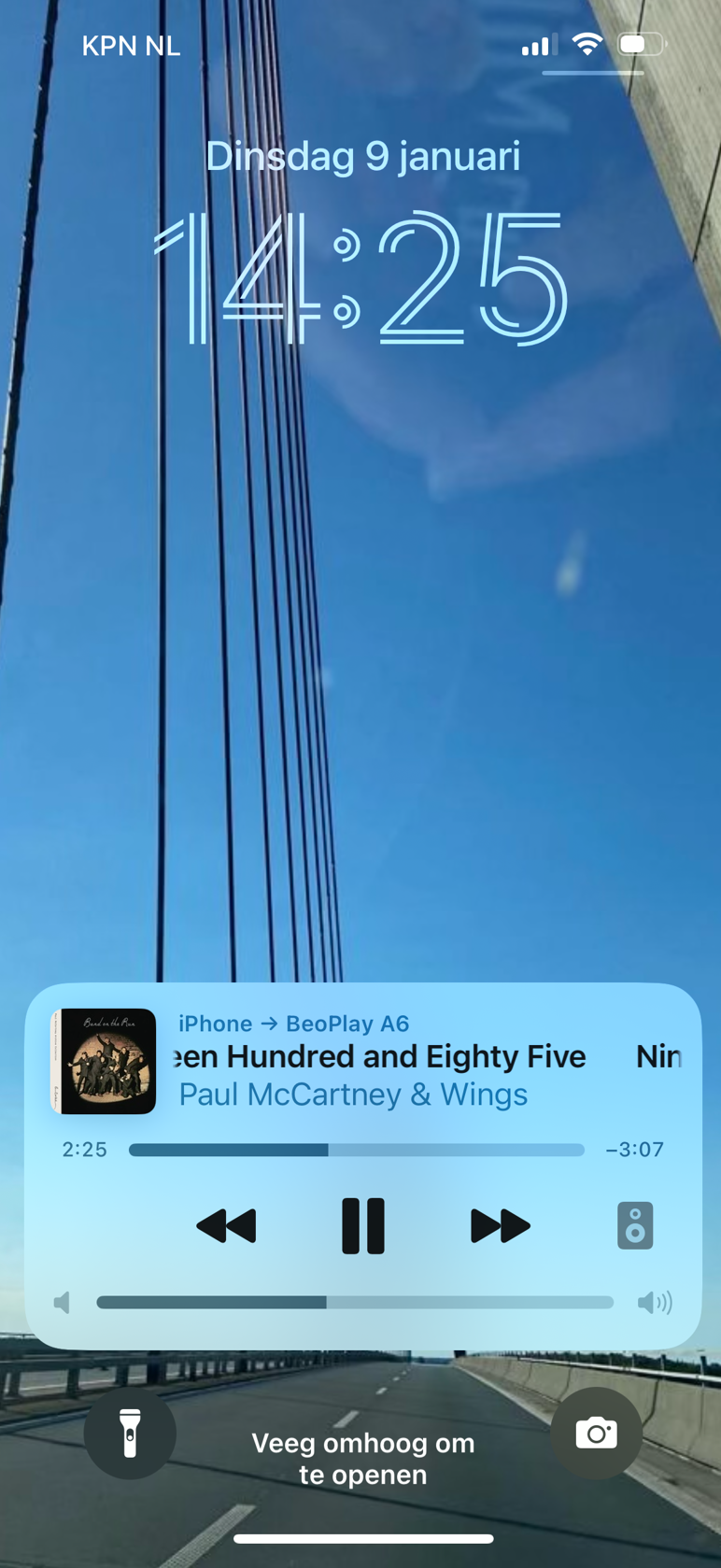

    In the Beolink settings in my devices there is an option to enable Airplay over Multiroom. Configure Airplay In a recent dialogue with B&O support, they said I should de-select this box since its being replaced by Airplay 2. I recently tested a usecase I have and that is Airplay from my iPhone to my Beosound 1 GVA, and joining that play with my Beovision 11. That possibility seem not to be working anymore. Anyone have same experience?
    Still working over here!
    Played DLNA to BP A6 multiroomed to BL8 and Moment. Started music on my iPhone and Airplayed it to the BP A6. Now all three devices are playing “Band on the Run”.

    This is the reply from Support that mentioned Airplay over multiroom:
    “Thank you for your patience while we work on your case. We’ll be happy to provide an update.
    We have checked with out technical team regarding your issue and they stated the network delay setting seems to be out of spec.
    They have provided the following instructions:
    Choose one of the products in the B&O app.
    Choose settings > configure > settings > beolink > sound synchronization
    Set wired to 200ms and wireless to 1000ms and try with these settings first
    If still dropouts change the wireless delay to 1500 or more.
    *If enabled the option “activate multiroom for airplay” then please disable as this is not used anymore since airplay 2 was introduced.”
    Not sure what they mean with “not used anymore”
    Location: Sweden

    Schermafbeelding 2024-01-09 142932
    What app is this? Looking pretty cool and quite different from my B&O app. The two tagged sources are joined. What about the linked source?
    #52059
    carolpa
    this is the beta version of the B&o app. But the latest app store release looks similar (if I’m correct)
    Correct
    Not quite sure what you mean, to me Joined and Linked are more of the same.
