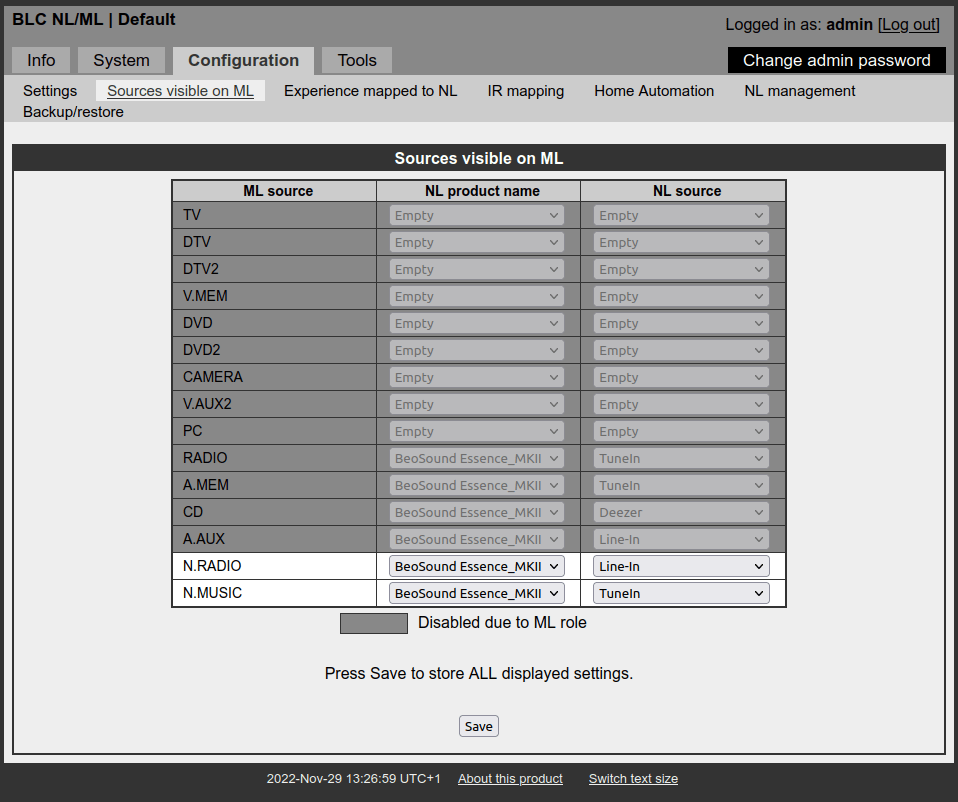

BRONZE MemberHere are the configuration pages from yesterday’s tests:
tux
BRONZE MemberBV7 is set to V.OPTION = 2 (confirmed by the flashing standby led).
Ouverture is set to A.OPTION = 0 (as shown in the BV7-55 manual).
BLC is set to ML rôle: source center.
In “Sources visible on ML” configuration page, only N.RADIO and N.MUSIC are available.
N.RADIO is configured for Essence LineIn (sound from my PC) and N.MUSIC for Essence TuneIn.Feedback:
- A.MEM commands the Ouverture’s tape.
- N.RADIO: Ouverture’s phono
- N.MUSIC: Ouverture’s tape 2
- On Essence (through mobile application), DTV source selected: no sound.

In « Sources visible on ML », setting is as following:
- RADIO: empty
- A.MEM: BS Essence MKII => TuneIn
- CD: empty
- A.AUX: empty
- N.RADIO: empty
- N.MUSIC: BLC => LINE IN

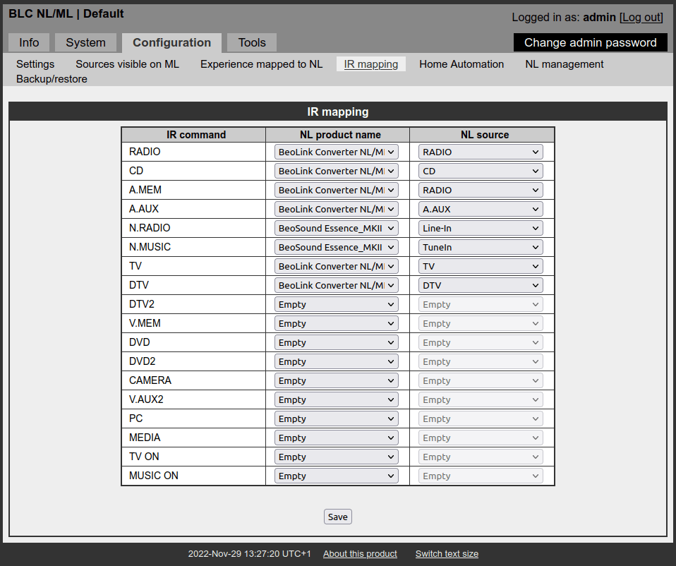

BRONZE MemberI tried with your proposal Carolpa and I think I made one step forward!
Now, when I press the RADIO button from the remote control unit, the TV switches to the radio but no sound. Why one step forward? Because until now, pressing RADIO button had no effect, TV stayed on its current input.
With the application on my mobile, on Beolink Converter device, the logo from the radio is displayed. When I change source from TV (A.MEM for example), the input change in the B&O application.
After my working day, I will play a bit with BLC settings.
Those which make the explained behavior are joined to this post.tux
BRONZE MemberIR mapping is not set because I don’t use the Eye (I red this feature works only when an IR Eye is used).
As soon as I can access to the system, I’ll change the setting according to your proposal and hope it works.
Thanks Carolpa.

BRONZE MemberUnfortunately, when I press RADIO on the Beo4 controlling the BV7, nothing happens.
My settings:
