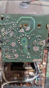

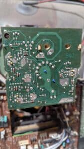

    Roberth Magnusson
    Do you remember which of the joints it was for you. Also do you see anything bad here? They look good to me, but yeah maybe worth resolder all. Do I need to discharge it before I do that? Sorry total novice here.
