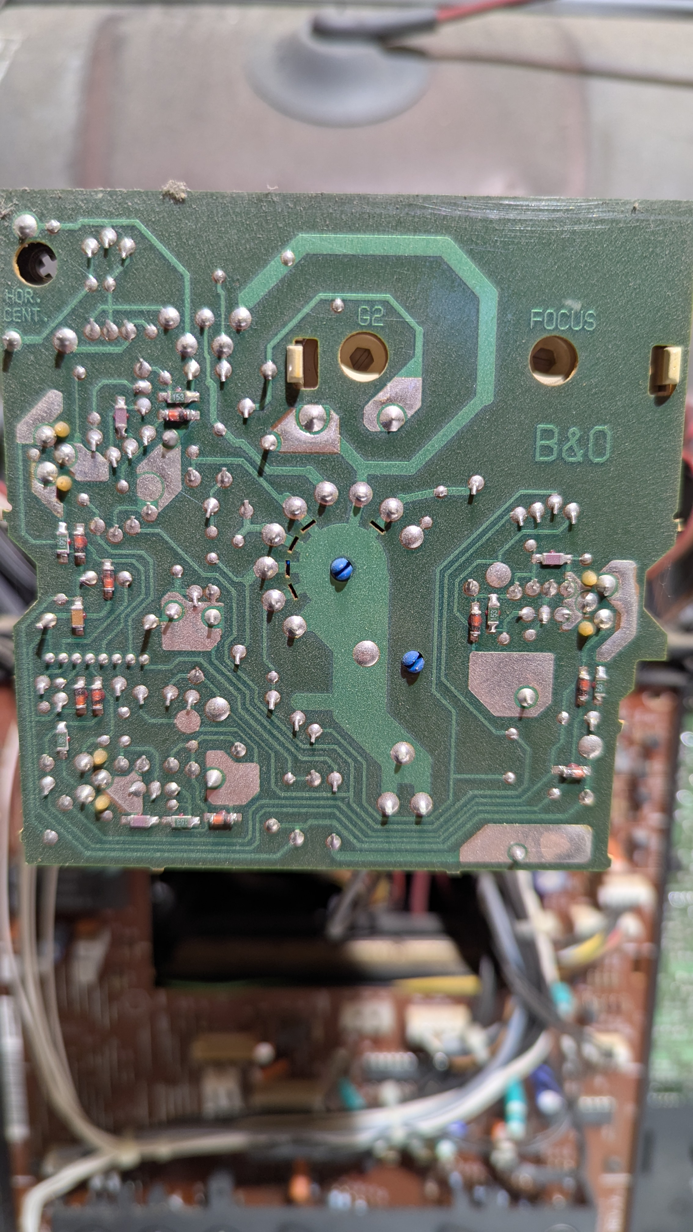

    Do you remember which of the joints it was for you. Also do you see anything bad here? They look good to me, but yeah maybe worth resolder all. Do I need to discharge it before I do that? Sorry total novice here.

    David Heaton
    I seem to remember it was TR2 on the neckboard, but definitely worth reflowing everything on there as a belt and braces job 🙂

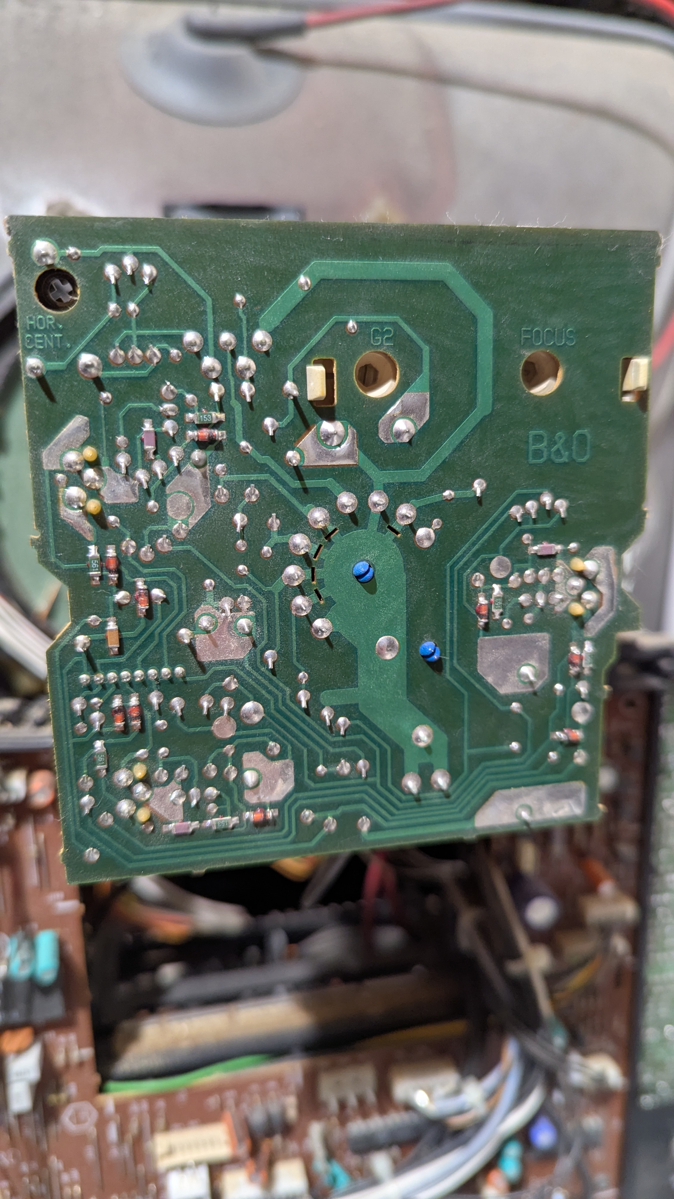

    Also, the only joint that looks a bit weird is this one, but it’s difficult to tell from photos really. Best idea is to give everything a wobble and see if anything moves. The way I discovered where my fault was, was by prodding areas on the neckboard with a chopstick while the set was running!

    Thanks for the helpful tips! I will try your method by poking with chopsticks. Any good advice for discharge before resoldering? Also, do I need to remove the neckboard to resolder or can I keep it as it is when I resolder?
    Update: nothing moved or changed while poking the parts and soldering. But it must be something wrong with my TR2 as well as my flickering is green. Either dry joints or the transistor is about to die, is my best guess. I will resolder on Friday with the help of a friend. I’ll let you know if it worked. Thank you so far!
