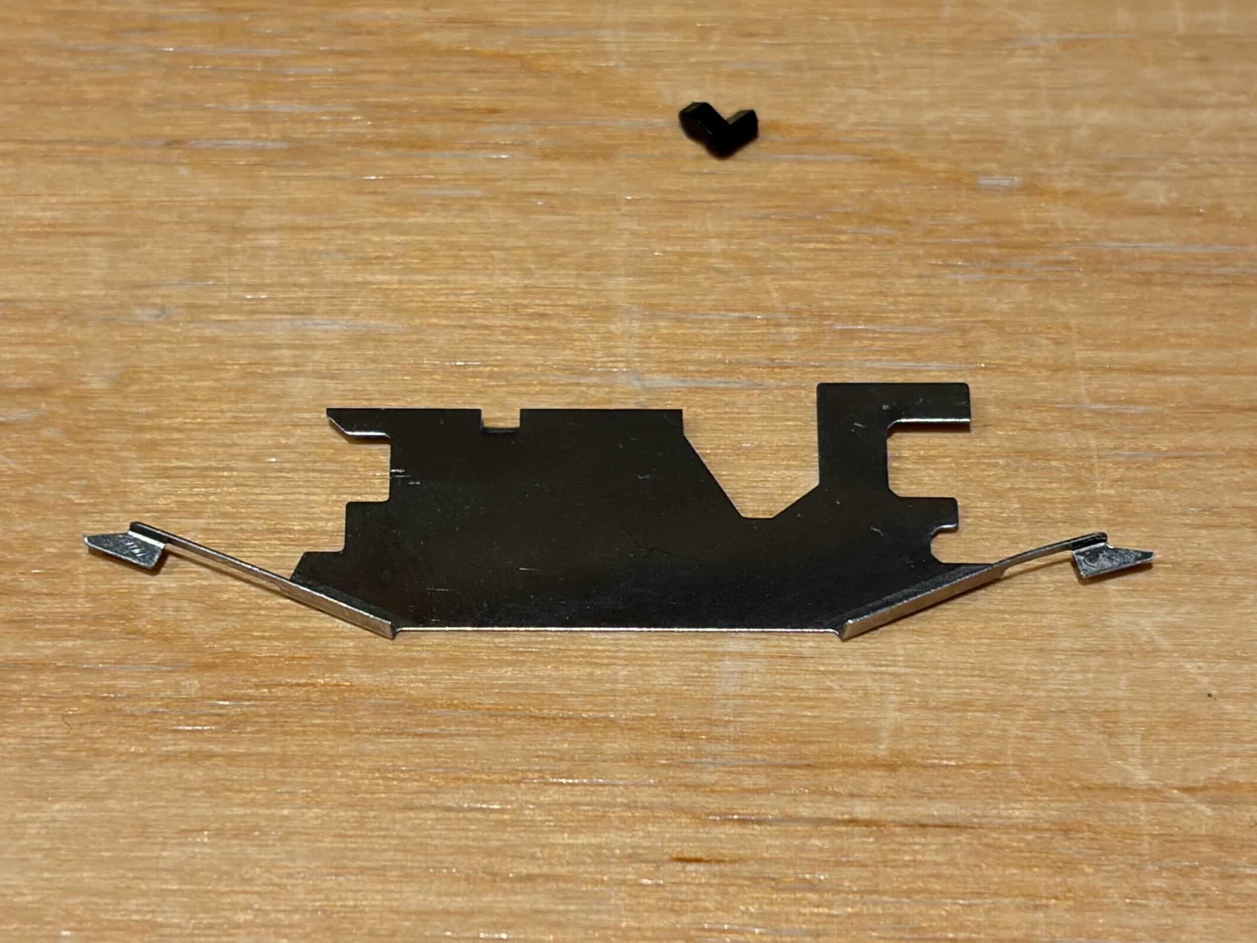

    Well, good news…. found the issue.
    It was the tape head spring assembly that was not lying flat and was obstructing the tape head assembly from fully engaging…
    This was the culprit:
    I can lock it in on the left side, but it would not stay in place on the right side and just pops out on first use. Not sure if the small piece of plastic is to blame or not.
    There was also a tiny ball bearing which sits behind this spring, but I turned my back on it and its just gone now.
    Googled a few images of the Ouverture tape mech and looks like half of them were missing this entirely – so I simply removed it and rebuilt everything once again.
    So now I have a fully functional tape mech and only a few parts left over…
