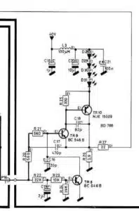

BRONZE MemberThanks for guidance to this diodes. On Beomaster 7000 it’s 9C20 – 10uf capacitor on the same position like your 5C110. In service manual for 7000 this capacitor is grounded to “signal ground” and maybe this is the case here. I think maybe first to try just to disconnect the minus leed of the capacitor and will try to grounded on the other ground piont with a short wire to see what will be the result. What do you think?

BRONZE MemberYes it is absolutely the same buzzing, like You describe it. I also think it’s something with information needed for the display, because when I click on for example volume up first hear a “buzzz”, after a second or two in exact same moment of display changing I can hear buzz-buzz.

BRONZE MemberThanks for the reply Guy, but unfortunately mine is with CDM12 ( new version) and I don’t have pcb 8. I have pcb89, which is on the place of pcb8, but very different schematic. I have all of the service manuals. On that pcb89, I’ve checked the transistors, voltages and cable slots for connectivity. Everything looks fine. I will attach a photo of that board in case you want to see it. Also i will add a photo of the laser to tell me if this kind of light is normal.
