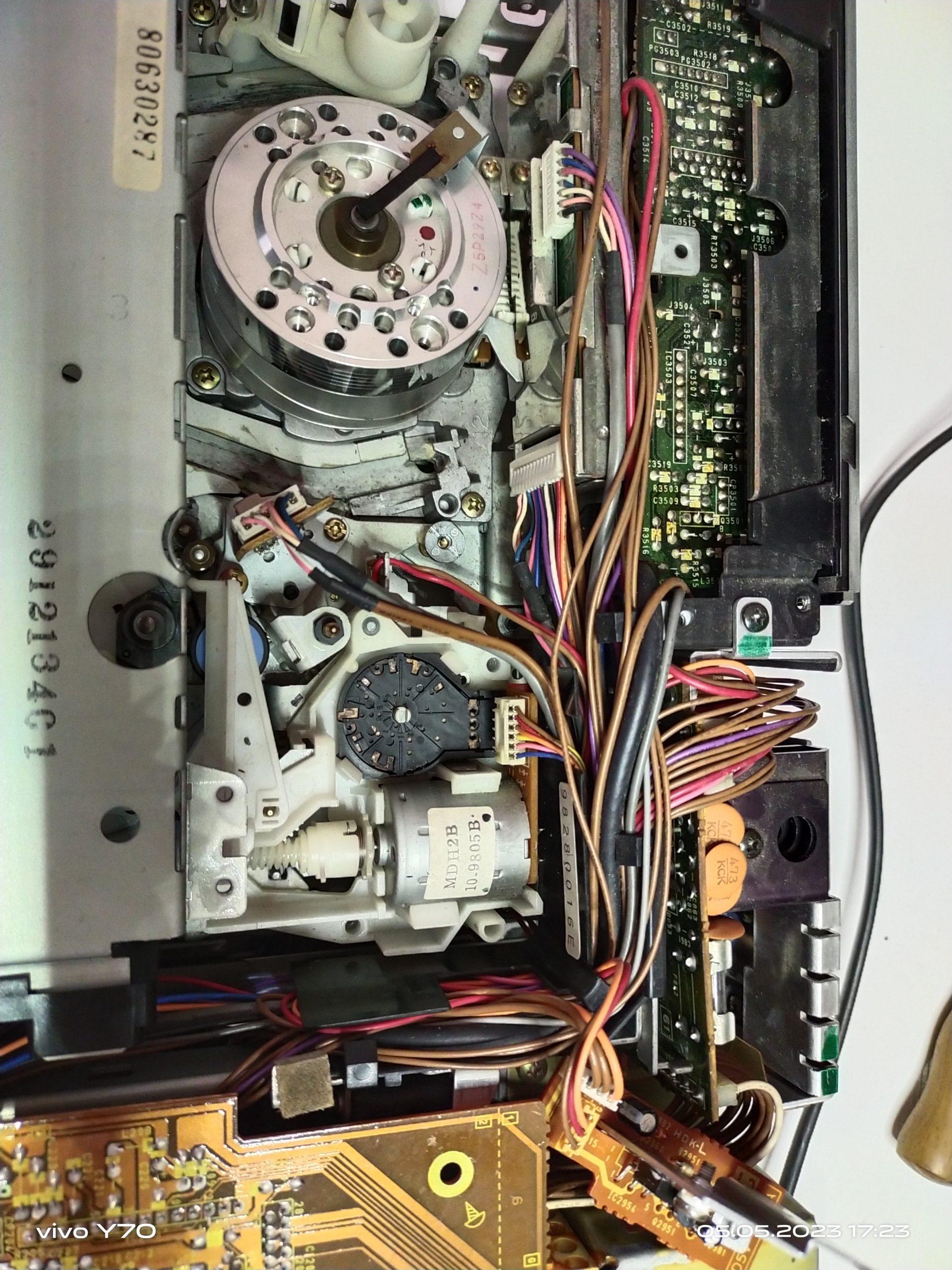

    in reply to: Beocord vx5000 #46413
    gpv
    changed capacitors but the problem remains.
    I inserted the cassette manually then I powered the motor and the tape was loaded so the mechanism works.
    the problem is that there is no consent to start when I insert the cassette but I don’t understand why.
    What house is it that starts it all?IMG_20230505_172329-scaled

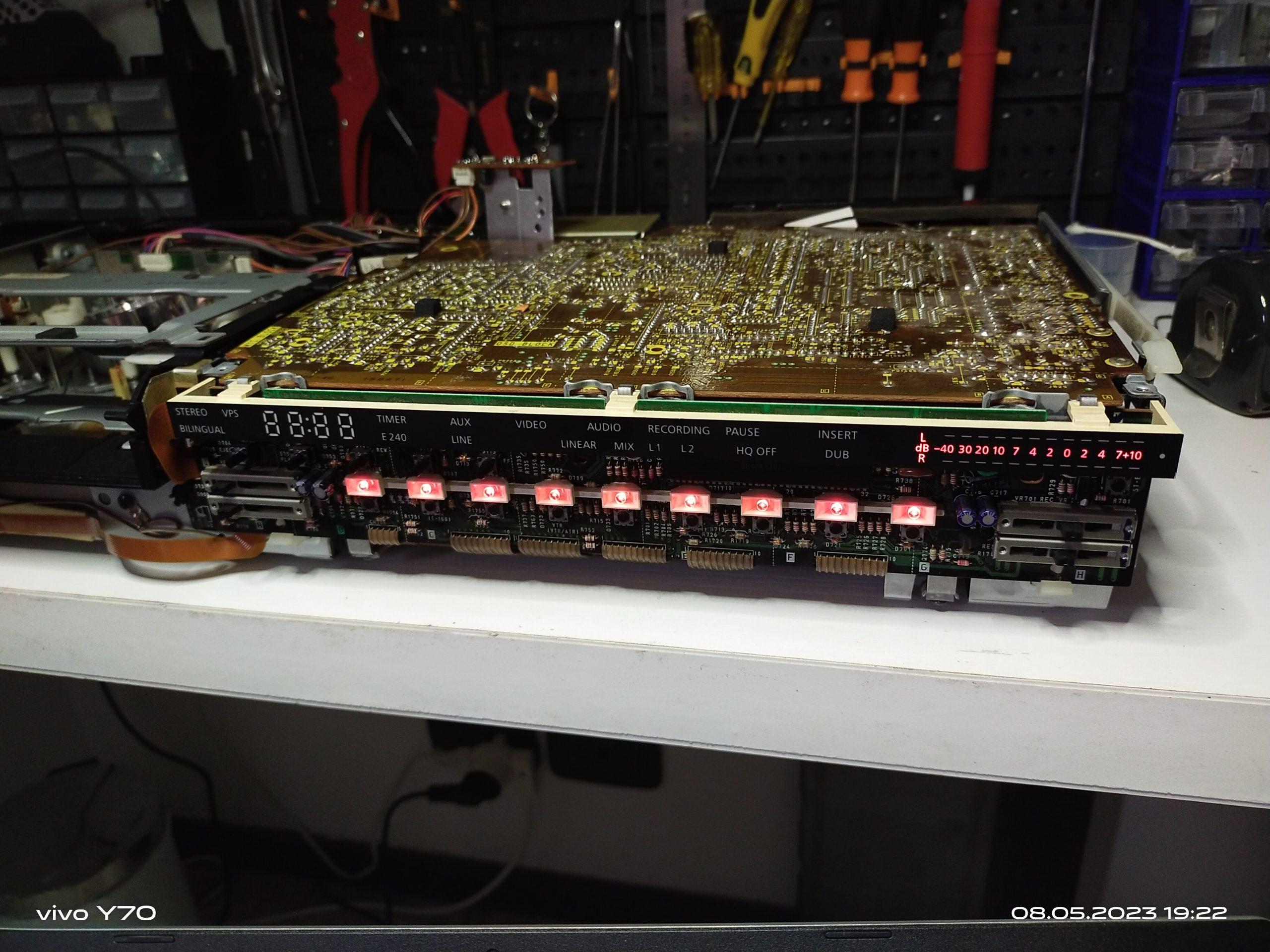

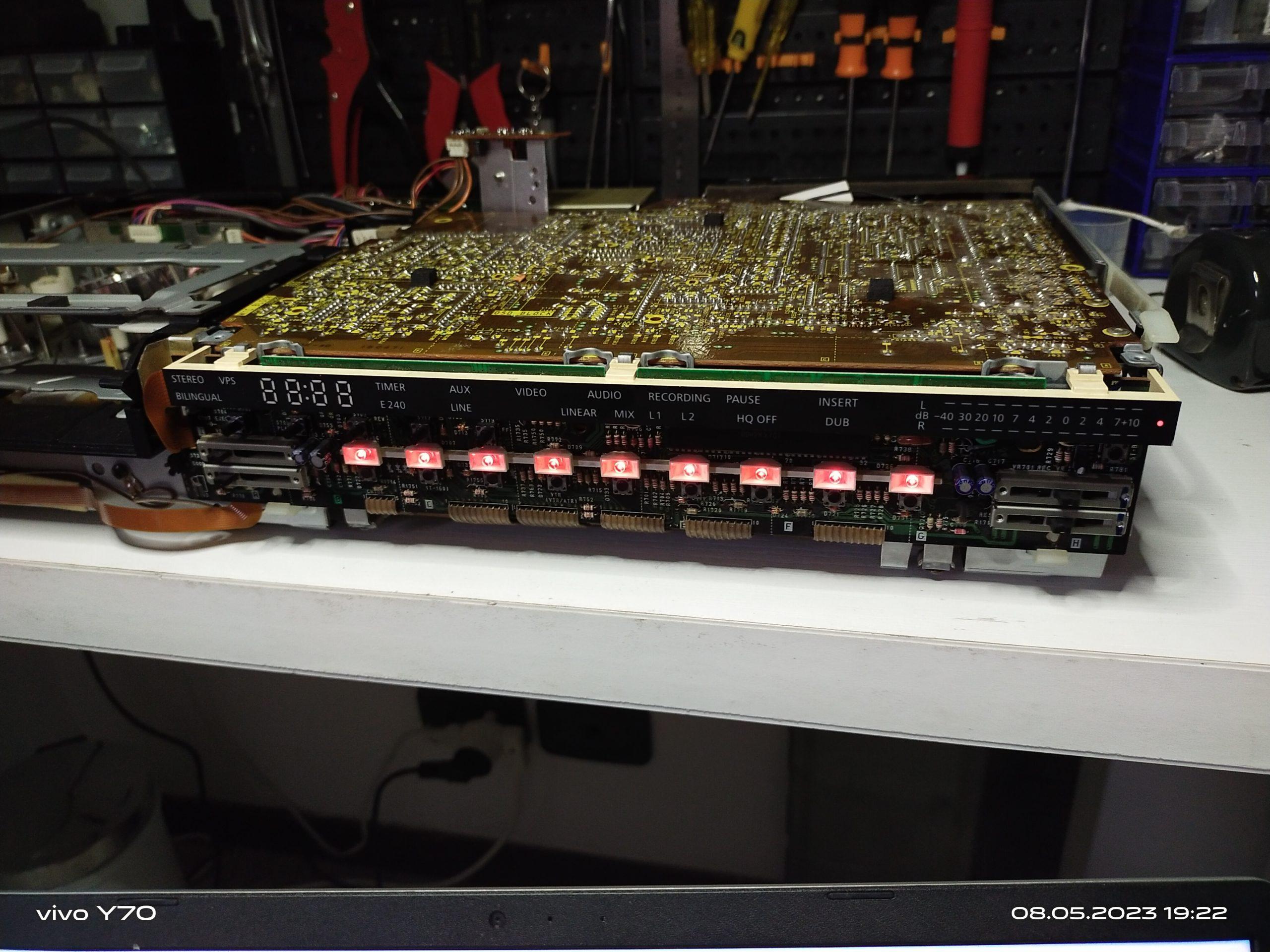

    gpv
    ok anyway I took the battery apart and checked it was charged. Yes, no leaks, capacitors look like new. Practically when I turn it on you feel it straining under the belt, for a few seconds you see the stereo LED bar then it turns off. The head cylinder does not turn when doing the testIMG_20230508_192208-scaled
