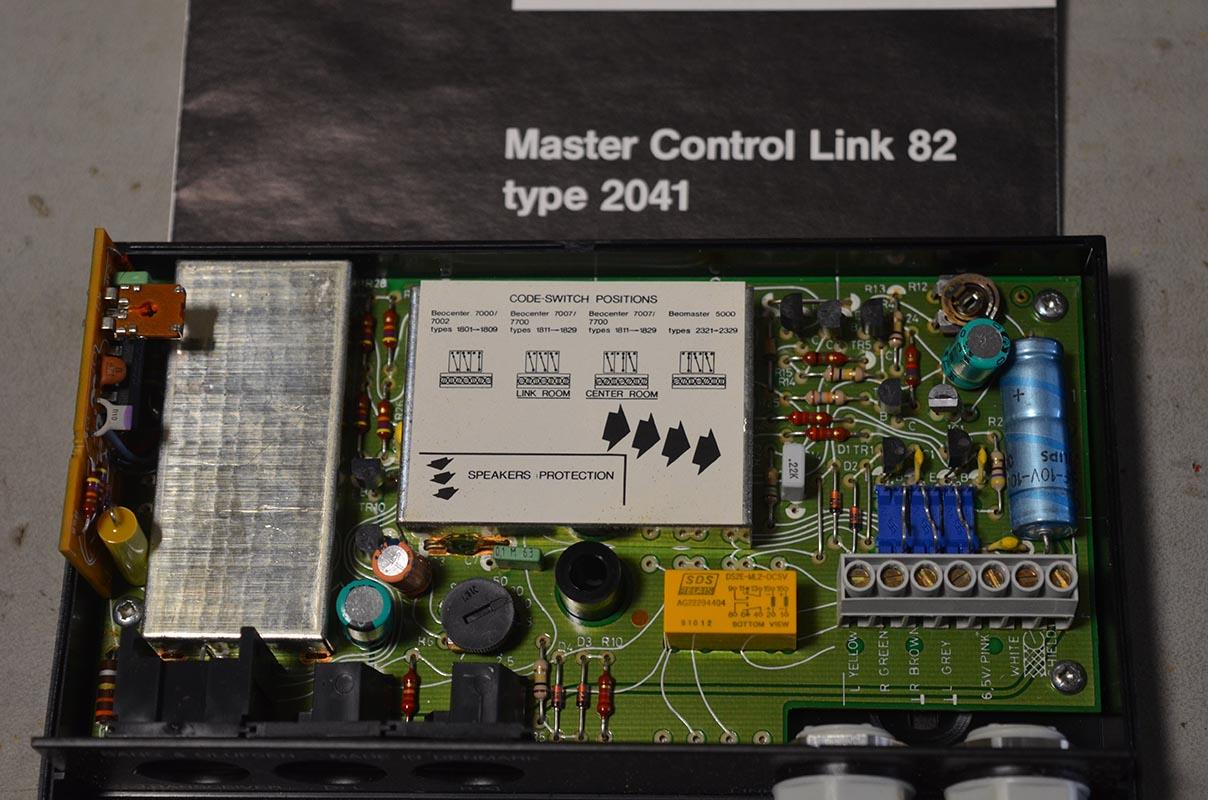

BRONZE MemberThanks for the explanations. They make sense to me.
I think it is actually a 2.5mm jack and probably only with two pins (I will look further into that). I do no have that much knowledge about IR emitters, if they have to be for a certain frequency. The Code converter manual mentions a cable with mini plug and a blue LED.
I would expect that certain IR wavelengths would make it easier for the receiver to pick up the signal. At point blank range, there is likely enough “bleed through” or overlap for not perfectly matched parts to still work. I recall reading the B&O had issues with sunlight falsely triggering some systems and having to all physical light filters. I don’t remember what systems were affected, but removing any filters for testing might help. The blue LED comment doesn’t make sense to me since this is at the wrong end of the light spectrum. Unless blue was used as a indicator for a human to see the activity without interfering with the IR.
The MCL Beolab Kit is used to get data control signals from MCL82 or MCL30 link rooms into a BM8000 or BM6000 as none of them have the MCL data connection.
I’m glad to see your picture of the MCL Beolab Kit. I’ve read about it but have never seen one for sale. Maybe the lack of labeling on the box is a factor in this. People might not have a clue what the box is and just toss them out of frustration. Maybe I need to expand my eBay searches to include “unmarked B&O black box”. 😉
I’ve also wondered if it would be possible to bypass the IR stages and hack the MCL signal directly into a BM8000/6000, possibly on the REMOTE pin of the CPU.
Just did a wire up of a MCL82 box with IR tranceiver and the MCL-Beolab kit.
Interesting test. Have you considered hooking up a oscilloscope and comparing any of the signals to the code tables in the service manuals?
I do not have anymore ideas for testing it right now as I do not have any of the other remote types and/or music systems for this to work with. I still have it wired up so can try to test something if you have any ideas
I’m in a similar situation with having some, but not all that is needed to run a good test.
I think that I’m getting motivated enough to buy a Beomaster 5000 and MCP5000 for test purposes. It wouldn’t be the first time I’ve done something like this where the tail is wagging the dog. My Beosystem 5500 stack started with a MCP5500 that was tossed in (for free) in a equipment bundle. The funny thing is that after completing the stack, the original MCP5500 was swapped out for one in better cosmetic condition. Yes, it is a sickness.

BRONZE MemberI hope that I’m not hijacking your thread. If so, I’ll “cease and desist” and maybe start a new thread.
I was vaguely aware of the ability of using the MCL82-2041 with the Beomaster 8000, and also the Beomaster 6000 of the same era. The functionality gained for these additional devices seems minimal. My (likely incomplete) understanding is that it just supports a subset of the remote commands that are relayed via a IR->wired->IR chain. The documentation that I’ve found isn’t exactly clear and concise. I’ve found this old thread, https://archivedforum2.beoworld.org/forums/p/14327/126573.aspx which answers some questions.
And now it gets interesting. The next box is also without markings, but I have a feeling it could be a MCL-Beolab kit type 1006/1007 for control of Beomaster 6000 and 8000 with MCL30 and MCL82. I hope someone can verifiy if that is correct? The IR eye is missing.
It looks like the port for the “IR eye” is a simple 3.5mm jack. If so, do you think that a generic IR emitter would work? It seems possible if all it needs to do is pass IR commands into the BM8000.
Could the box be the “code converter” mentioned in the old thread?
