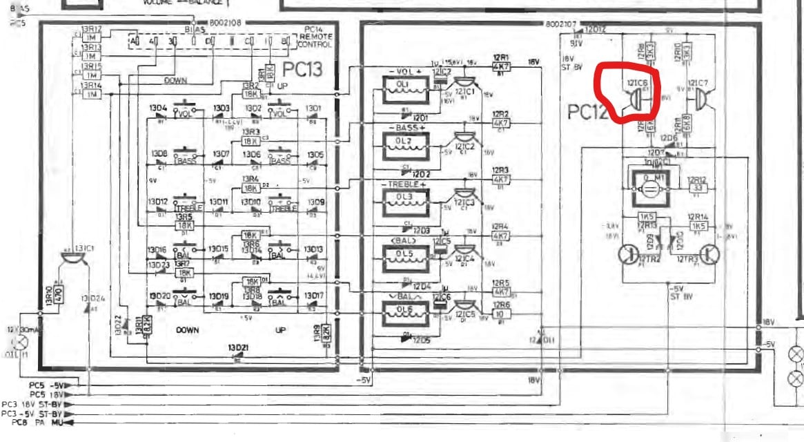

dahiyas
BRONZE MemberI did get some time to work on the unit. 12IC6 was the issue. replaced with BC516 and the UP buttons also work. So UP/DOWN buttons work. I did notice that the UP speed was slower as compared to DOWN – 12R12 was measured at 78ohm instead of 33ohm. Replaced that and all is good.

dahiyas
BRONZE MemberThe 5v line on was going down to 3.2V. Checked the components in path of UP circuit. The culprit was 12IC6 (SPS5431). The alternatives listed are MPSA65 and BC516. I don’t have any of those handy. Will check with local shops tomorrow. Hopefully that will fix the problem.
Next – FM issue now. Any suggestions ?
