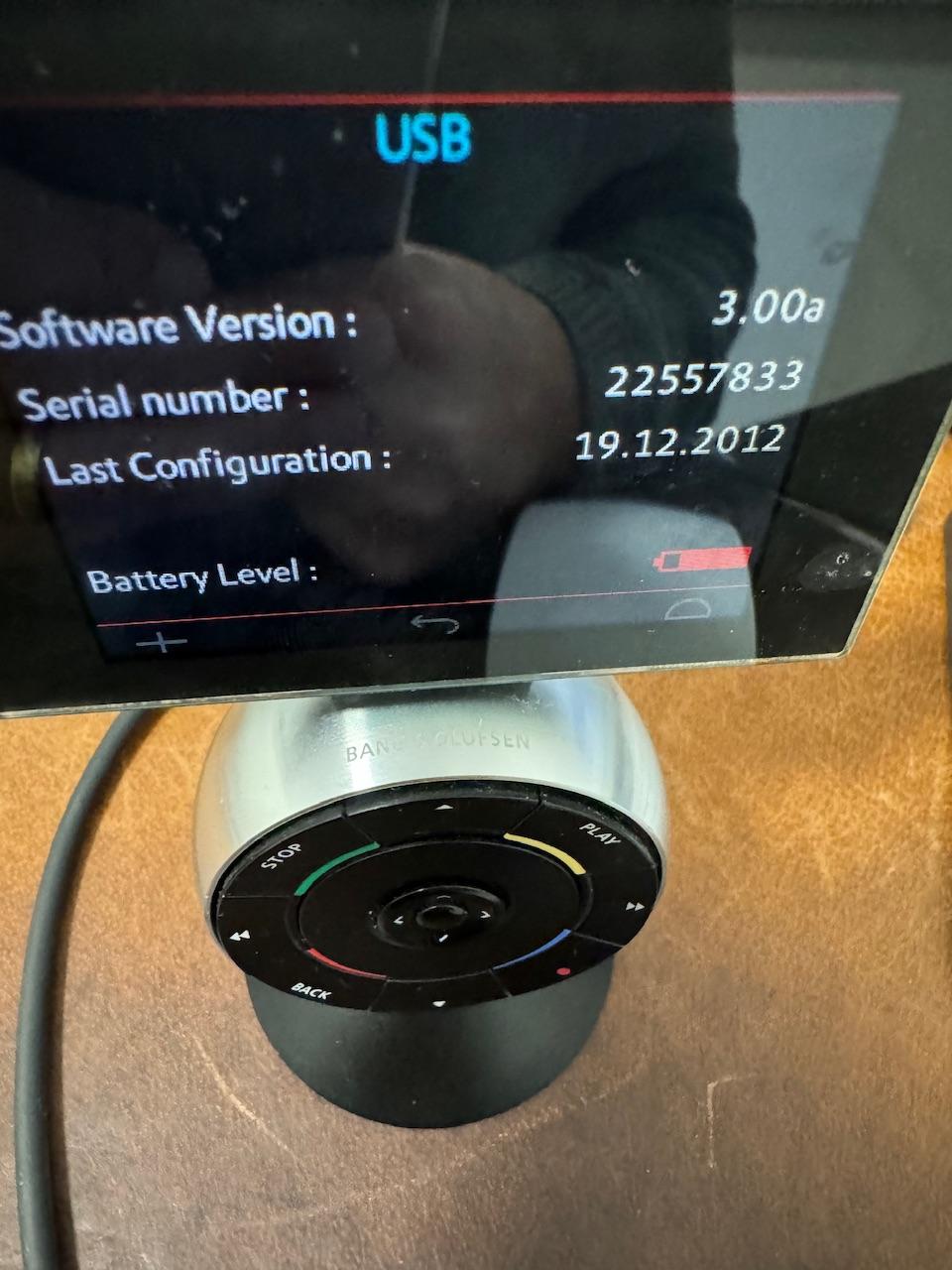

    boarcastle
    I really managed to install a VM Windows 11 on my Mac and install the configuration tool there. ?
    so far so good. Now I need to learn how I can program my Beo 6 with this software.
    I have version 3.00a on the beo 6.
    I have tried it using default mode, but it doesn’t really work.
    I keep you updated on my progress. So far it is a steep learning curve for me. ?
