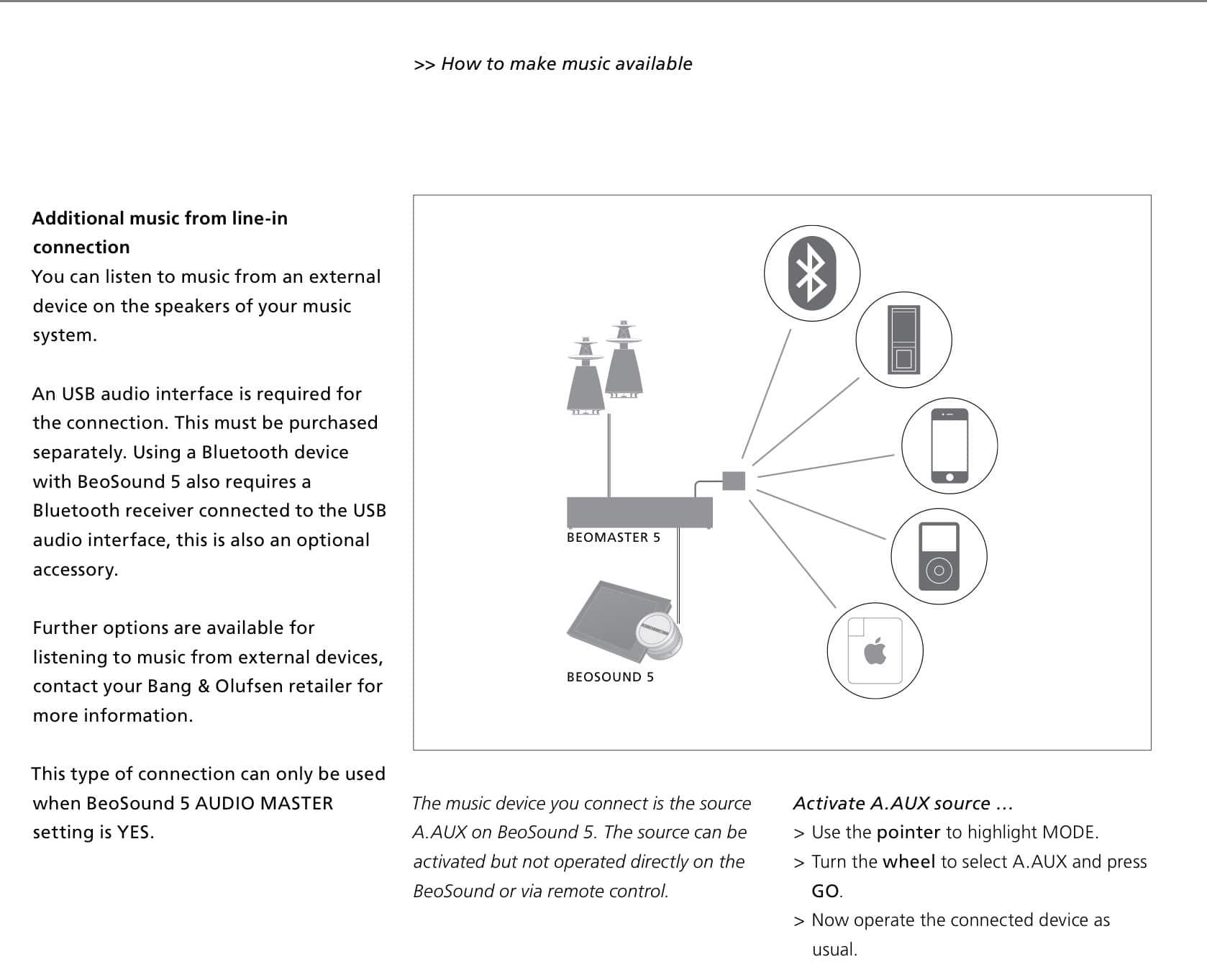

BRONZE MemberThis is how it is described in the User Guide
…and that is how I have done it several times (most people want a turntable connected).Plug in the Behringer to the USB of the Master 5 – connect L/R of your choosen device (the WiiM)…..Why go for the WiiM Ultra, why not just the cheaper WiiM Pro??That will offer you all that you need….and in addition AirPlay 2 (if you need that).As you probably already know…you can easily order the WiiM device via Amazon and send it back, if you don’t like how it works.
