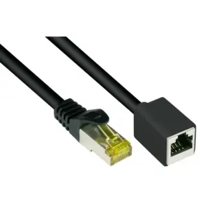

    Could these be an option for you:
    they will save you a ‘mechanical’ connection in the signal path.
    Regards, Johan

    thanks for your reply, will search for those, sounds good.
