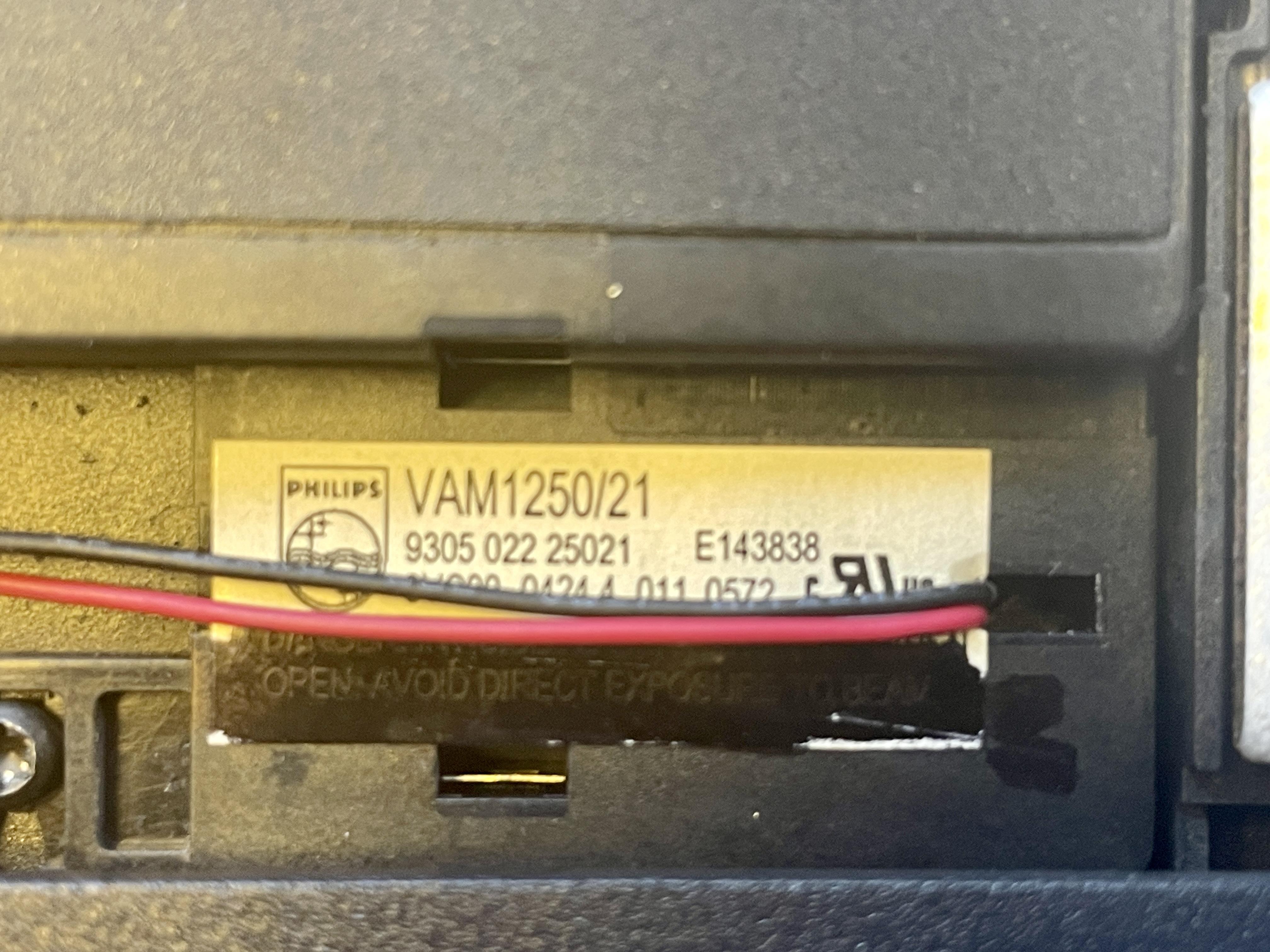

    KolfMAKER
    Working on replacing the broken laser unit for the BeoSound 9000 MK3, I found out it needs a VAM1250/21 (see picture).
    • I have tried at DKSoundParts and Gerner Electronics, but no success.
    • On AliExpress I see many available, but I don’t know about reliability.
    • On Dönberg Electronics (Ireland) I found a VAM1250, but they are unsure if their VAM1250 is different from the VAM1250/21.
    Question
    1. Who knows a reliable source to find and buy one?
    2. Is the addition ‘/21’ in 1250/21 important, or should a VAM1250 work?

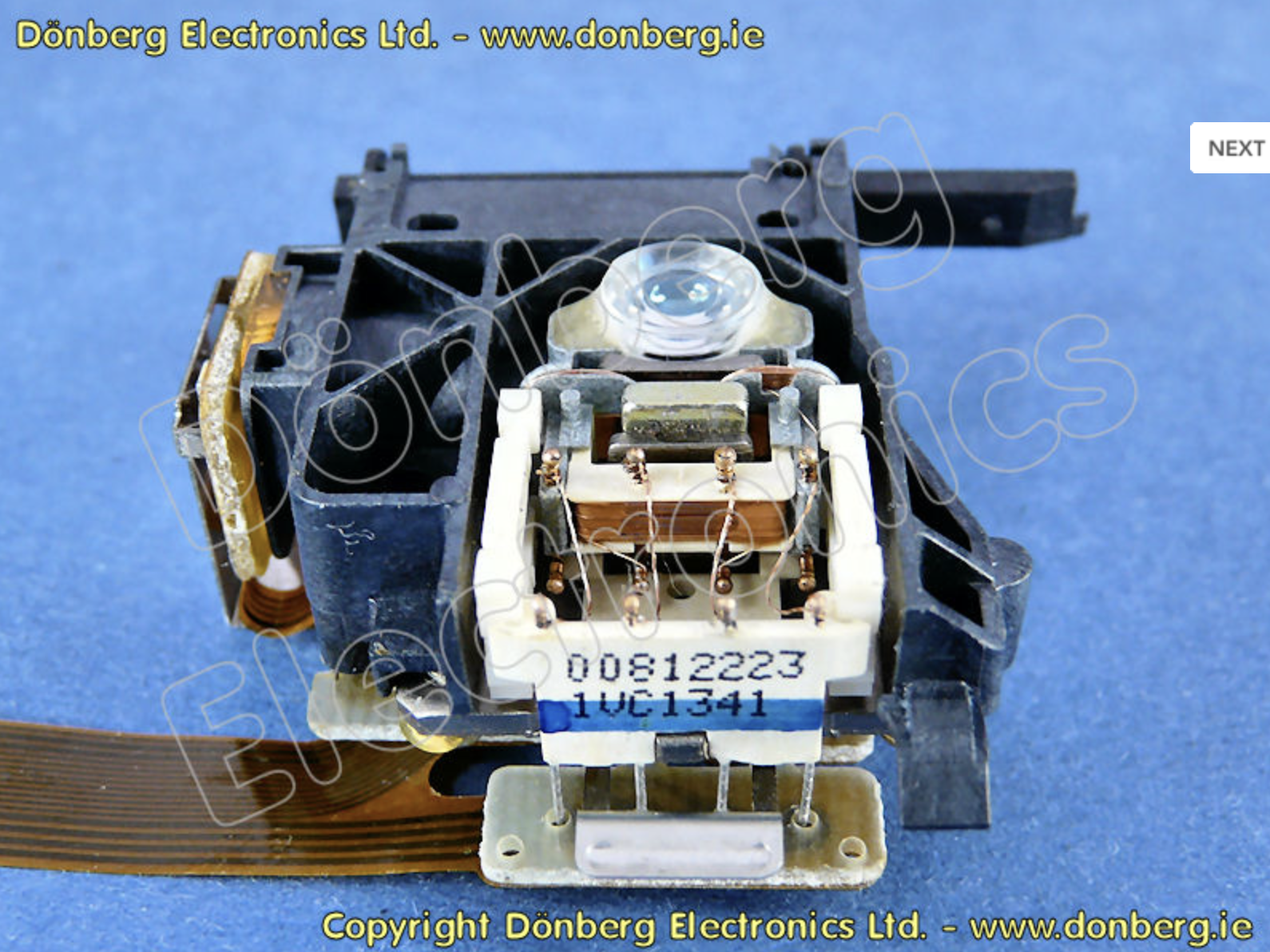

    #64435
    KolfMAKER
    In the meantime I did find a VAM1250 at Dõnberg Electronics in Ireland:
    https://www.donberg.co.uk/catalogue/vam_1250.html
    But it doesn’t have the addition ‘/21’. So, I am not sure if this is the right one (Dönberg also doesn’t know if it will work.
    Question
    1. Does anyone know if this VAM1250 will work in the BeoSound 9000 MK3?
    2. Are there any other laser units that are compatible with the VAM1250/21?
    The VAM1250 at Dönberg Electronics:
    Location: The Netherlands

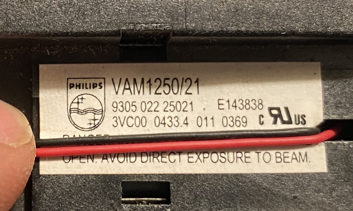

    Hello, I have a mk2 and the sticker shows the same exact reference. Can it really be the same laser pickup, as my version is a mk2? Will follow the progress if the unit you have is worlking for you, and if you can give us the reference to find it would be useful. Thanks a lot!

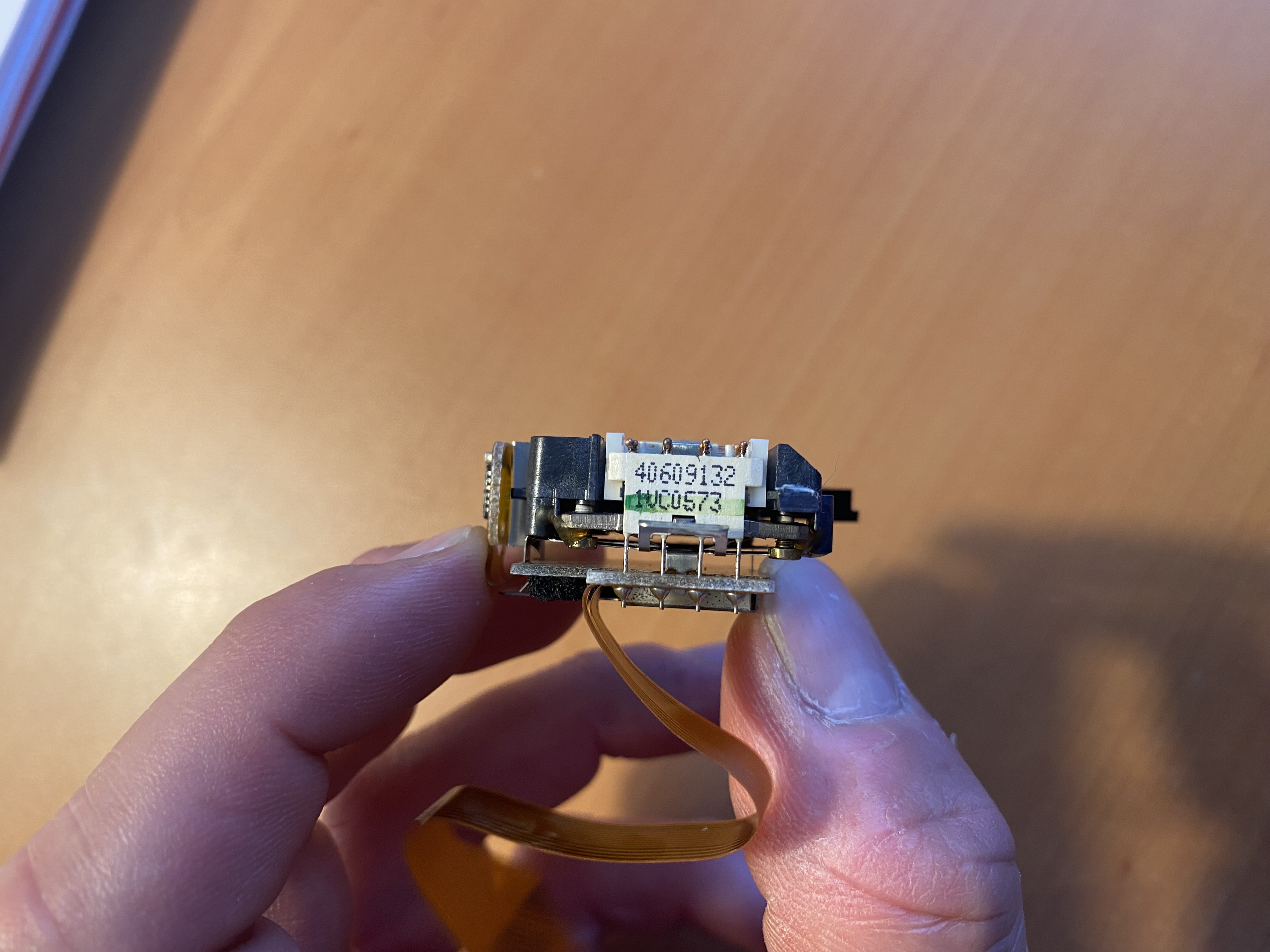

    #64929
    Igor Jané
    Hello, yes here you have a picture of the sticker and the pickup of my mk2. Regards.
    #64933
    KolfMAKER
    Thanks for adding the picture. It confirms that your laser unit (in the MK2) is exactly the same, as mine (in a MK3).

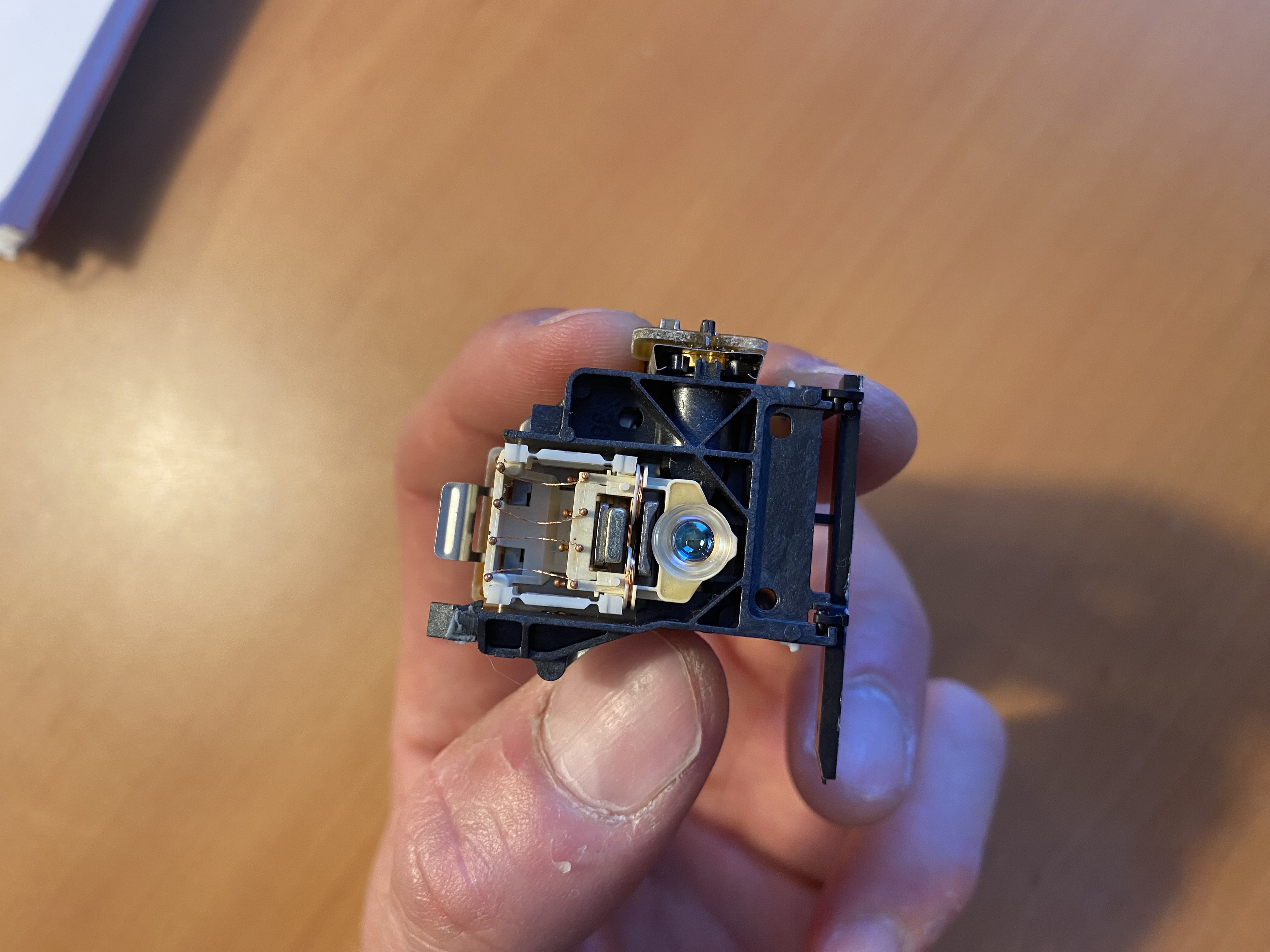

    #65037

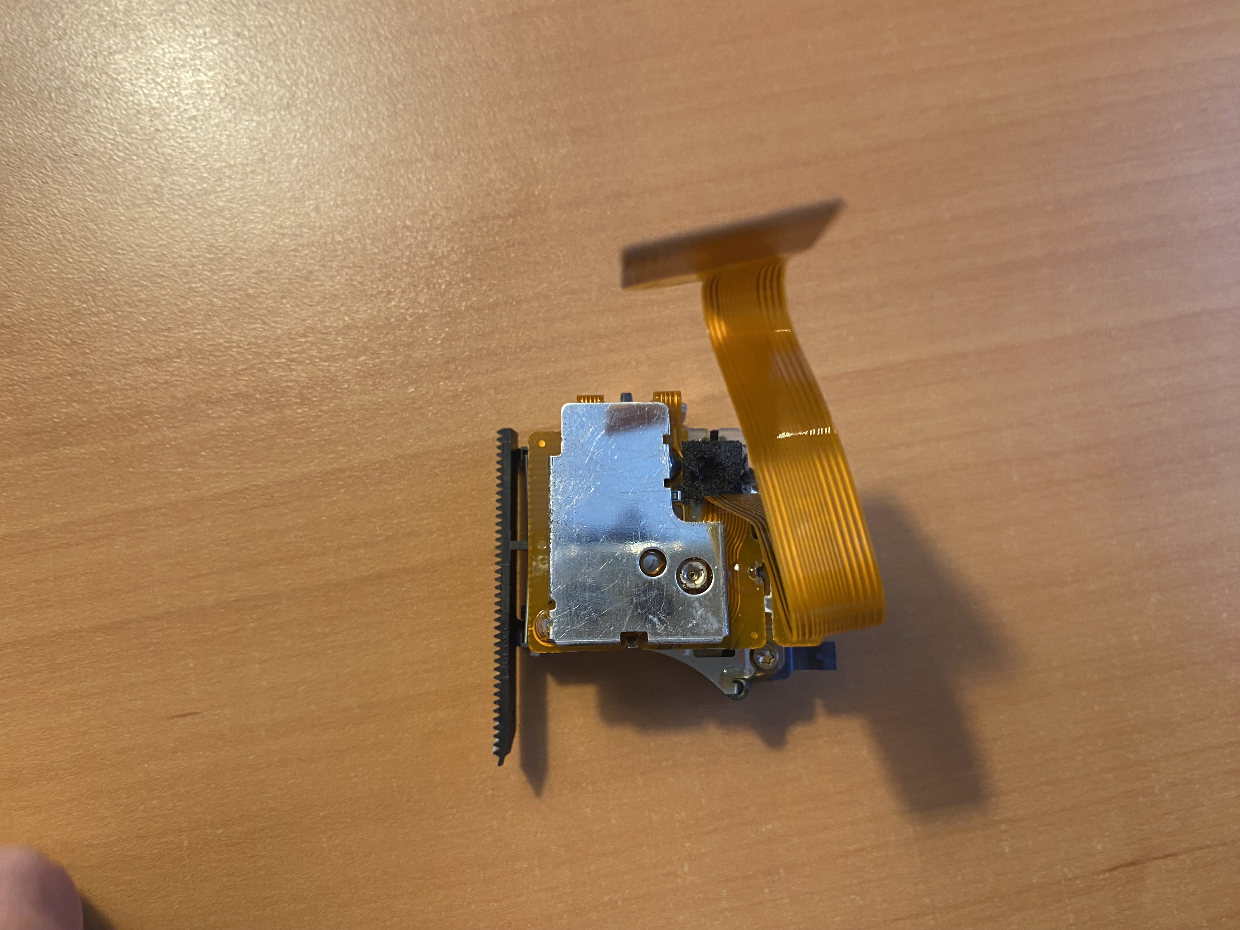

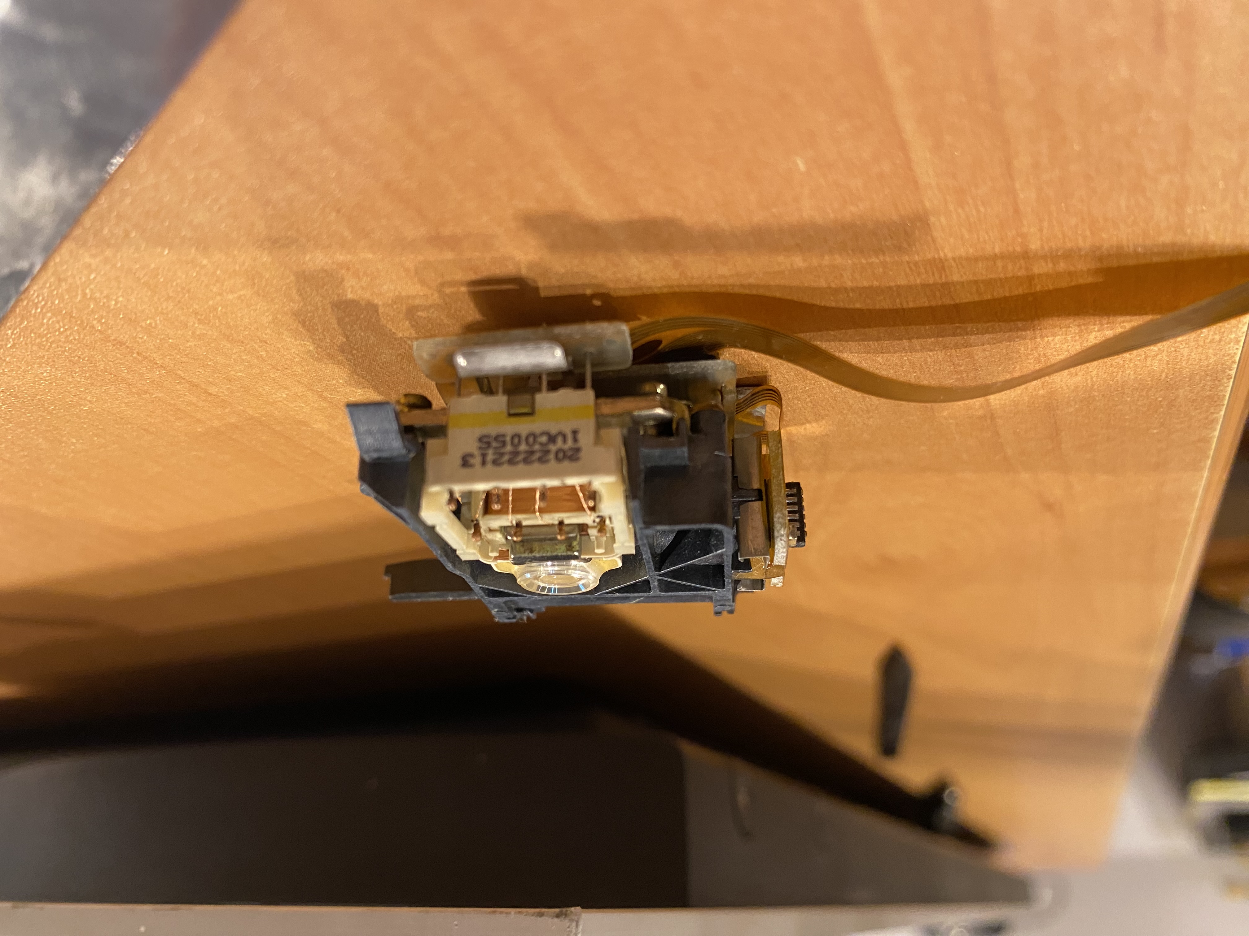

    Igor Jané
    Hello everyone! Bad news I tried a unit from ebay, the seller recommended it after I sent him pictures and reference of my pickup (attached picture of the pickup I received), he told me my pickup is a VAU 1254 on a VAM 1250, finally I’ve received it today and installed it very carefully and it does not work on my unit…,  is not even capable of read any disc, doesn’t even start spinning because the pickup is not working properly (I installed mine back and still reads some cds like it did before).. I don’t feel like testing from more sources because many look and have similar references….  please @kolfmaker do you think I can ask Keith Saunders to provide one for me? The one you bought from him worked properly? Thanks again in advance!!
    igor
    #65041
    KolfMAKER
    Very sorry to hear the VAM1254 does not work.
    Though, even if they look almost the same, they are not. I read a lot of info about OPU’s. The VAM1250/21 that you need belongs to the ‘CDM-12 Pro’ family of OPU’s. Others are: VAM1204, VAM1205, VAM1206, VAM1252 and VAM1254. They all share comparable specifications, which also means there are differences. Unfortunately, you just found out about that.
    The OPU you have in your BeoSound is a VAM1250/21, like I had. I was lucky to find one with the help of Keith Saunders. Although it is a VAM1250 (not /21), I know this one works.
    You can try to contact Keith, but if I remember weel, he sent his last unit to me.
    I made a quick check on eBay and found this one: https://www.ebay.com/itm/363230316872
    It is a VAM1250, but I don’t know how reliable the advertisement/advertiser is. Maybe you can try to contact them.
