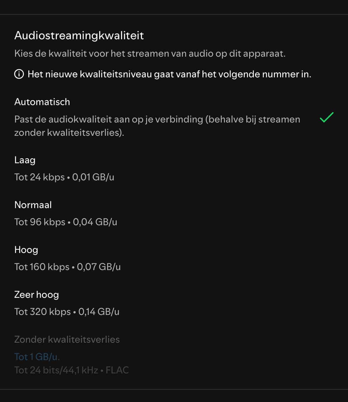

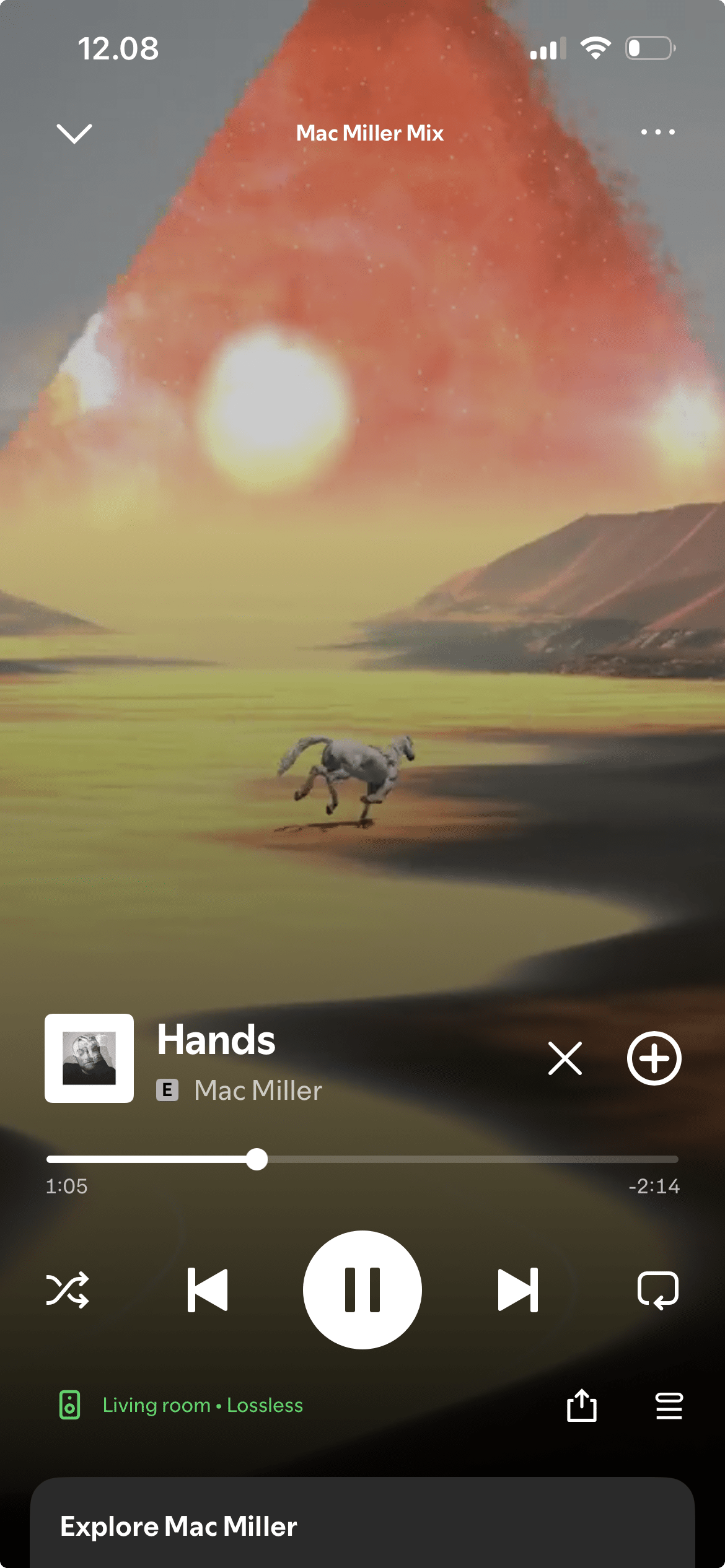

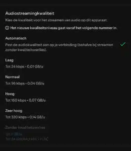

    It works fine for me. Tested it on Theatre, Beolab 28 & 8 and a Balance.
    I did have to force the Lossless setting to every Spotify Connect device manually before it worked.
    I’ve added screenshots how I did this in Spotify. Just click on the items I’ve marked with a red line and you’ll get into the right settings menu. I had to do this for every device. And a extra screenshot from the Signal info of Theatre confirming the incoming lossless signal. Multiroom also worked fine.

    These days Spotify are slowly rolling out Spotify Hifi for its Premium users. Without any user interaction, the automatically selected quality will remain lossy 16/44 320kbit oggvorbis.
    Mozart Platform-based speakers are already prepared for Spotify Hifi. However, due to the way Spotify has implemented their Hifi option, Lossless needs to be enabled on each individual Spotify Connect device/speaker, not just on the phone.
    To get Spotify Lossless working on Mozart:
    1. Start a song in Spotify and play it on the speaker using Spotify Connect.
    2. After the song has started on the speaker, go to Settings > Media Quality in the Spotify app. Change from Automatic to Lossless and confirm.
    3. Switch to another song to activate the change.
    4. Repeat for every individual Mozart speaker that should support lossless.
