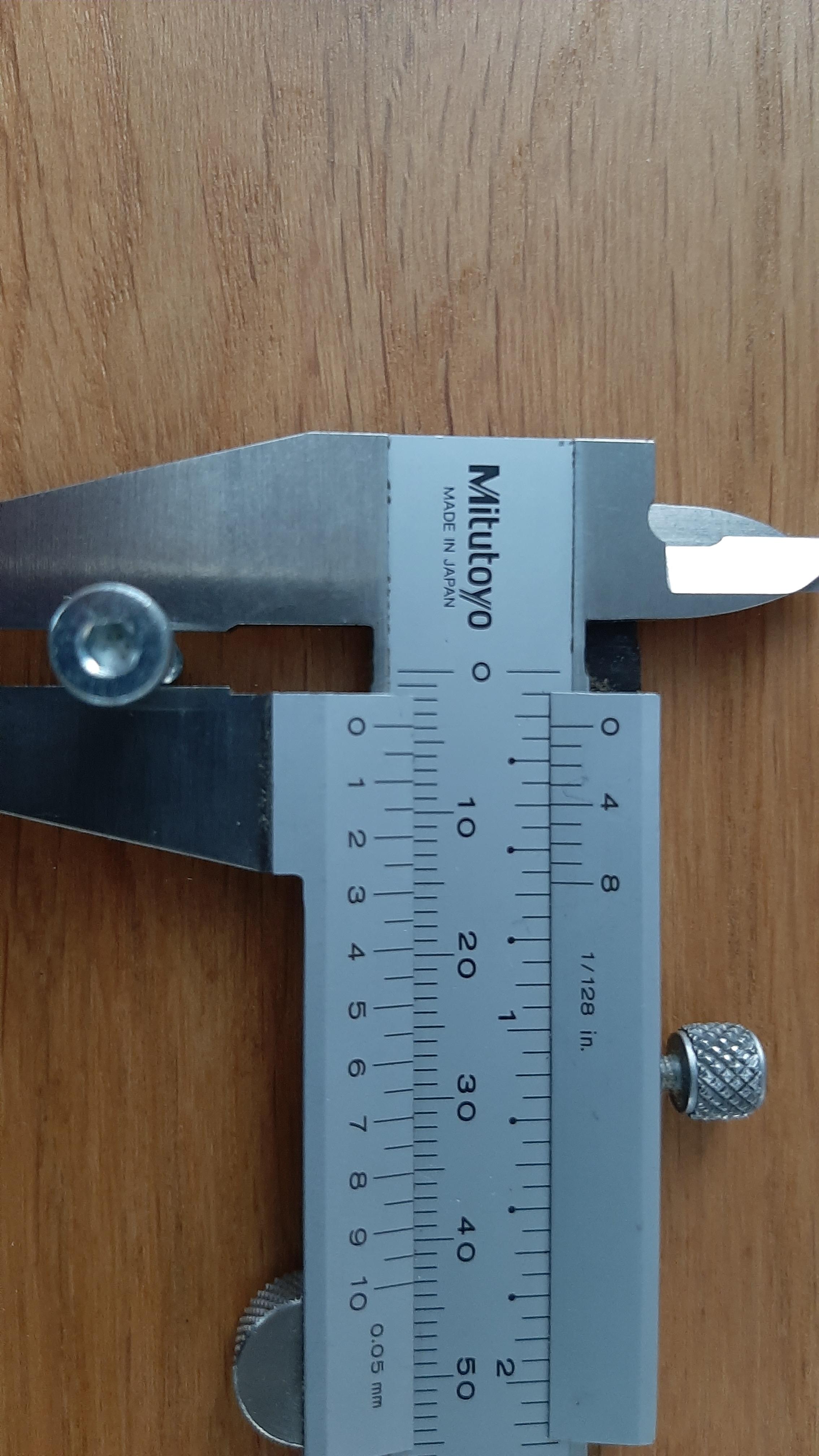

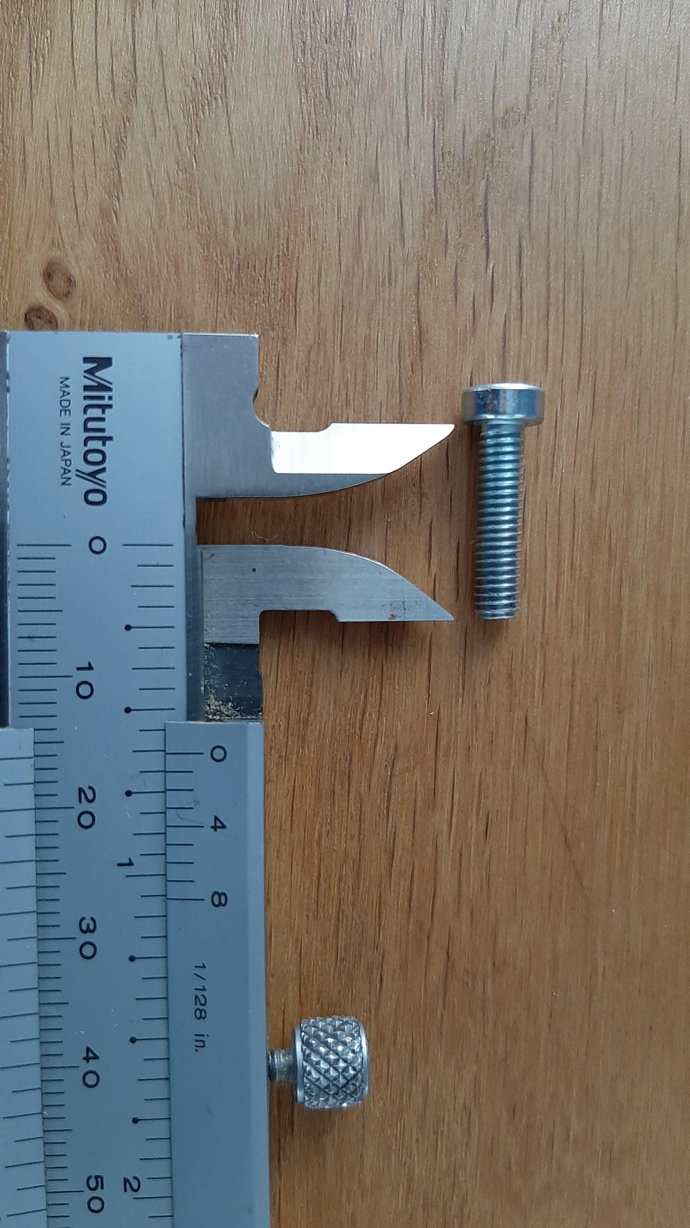

26 September 2022 at 10:43 #39297 TignumGOLD MemberHi Matt, welcome!
The service manual says 4×16 (for pos. 15):
and that is correct: M4 x 16mm, with a 7mm head.
I need to clean my caliper :-).
Good luck! Johan
