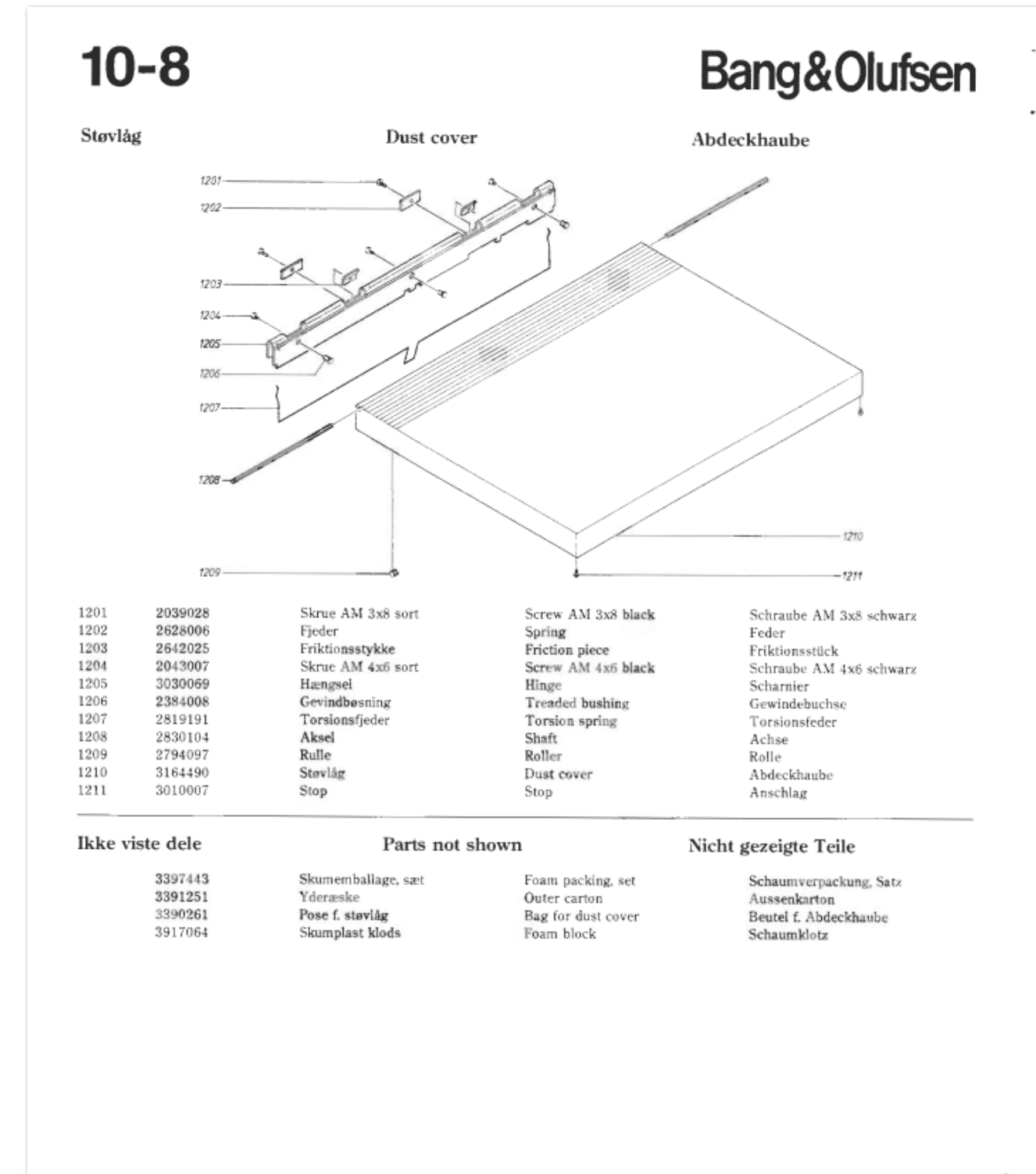

    I had some problems with the adjustment of the turntable, so I took the dustcover off…
    Now I am having problems putting it back on. Wished I had not taken it off…
    Can anyone tell me how the two brackets 1203 must be placed? Over or under 1207 the metal spring? Tried several but when I put them under I cannot get the cover back in place.
    I think it should fit in the holes but unfortunately that is not enough. Tried chatgpt but not helpful enough.
    Been busy all day with this.
    A drawing would be great….

    I have an RX2 and will look at it this weekend. I will make a picture of the mounting, if this helps?

    here are some older threads dealing with the topic, maybe this helps: RX2 DC_1, RX2 DC_2.
    My pics:
