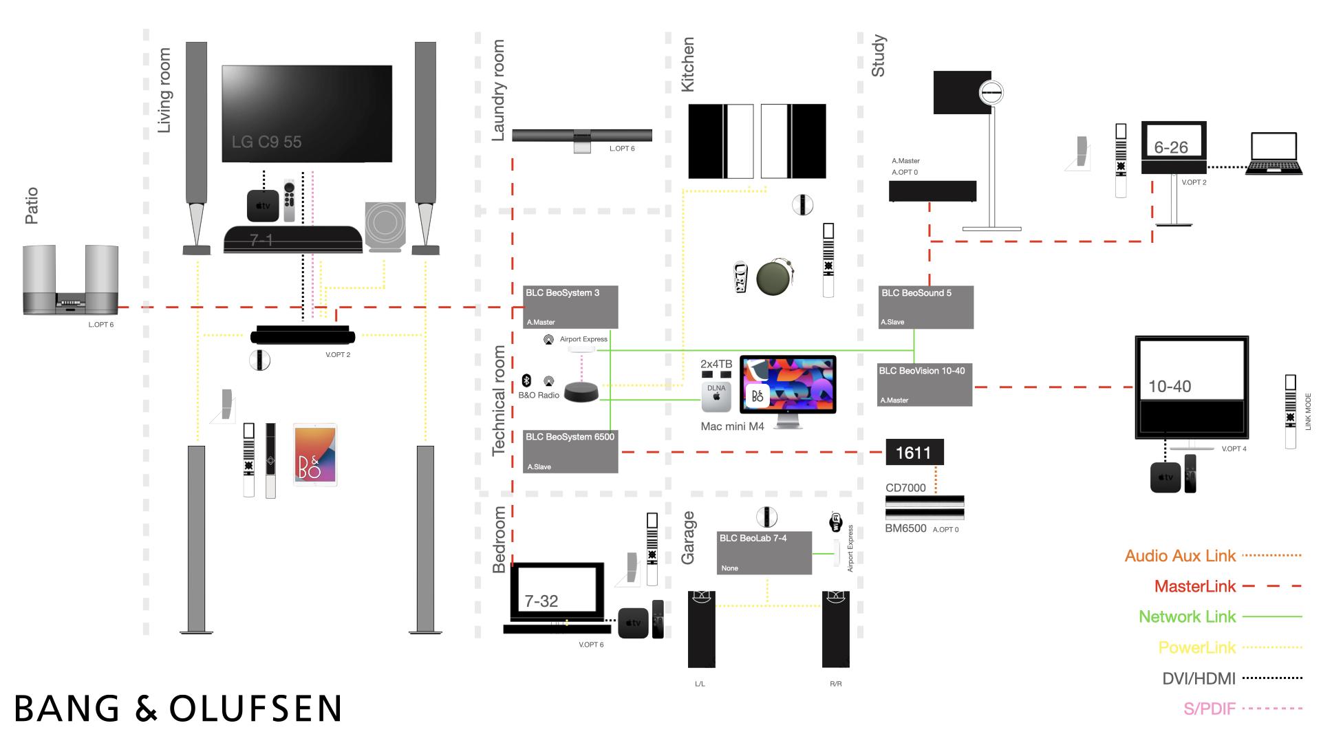

    I like to be able to listen to the Radio BS9000 SW2.2 located in the living room, on my BV10.40 located in the bedroom
    Can I add a second ML/NL converter in the bedroom, instead of installing a ML cable? (one is already installed in the NW room)
    The wireless ML is not working very well…
    Or must I upgrade to a BV11?
    Thanks // Håkan
    #62861
    Tignum
    GOLD Member
    Hello Håkan,
    That should work fine. See my setup where I also linked a BV10 through NL.
    250105 beosetup.001
    Let us know how you move on 🙂

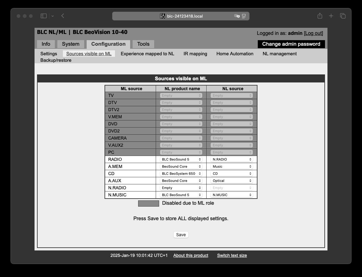

    Millemis
    Hi Johan
    Out of interest…….which (audio) sources are you able to use, when at the BV10?
    And how do you start these with the Beo4?
    #62876
    Tignum
    GOLD Member
    Hello MM,
    See below the configuration. Downstairs I use the Core for Radio, but in the ‘Study’ (=attic) there is also the BS5. When playing radio on the BV10 I like the visual of the BS5’s screen to show the station :-). The Beo4 commands are from the ‘ML source’ listing.
    The BV10 and it’s ‘own’ Beo4 are in LINK mode as I also use the BC6 (that is close to my desk) to play from the BS/BM5.
    Have a nice Sunday!
