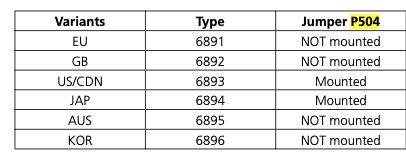

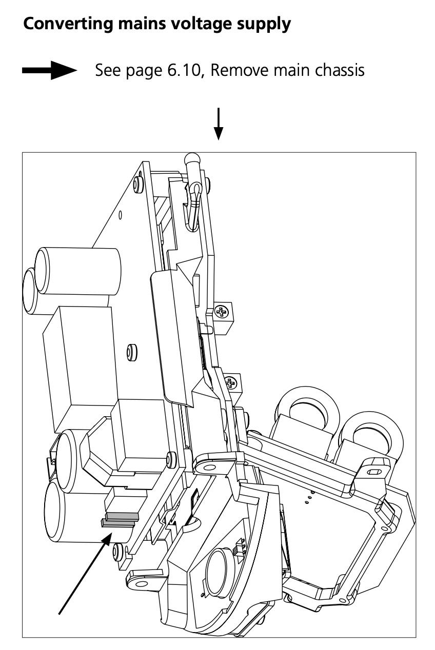

I need two of these little electric jumpers “P504″. I wonder if I need to source them from a B&O dealer (the one closest to me is many hundreds of kilometers away) or if this is a generic electric part, and if you could comment on where you might get one. It is also B&O part 7221489.
Any comments or anecdotes regarding this voltage conversion much appreciated!
Thanks in advance. Below the images from the manual:

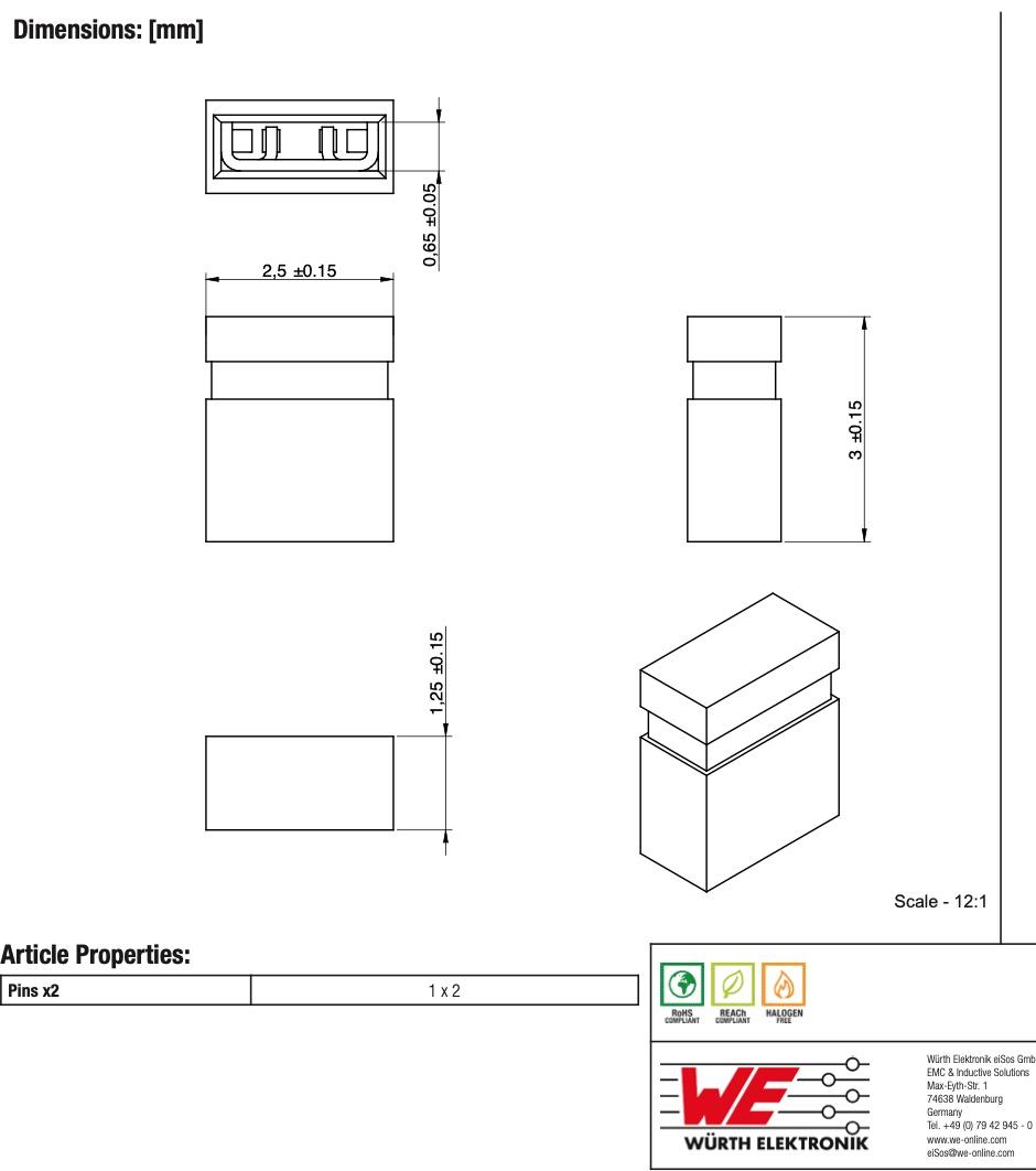

Wow. I even have a friend with a Digi-Key account! Of course you are right that that must be a standard industrial part. But all OEMs (including B&O!) do this: they use a propietary part No. when it’s probably something from Würth like the image below.
If I get it from B&O it’s going to end up being $50 for 2, I just know it! Which is fine, I wouldn’t mind. But today, for instance, B&O Scottsdale didn’t even get back to me.
I’ll contact tekmg.
Digi-Key apparently would sell something along the same lines (if I had the measurements!) for 6¢! See below.
