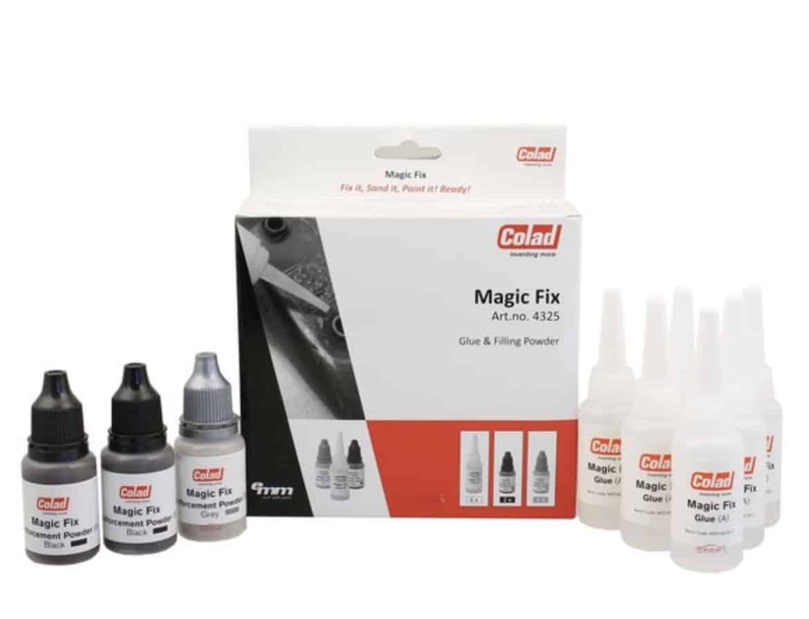

    #125310
    Jan
    I have tryed al lot of glue. But this one does every time the trick for me.
