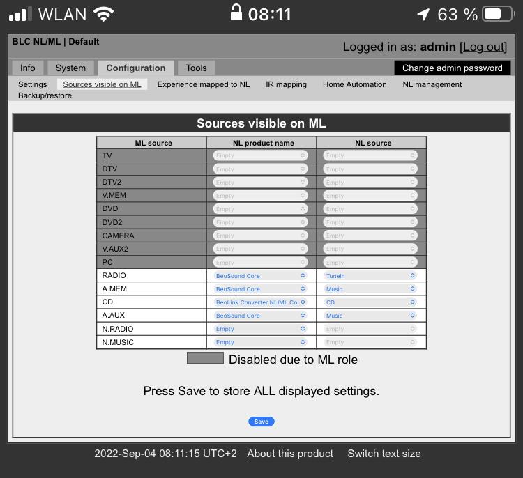

    #38807
    Jo
    You need the Converter. Here‘s a Screenshot of one of my Converter.
    FAB85C27-FEB1-4BA8-A95E-F124D7B904DE
    Location: Germany
    #38808
    Tim
    I have setup everything correctly (in my opinion). Is this a problem when the NL/ML is not connected directly to the BeoVision but is connected through the ML Distributor?
    This are my setting:
    BeoLivingroom is the Core in the Livingroom 😉
