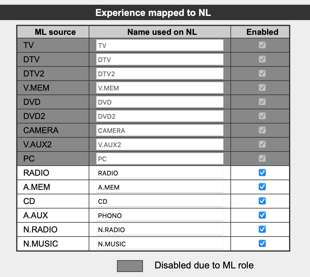

My current setup looks like this:
NL/ML Converter → MASTER LINK → BEOLINK 1611 → BEOMASTER 7000 (AUX INPUT)The NL/ML Converter is configured as V Master.
The NL/ML Converter has SW 1.4.0.18322.Under “Experience mapped to NL,” the setup appears as shown (see Image 1).
In the Bang & Olufsen app, I have added the NL/ML Converter and given the Beoremote Halo access to control it. The problem is that no sources appear on the Halo or in the NL/ML Converter within the app.
Am I doing something wrong?
23 February 2025 at 10:37 #63957 carolpaBRONZE Memberpresumably is the sw version in this Beolink NL/ML converter the cause of this phenomenon.
the latest sw version = 1.4.3.19864
no auto software update of a BLC available anymore, so you have to go to a dealer to update!
