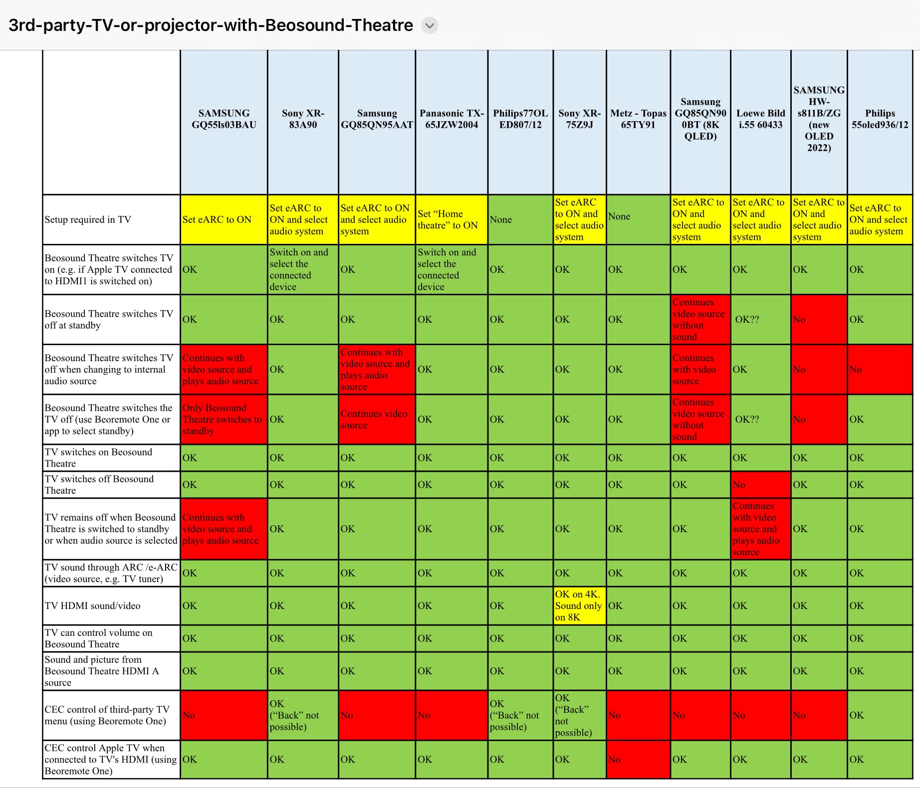

24 July 2025 at 09:10 #67710 MillemisBRONZE MemberI am pretty sure that these internal speakers won’t work, when the tv is connected to the BS Theatre.
Connecting the tv and the Theatre requires activating ARC/eARC in the tv (and CEC), which normally would exclude sound from internal speakers.
Only a test can tell.
Maybe someone else has tried it.B&O once made a table of what is possible with 3rd party tv’s.
The TCL is not in there, but it might give you an idea of the ‘troubles’ when not connecting to a recommended LG- tv.By the way – those built-in speakers do not rank high in the tests…….however, they seem to be better than most built-in speakers of the current tv’s.
