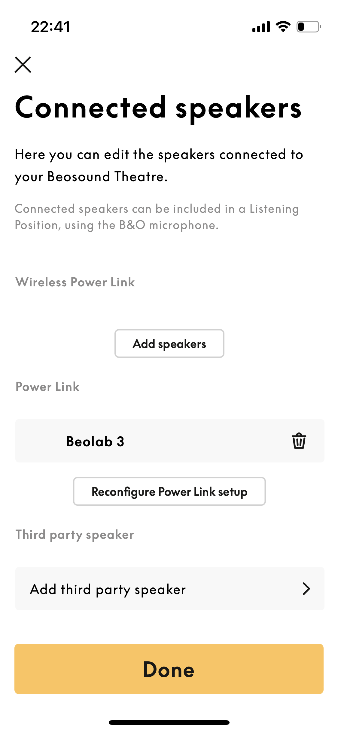

GOLD MemberAttempting to connect 2 Beolab 3s to the theatre as rears (left and right back). I am using mkII Powerlink cables going into a Rj45 splitter into PL1 socket on the Theatre. When I add the speakers it seems the theatre only thinks there is one. I thought one PL socket accommodated 2 speakers? I get sound from both but when I assign roles, I can only choose left or right. Do I have to now buy another Rj45 adapter and have one speaker going into PL2 then?
cheers
28 January 2023 at 14:15 #38119NQVHNWI
FOUNDER MemberThe Theatre will recognise the number of powerlink connections connected. In my example, I have 4 “+”. If only connecting a single pair of BL3 with a splitter, you will show only 1 “+”.
Press the +, add a speaker.
Press the new +! Add second speakerthen follow instructions to set channels (music plays in each speaker), the follow room sense
28 January 2023 at 14:42 #38120etype76
GOLD MemberThe Theatre will recognise the number of powerlink connections connected. In my example, I have 4 “+”. If only connecting a single pair of BL3 with a splitter, you will show only 1 “+”. Press the +, add a speaker. Press the new +! Add second speaker then follow instructions to set channels (music plays in each speaker), the follow room sense
What screen is that? I don’t get any “+”. Even when I go to product settings>connected speakers.
28 January 2023 at 15:12 #38121etype76
GOLD MemberI get it now. I just started all over again and see the + sign. It’s late so I’ll sort it out tomorrow. Thx Mr. 10 percent for pointing me in the right direction. 🙂
