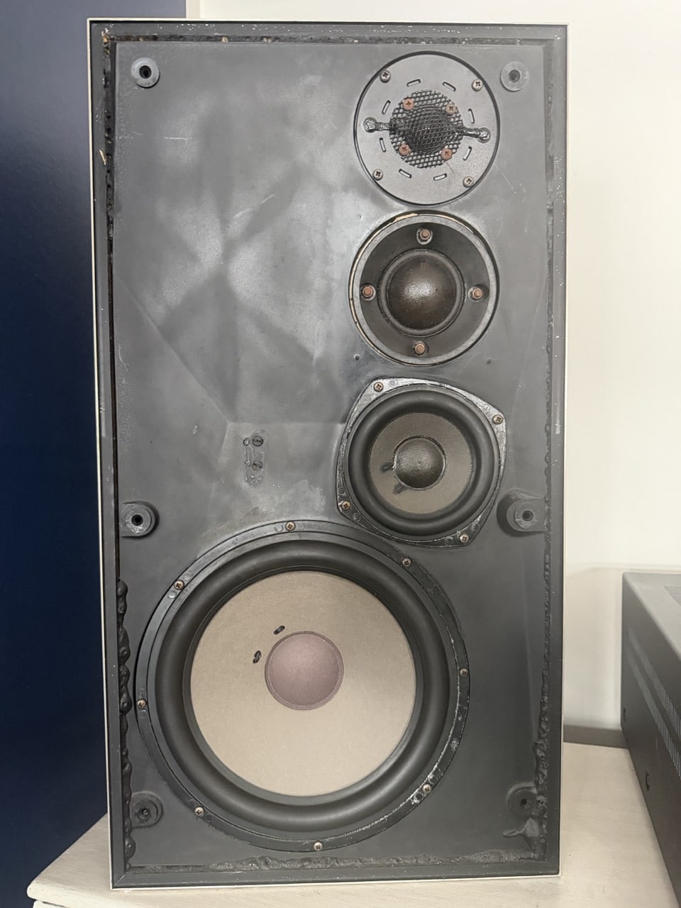

    As far as I know, all standard Beovox M70s have their tweeter and mid-range drivers offset to the left side of the front baffle to minimize diffraction. But on my speakers, the drivers are offset to the right.
    I have never seen them sold as acoustically mirrored pairs (Left/Right), and every brochure or picture I can find online shows the left-aligned version.

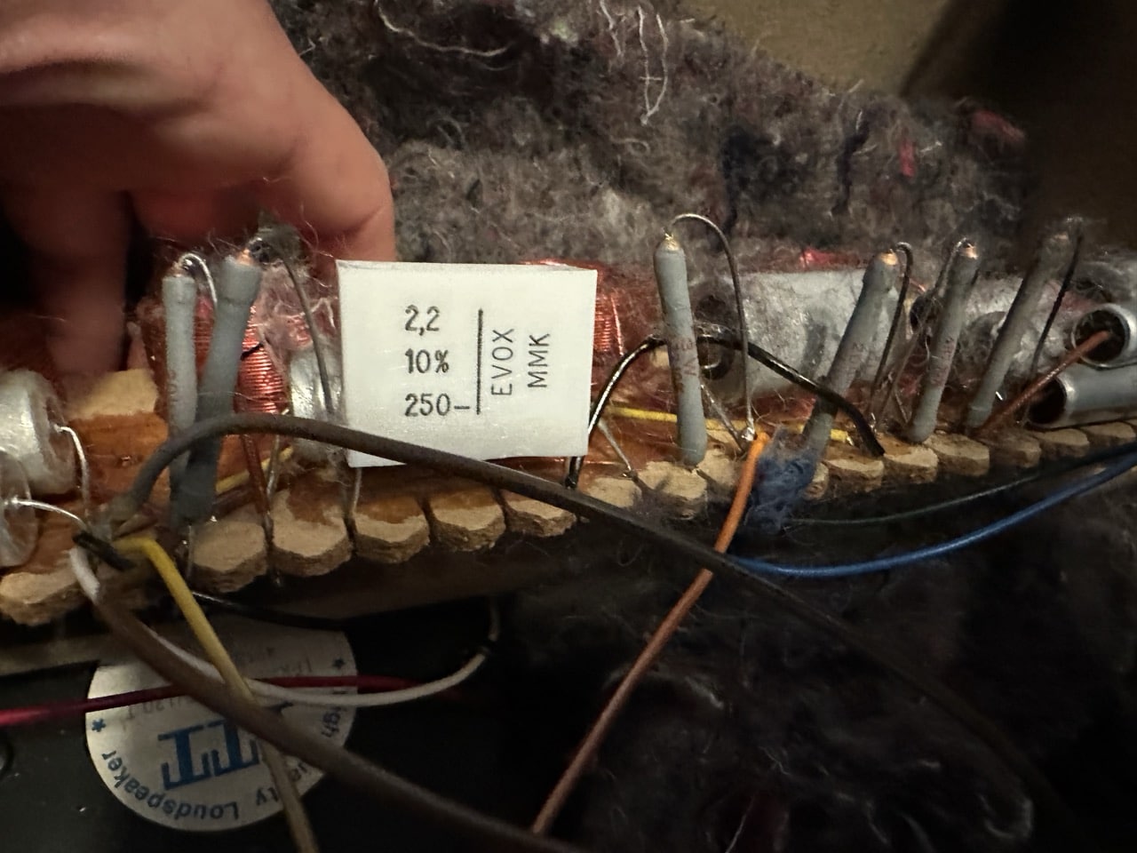

    • Crossover Note: Interestingly, the crossover features a factory-fitted 2.2 µF Evox MMK film capacitor on the tweeter circuit instead of the standard bipolar electrolytic (Wico/ROE) usually found in mass-produced M70s.
    Does anyone have any information or knowledge about this right-aligned version?
    Could this simply be a CNC-routing error / production anomaly at the factory in Struer that slipped through Quality Control, or perhaps a special edition or experiment?
    I have attached pictures of the front baffle and the Evox capacitor.

    I have seen both left and right aligned models.
    Definitely most left.
    It’s not that at some point mirrored pairs were sold. No, they are always found in pairs, either both left or both right.
    Why, I cannot say.
