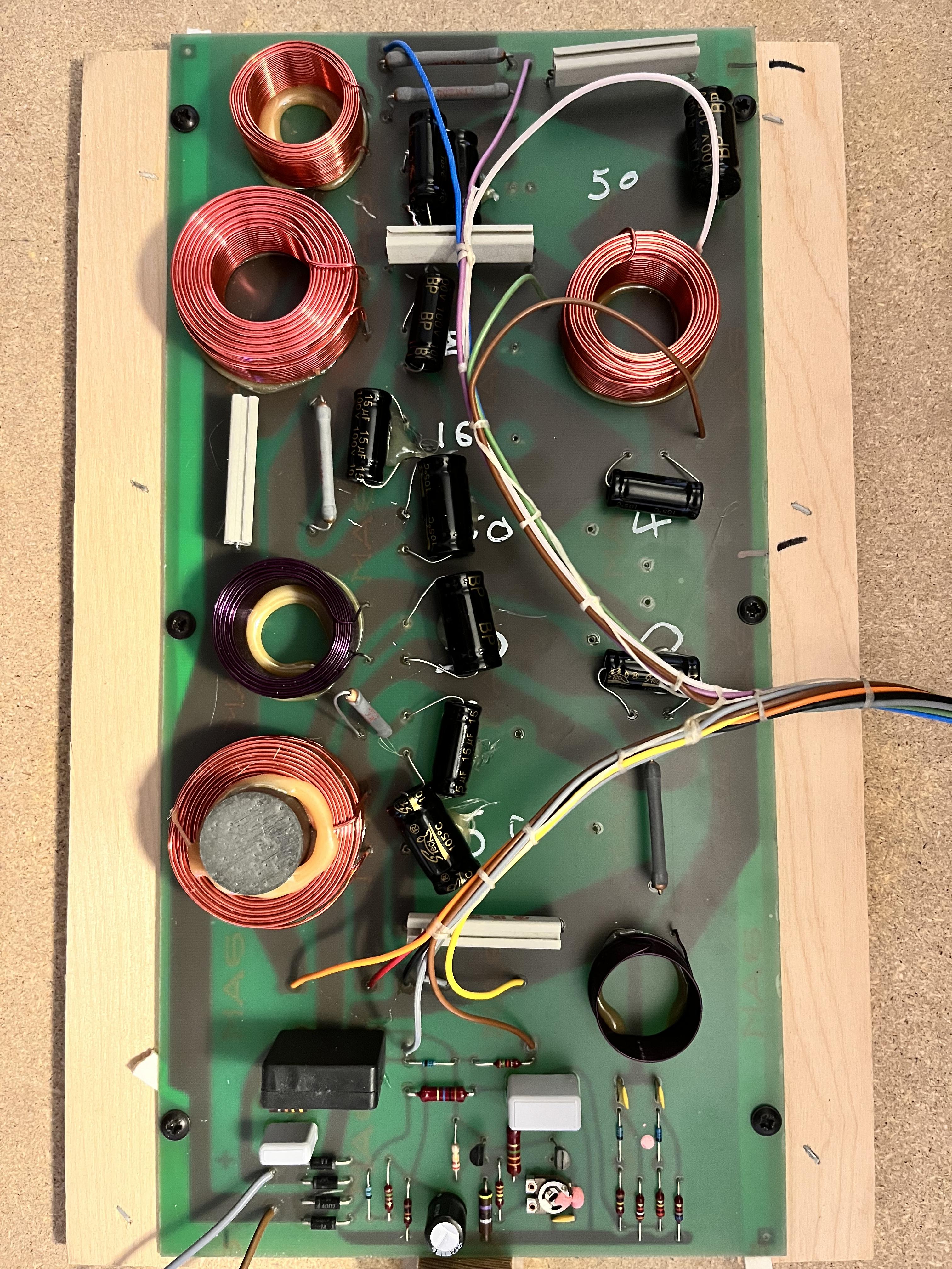

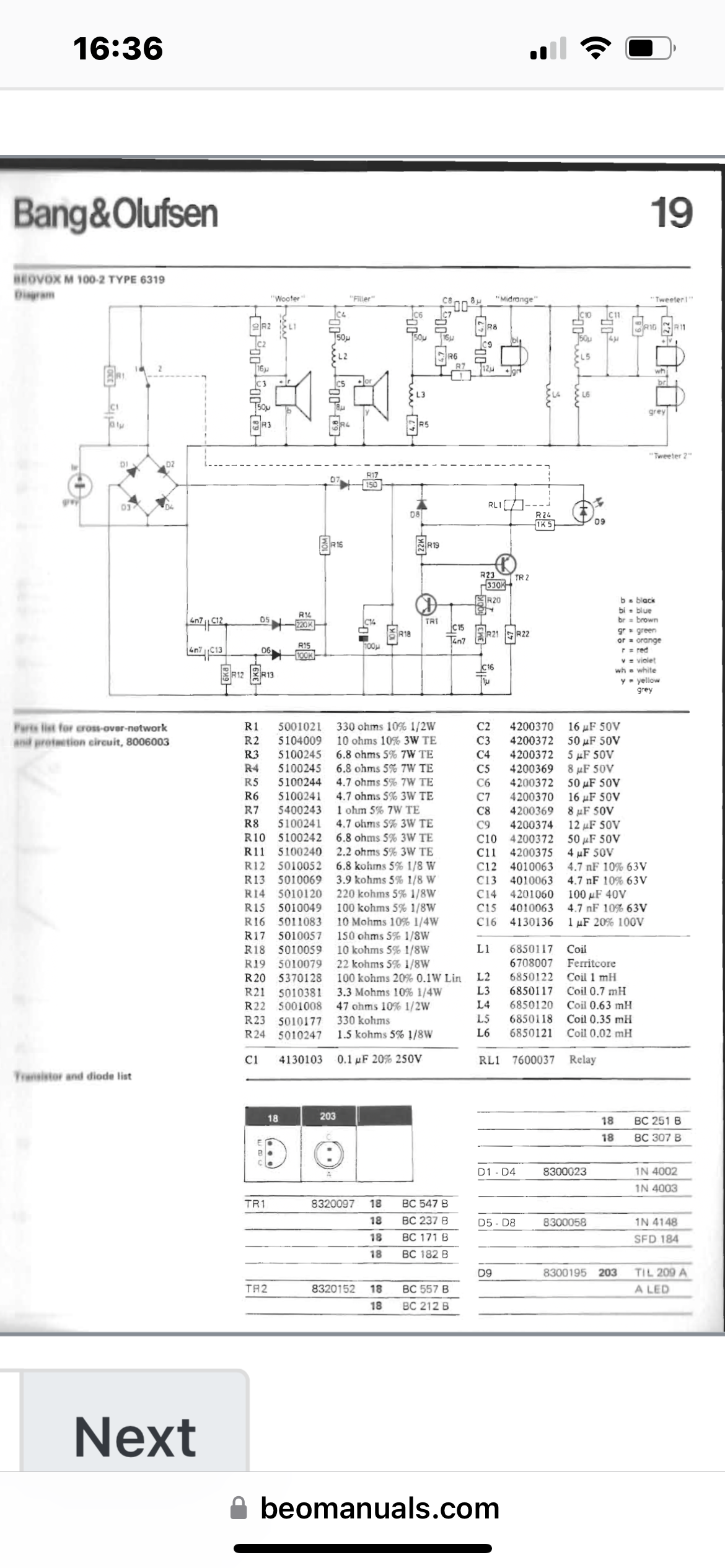

    Hi guys ,
    had a little bit of time this weekend to check over my M100-2’s speakers, the previous owner did mention that he had recapped the crossover ( and maybe the coils )
    now I have a concern as none of the capacitors on the crossover match a schematic that I have , which do I trust ?
    does anyone have a photo of their crossover please?

    now I’m even more confused as I count 11 capacitors on my crossovers but there are 16 according to the schematic

    Glitch
    It looks to me that there are 10 bipolar capacitors on the schematic and “10” on the actual crossover board. I’m assuming that the two capacitors to the right left of the “50” on the board are wired in parallel and should be counted as one.
    The other caps are (likely) the white boxes, yellow components and the electrolytic on the bottom of the board.

    TheFinisher
    Hi Glitch , thanks for the reply. There are 2 soldered together to left of the 50 , thing is none of them match the values of those on the schematic.

    Glitch
    The former owner may not have been able to find the exact values and substituted the next closest values.  Piggybacking the capacitors in parallel is one way of getting a value closer to the original.
    Post a table of the installed values versus the schematic values. This will make it easier for those that want to help to give better advice.

    TheFinisher
    So it would appear that you are correct.
    is it ok to do so ?
    they do sound very good , I mean end game speakers.
    Surely the wrong values will have some effect on their performance?
    Schematic               Capacitors currently installed
    C2 16uf                     2x 8.2uf
    C3 50uf                     47uf
    C4 5uf                        4.7uf
    C5 8uf                        8.2uf
    C6 50uf                      47uf
    C7 16uf                       15uf
    C8 8uf                         8.2uf
    C9 12uf                        15uf
    C10 50uf                     47uf
    C11 4uf                        4.7uf
    #45649
    premiumverum
    This is fine. The original caps have values that are not available anymore. Tolerances on these 1970s caps were +/-10% probably so e.g. 47uF instead of 50uF is close enough. Everything the previous owner installed is within spec.

    Glitch
    This is not completely true. A quick check of part-express.com will show that you can still buy capacitors that are marked the same as the original caps. One would have to measure the caps that were received to be sure.
    There are a few other manufacturers of higher end caps that would likely have the original values (but you might have to wait a while for them to come into stock). The tolerances on these caps are very close to design, but are much more expensive.
    In many of the other capacitor brands or product lines they will only make the values similar to what you have in your crossover.
    I generally agree with premiumverum about the tolerances (assuming that the original caps were +-20% parts) and the sound.
    I’d leave them alone if you like how they sound. Unless of course, that you like tinkering with things as much as listening to music.
