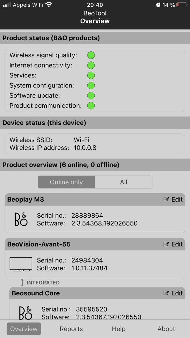

In my living room, the speakers are connected to the TV. So I decided to have an integrated set-up in my living room. The BS core is not available on the app. The beotool app is ok (all lights are green) and the core is integrated with the tv on this app.

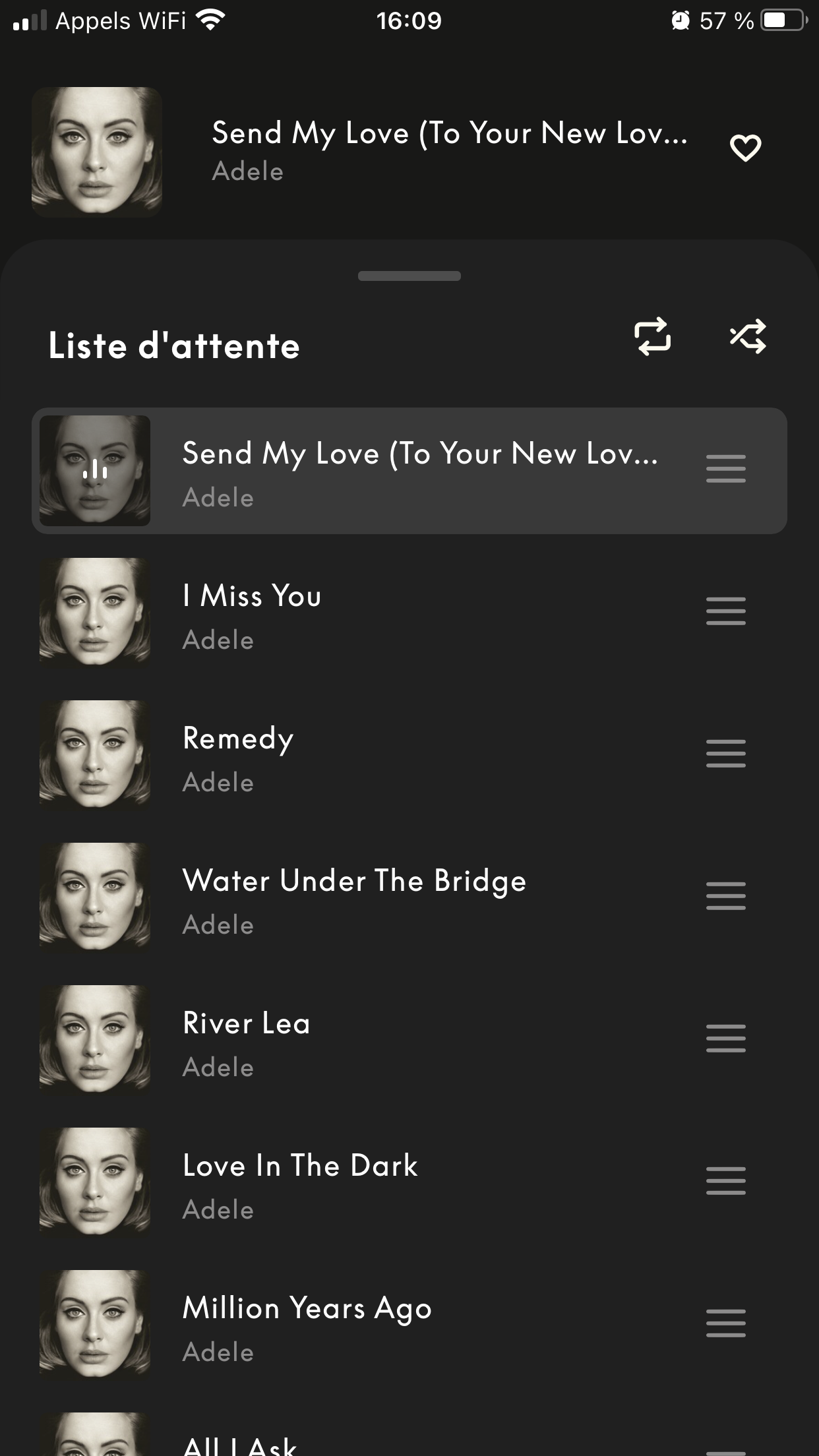

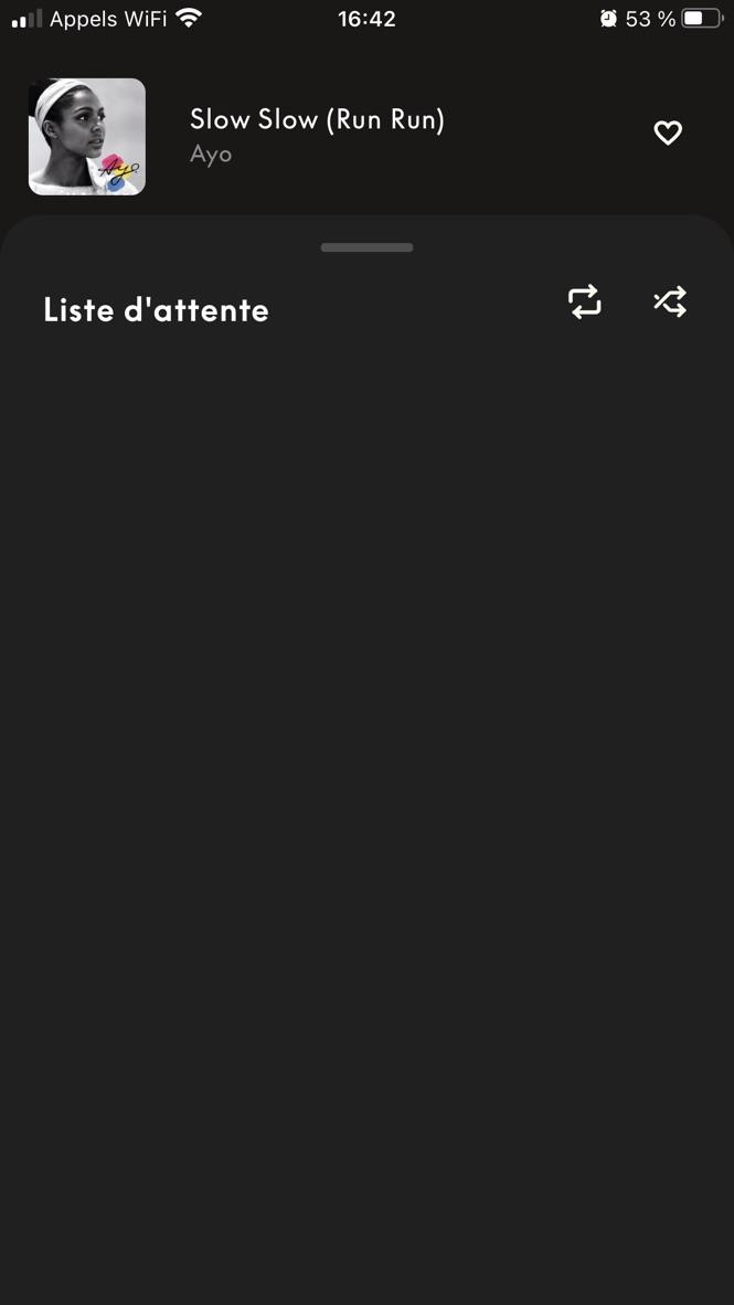

From the B&O app, I can select my sources (TV, or Music) but I have a problem with the « queue » list. There is almost never one song in the queue… But when I select the next track, the system is going on the next track. Which means the queue is there somewhere (on the Core I guess) but not on the TV nor the app. So I can’t modify the queue, delete one song, add some other, change the order, etc… I can’t either navigate in one song (if I want to go straight to pass 1:30 in a song, it doesn’t do anything.

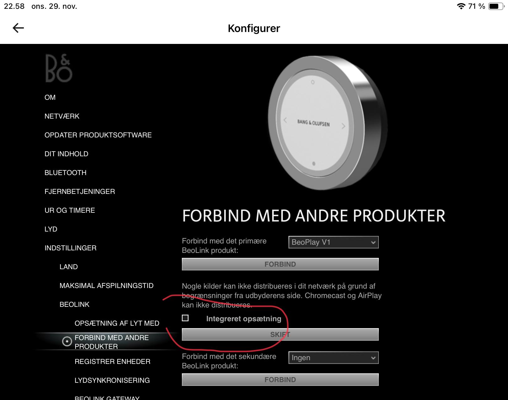

If you want to change the settings to ‘Integrated’, I can provide a screenshot, that shows how my Essence works with my V1 tv.
This can show you, what to do with your setup.For that you must dig deep into the konfiguration page of the Core and find the section ‘Beolink’…..’Connect with other product’
Please notice that my Essence is not integrated, but you see the box – that would have to be ticked for this – marked with red.I guess it should be understandable even if in danish.
Don’t worry, you can always revert the setting, if it does not behave as you’d need it.

The Core is already integrated with the TV. The sources of the Core are available in the Source Menu of the TV. I checked the section beolink of the Core, the integrated box is ticked.

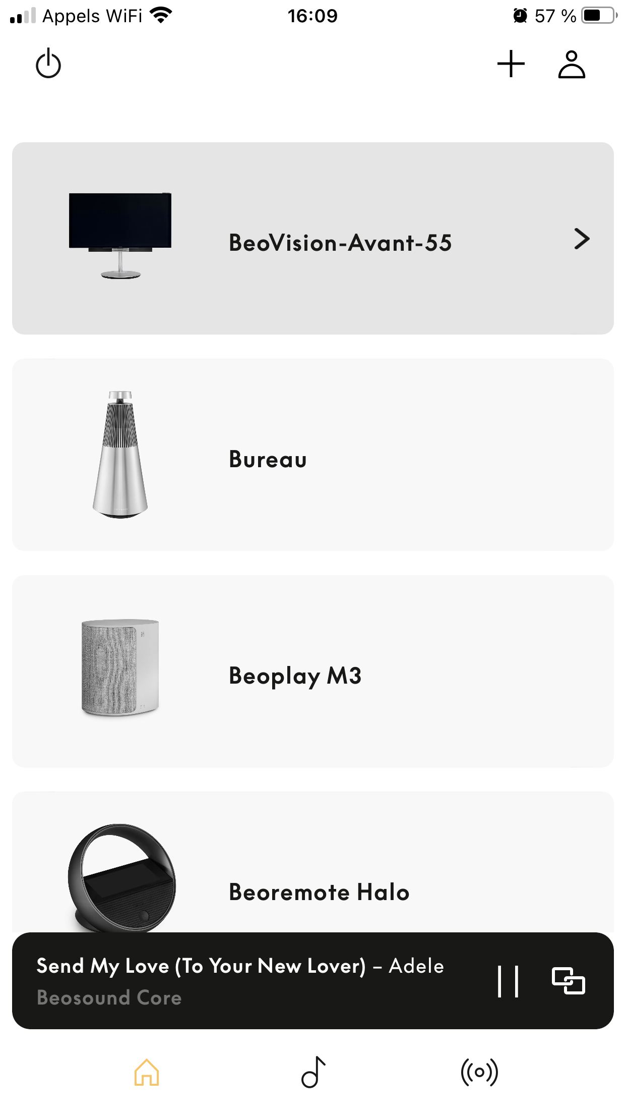

The Core is also integrated in the beolink app (see below).

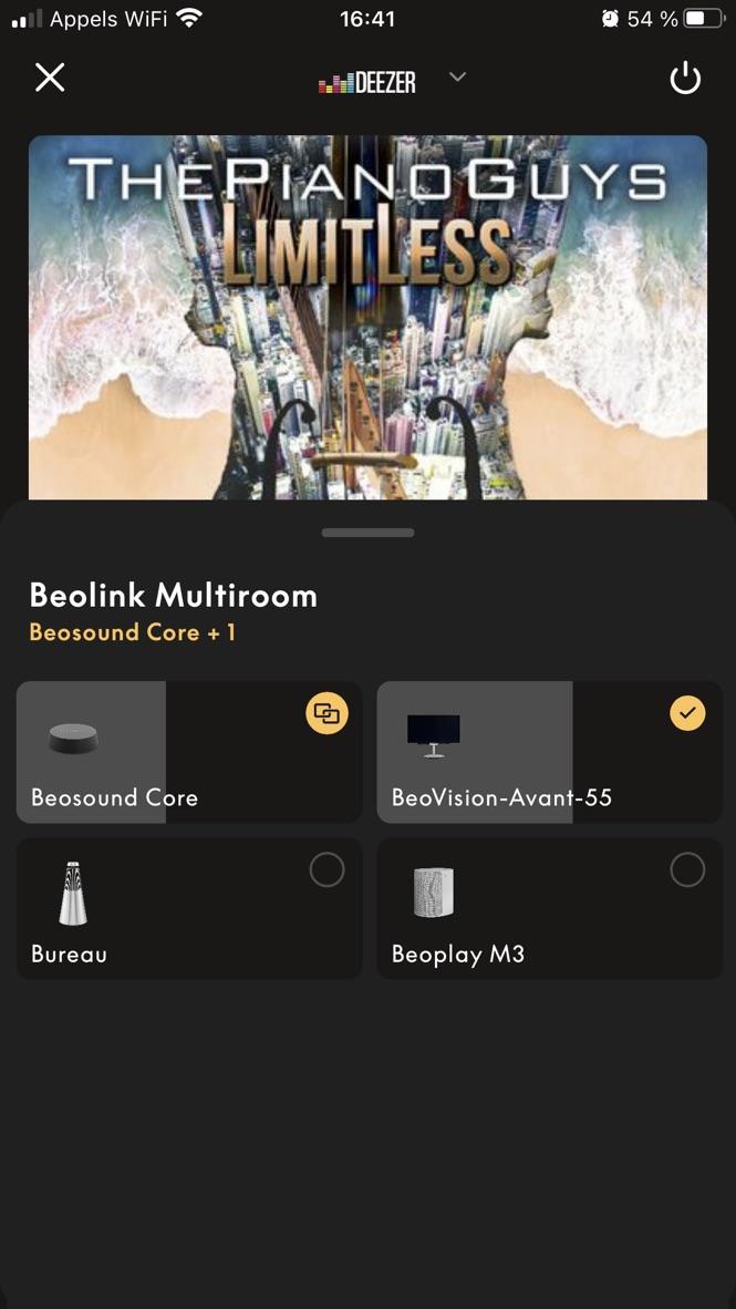

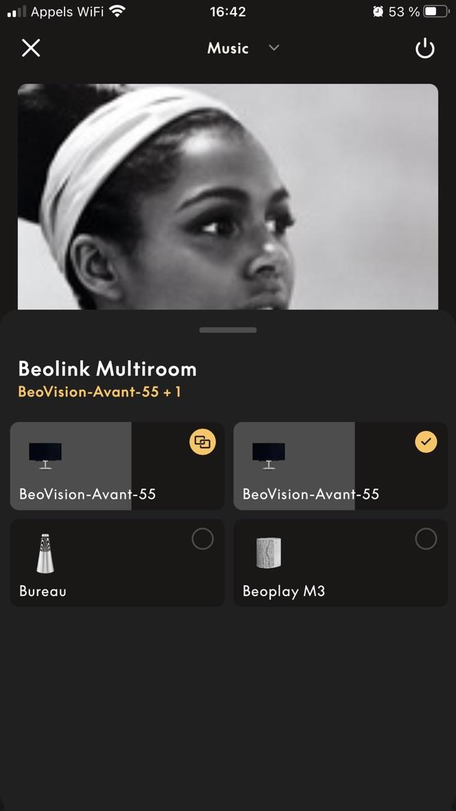

But not always… Sometimes on the app, I have two products linked (Core + BV avant) and it works perfectly (queue playlist, etc…). Sometimes I have two BV Avant linked together (weird), and in that case, it’s not working. The music is playing but no playlist anymore…
Case n°1 : Working.
Case n°2 : Not working :
When it’s working properly (once every two weeks…), if I close the app and open it again, it’s not working anymore… I really don’t get it…

BRONZE MemberWhat I don’t understand is why sometimes I have access to this queue, and why sometimes I don’t. In my previous screenshots of the app, it happens randomly (and the core was integrated all the time when I took these screenshots).
I though, but I may be wrong, that when those two devices were integrated, it would behave as one device but with all possibilities. And this is not the case because I can’t access to this queue 99% of the time. But maybe it is the way is it supposed to be ?

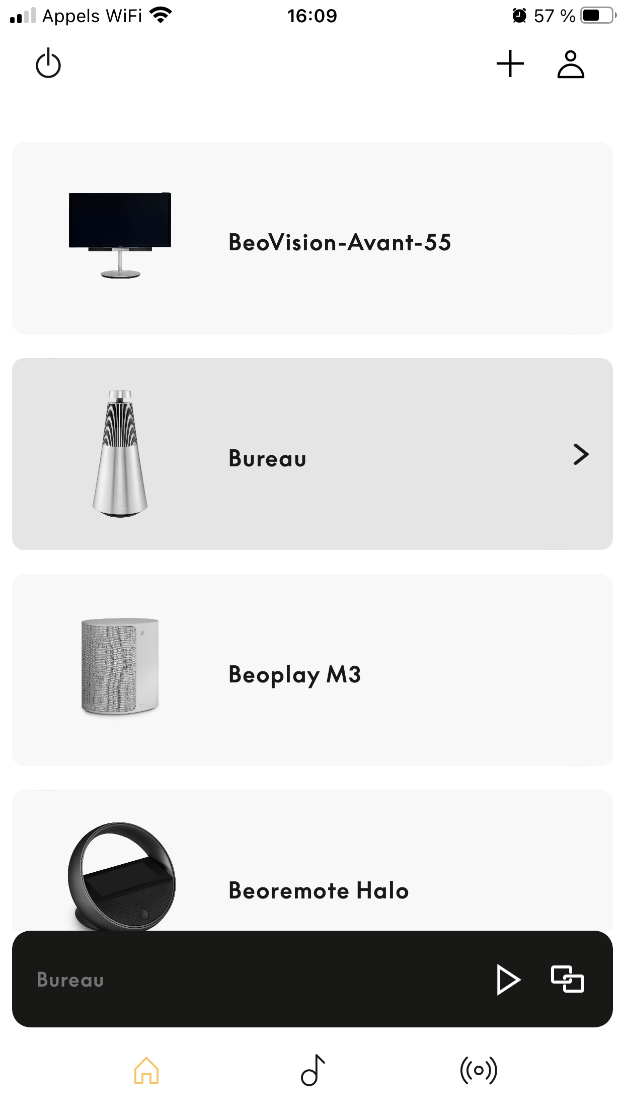

BRONZE MemberAnd to complete this topic, I’ve found a way to remove the bug. A bit of luck when trying to set up all of this… And then I understood ! Maybe it will help someone else…
When the TV and the Core are integrated (what I wanted), if I close the app (with for exemple the BS2 selected), and if I open it again. The BS2 is still selected at opening. Then if I click to the BV Avant, the name beosound Core is written in the black line at the bottom of the app. And all is working. I have access to the playlist, I can navigate in a song, etc…
When I click to the multiroom Menu, I have two devices (the core and the beovision Avant). And all is working, a real integrated product 🙂
But, if I close the app with the BV avant selected and if I open it again. The BV avant is still selected at opening, and it is not working. In the multiroom menu, I have two products with the same name (BV Avant), and the playlist is empty…
So, it’s only working if I select another product, then close the app, open it again, and select the BV avant. Not so convenient, but I can find a way to manage a playlist if I want !
I presume it is a bug in the app, a weird one. And it was already there in the previous app…
