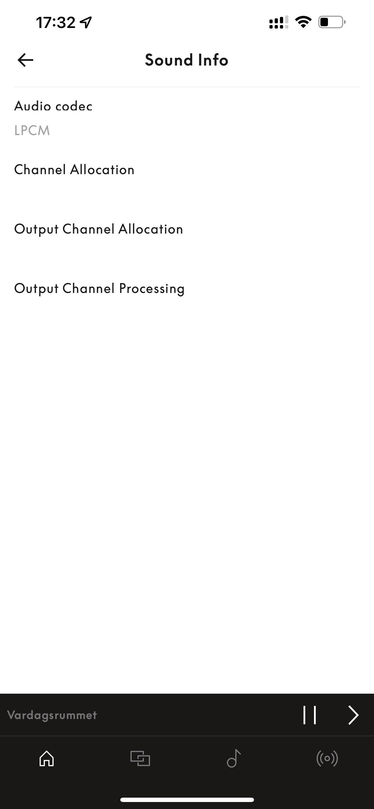

    I found was I was looking for.
    In the app under settings and sound info, I found this screen:
    EC9EBF75-1CFC-45B8-99F5-46F828D051FF
    I was puzzled why it did not say Atmos.
    Then I changed the sound out setting in the TV (Apple TV is connected to the TV) from PCM to Auto and then the following showed:
    35AC2E11-ED6C-47B7-B222-A566D97E7666
    All good! ?
    Location: Sweden
    #37227
    Millemis
    The setting PCM in the ATV means that the ATV must decode the stream – this way you won’t get any Atmos metadata….and thus no indication in the app.
    If set to Auto the ATV will know what us on ‘the other end’ and will send the Atmos stream for the Stage to decode = indication in the app.
