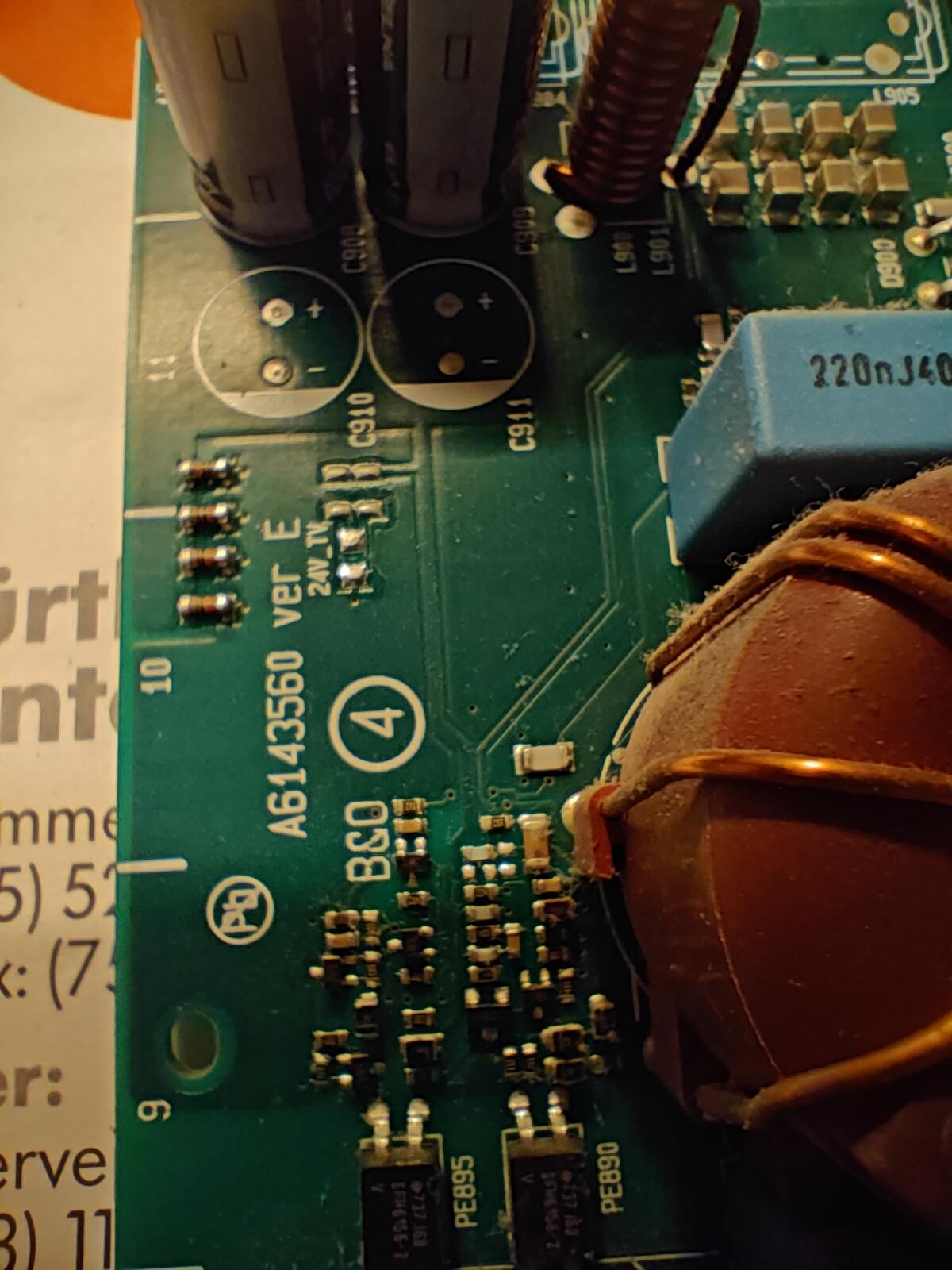

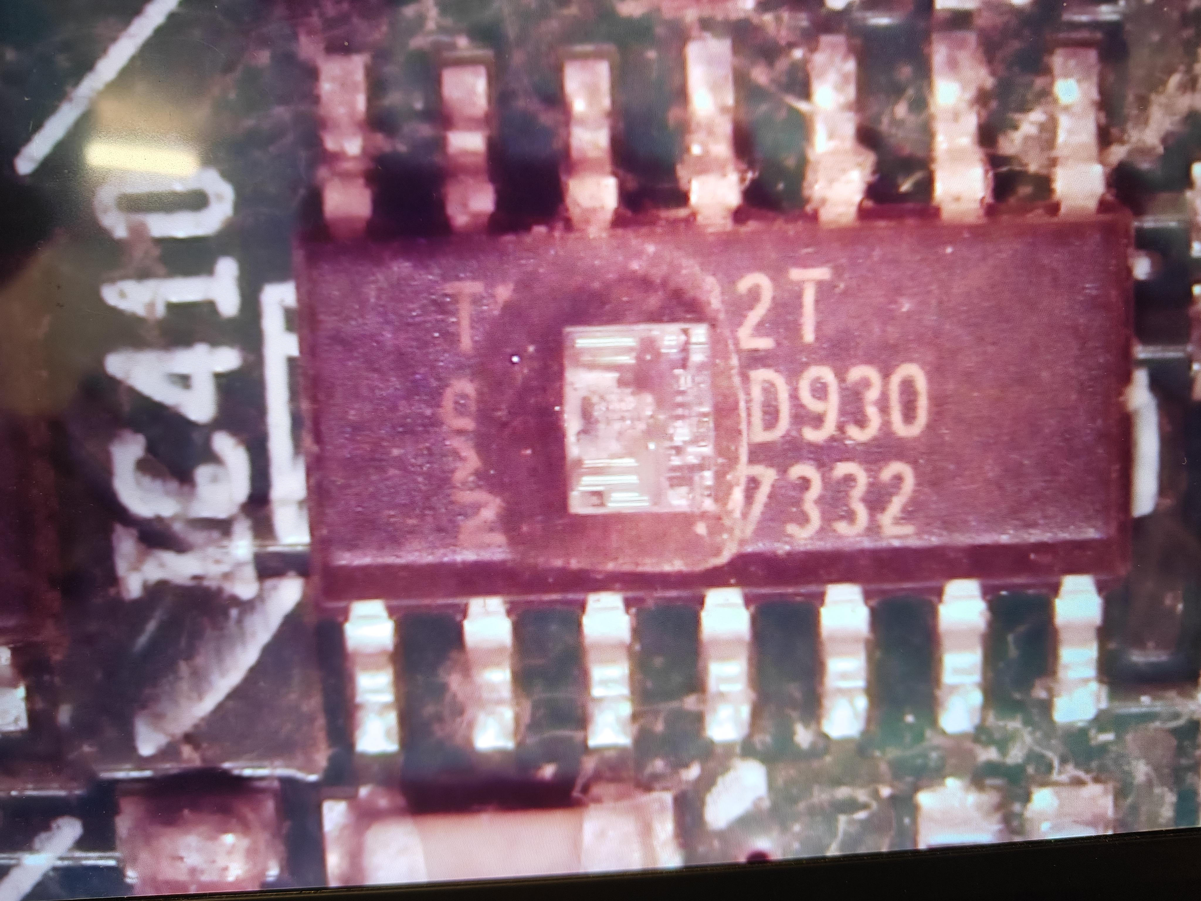

IC 410 just blew its top and now the stand-by circuit of my BV 7-40 has stopped working. The TV is now dead as a brick. Does anybody have a parts list of even a board of the same type and can tell me the exact type? Only half of the letters are readable.
It is an NXP chip and the type seems to be “T_2T” with underscore representing the lost characters (see picture below). Can anybody help with the missing characters?
TV: Beovision 7-40 MKIII type 9376
Board: 4156460 Ver EThanks in advance.

MemberIt is an NXP TEA1522T and when we changed it, everything went back to normal
