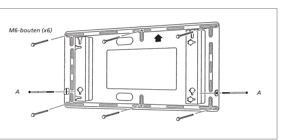

    As it’s been many years since I mounted my Beovision 4-42 on its fixed wall bracket, I can’t remember how to remove it. From diagrams that I’ve found, it looks like there are four protrusions on the back of the Beovision that fit into the wall bracket? Would it be correct that you just lift the Beovision up a little and then back it away from the wall?

    One can lift the BV4 off. But did you place the securty screws during installation?
    Remove them first.

    Thank you for your response, Carolpa. I wouldn’t even had thought about the security screws. Could you tell me where they are located?

    Thank you for your response, Carolpa. I wouldn’t even had thought about the security screws. Could you tell me where they are located?bv4 secu-screw
    the “A”s
