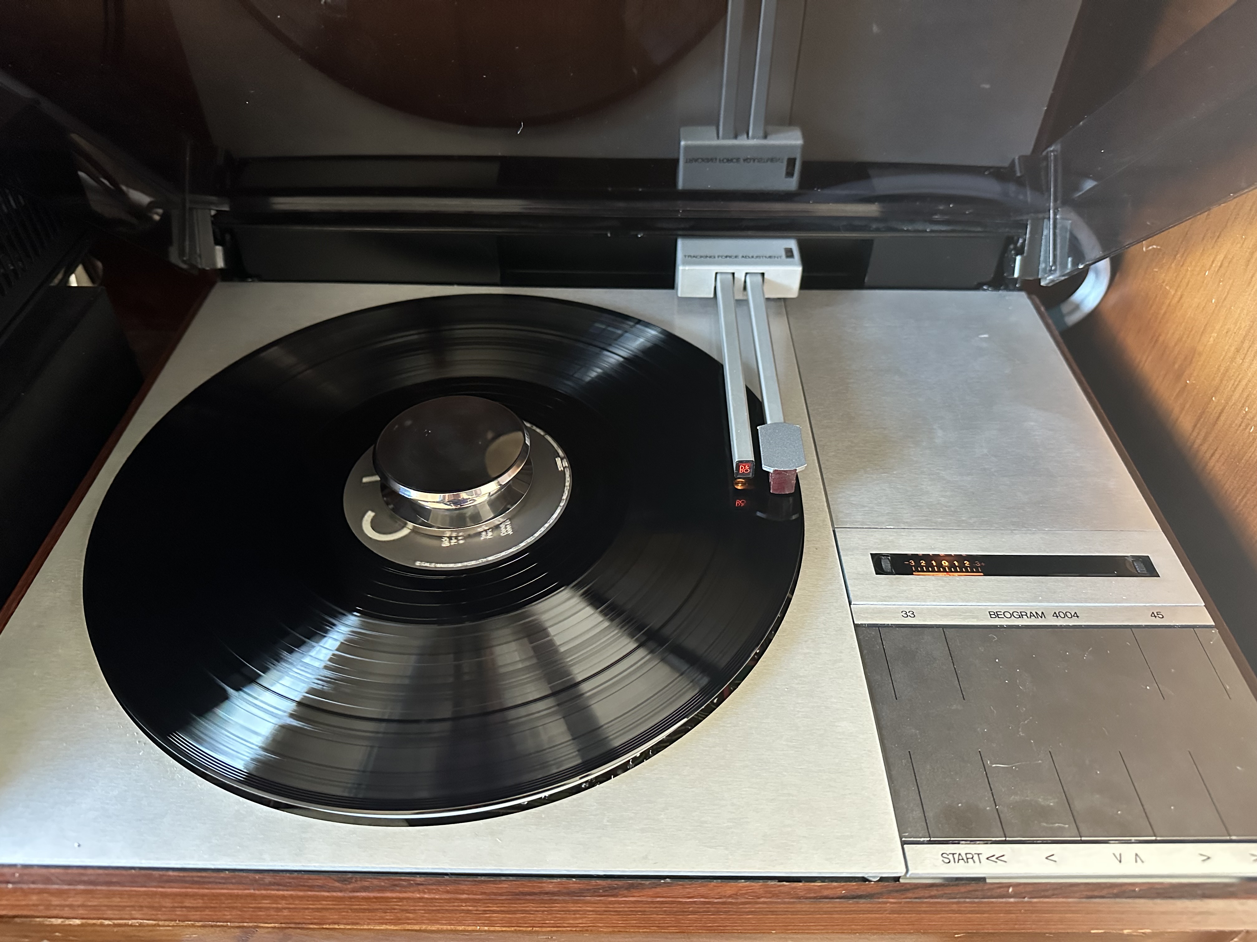

    Mark-sf
    Craig, thanks for the kind words. Here is a photo of one with the Grado Signature. I would also replace the tonearm wiring with silver wire and the phono leads with Varian Audio cables. Finally, there was an optional PhonoAmp board that replaced the muting one with an onboard DC-DC power supply to give it +/-15V.
