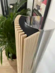

4 August 2025 at 23:05 #68303Samuel Vesterlund
BRONZE MemberHi everyone,
Since the 5 mm files are no longer accessible, I decided to design my own. They’re essentially a replica of the original design, but modified to fit 5 mm wooden fessets. I’ve tested them, and they work great!
Feel free to email me at Samuel.Vesterlund@outlook.com if you’d like the files.
Big thanks to @matador for the original design – couldn’t have done it without your work.
For the wood, I used pine from Bauhaus Germany, but they also offer oak if you order it.
Here are some pictures!
