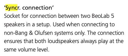

    Hello KHX, could the problem/solution be with the ‘sync cable’?
    https://soundsheavenly.com/beolab-5-beolab-50-and-beolab-90/41-beolab-5-sync-cable-required-for-connecting-beolab-5-to-non-bo-source.html
    From the Beolab 5 manual:
    sync
    I hope to own a pair one day, but for now this helps in resolving,
    Regards, Johan

    Is the volume control done with the Beo4 or at the Lyngdorf level ?
    I think the difference is coming from the chassis indeed, maybe different software release? The sync cable is only for volume sync when used in a specific use case: using a Beo4 only and no other B&O hardware.
    I experienced the same difference between R and L when I was owning BL5 in a full B&O environment (volume control via a beovision) . After some time I also improved them connecting (in digital) to a Lyngdorf, day and night in term of sound quality, and the difference is gone with it like you are experiencing. Just enjoy them with the Lyngdorf correcting the issue, or ask your dealer to replace the other chassis with the same than the other speaker

    KHX
    Thank you for the tip, however, I bought the sync cable from the official B&O retailer in Stockholm, so I assume it is original and not causing any issue 🙂
