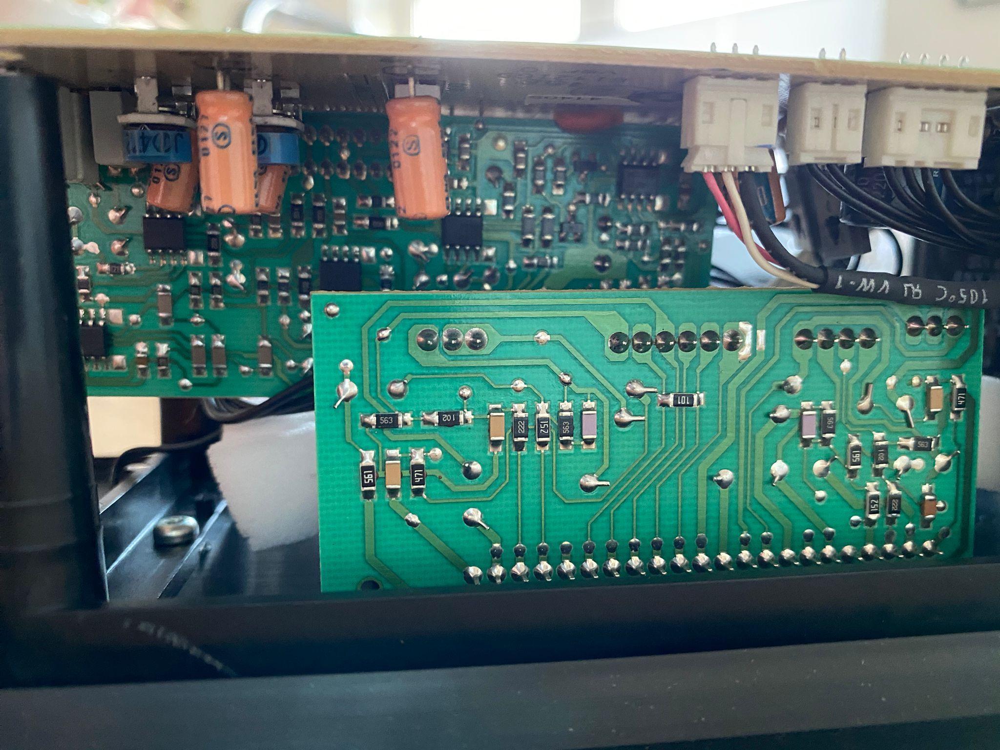

    Dear fellow enthusiasts,
    during restauration of a few of beolab 8000s i find it necessary to have adapters for calibration of the amps. I already spent a few hours in finding the connectors shown in the picture but i was not successful. Especially the connector for audio from the input terminals is of interest. Does anyone of you have an idea what part number from Molex or whoever they have?
    Thanks in advance,
    Martinbeolab8000connectors

    LeHe
    The connector for audio from the input terminals is P4 on PCB02 with B&O code 7220710 connector plug 3 pole ( see page 19-1 of the service Manual)
    For the original you can simply order it through a B&O dealer. (Last production date about year 2010, 10 years obligation to deliver, who knows old stock).
    These connectors were commercially available 35 years ago when the Beolab 8000 were designed. So there is a little chance that the same ones are still available. But I see several similar ones on Aliexpress and Amazon.
