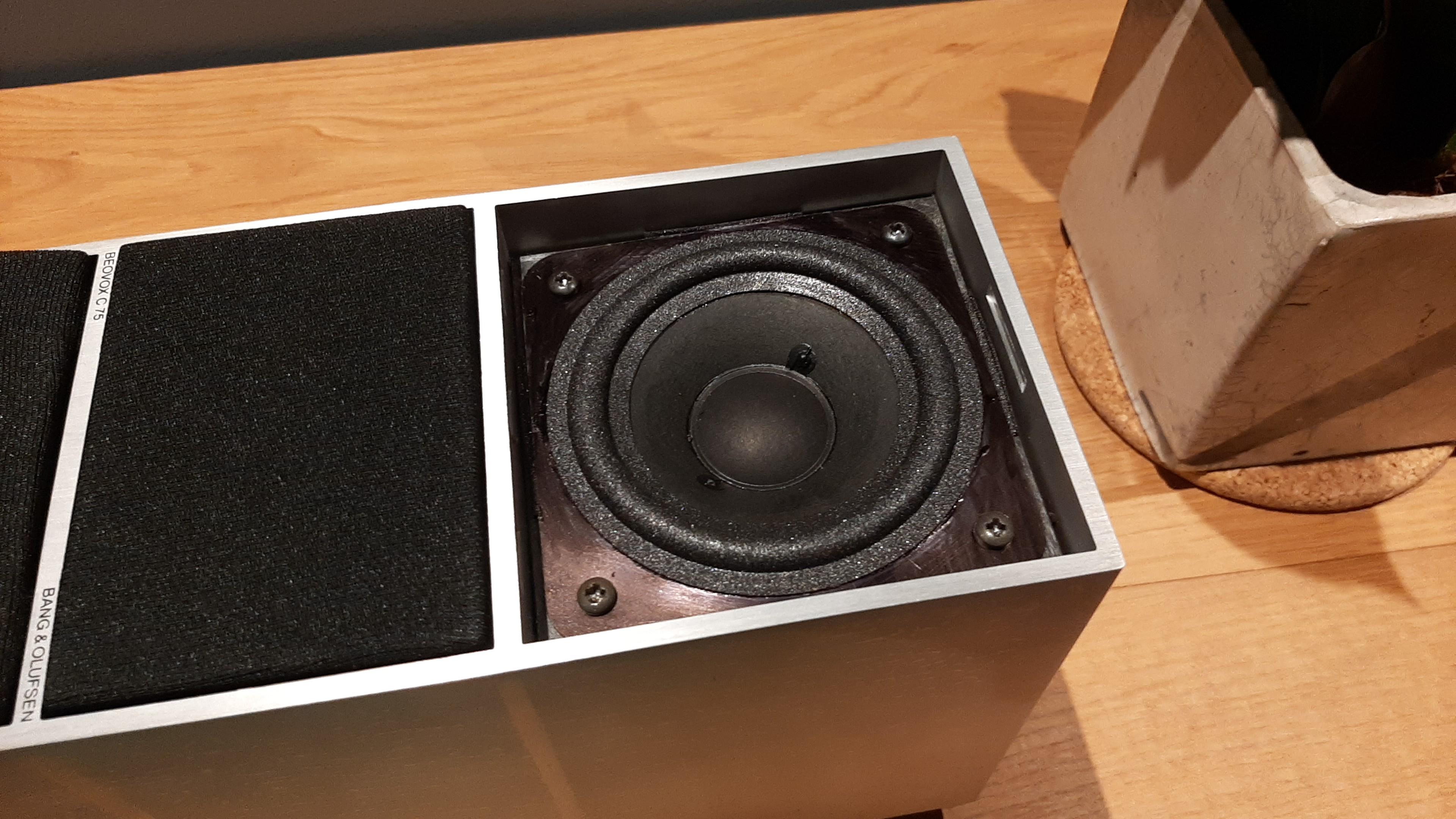

    Clean job xschop! Did you repaint the metal fronts of the drivers?
    I lately refoamed these for a colleague. About time 🙂20240125_191114IMG-20240128-WA0012
    I just touched up the metal of the drivers with a black marker as they will be playing with (freshly washed) frets.

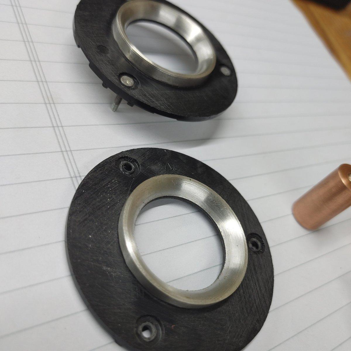

    On recommendation from another CX100 owner I removed the factory tweeter’ s phase cup and machined a slightly wider profile billet alloy ring to the throat for wider dispersion… I also added real lamb’s wool to lower it’s FS and melt with the midrange that much better. I Am very happy I did so…

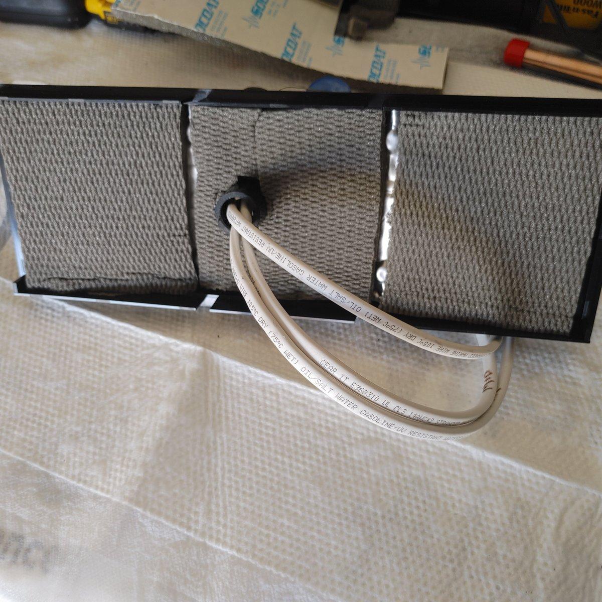

    Found my build pics in those units to show a modification not mentioned previously to dampen the stamped-steel basket frames. Having done this to many other drivers with stamped steel baskets, I followed suit with fiber-reinforced butyl rubber gaskets and high density polyurethane rubber adhesives. This negates the ringing/resonance from the frames as well…
