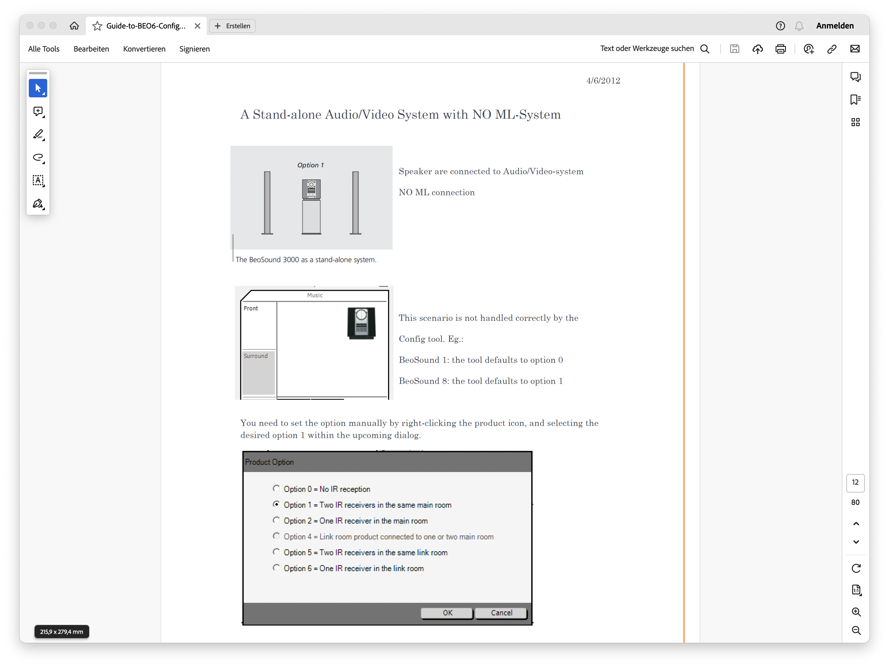

2 January 2024 at 19:03 #51492 skolesenGOLD MemberDear Boarcastle,
I found the attached file in my archive that I downloaded for a long time ago from the old forum. Hope it can be for some help when you start programming your Beo6.
/steffen

@skolesen: wow , what a detailed manual. Thanks for posting this gem. But before I get deeper into programming the remote I want to get a basic and simple configuration downloaded to skippy control my Beosound 5.2 January 2024 at 22:29 #51494boarcastle

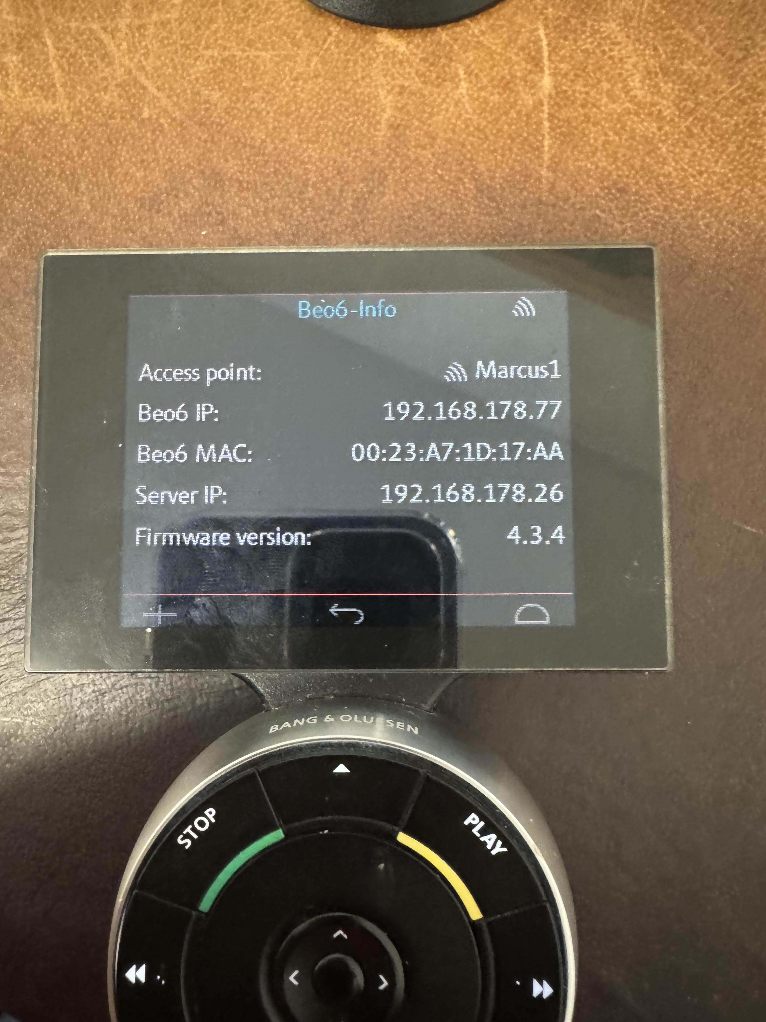

This is what I have done:1. I entered the IP address of my Beomaster 5 into the Beo 6 and saved it.
2. I chose my WiFi connection in Beo 6 and entered the WiFi password.

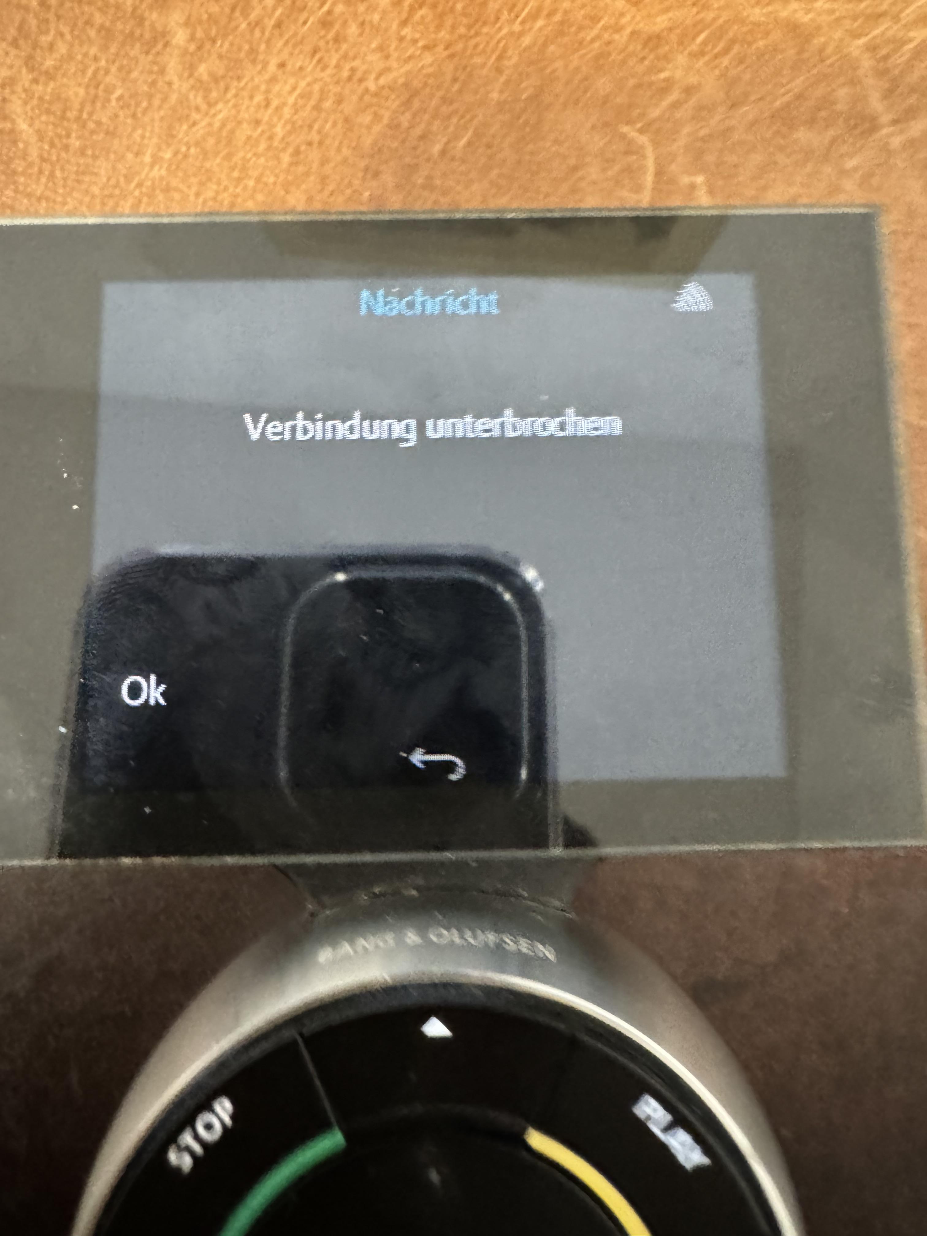

That seem to have worked because I can see the content (albums) of the Beomaster on the display of the beo 6.But whenever I choose a song to play, the connection is interrupted.

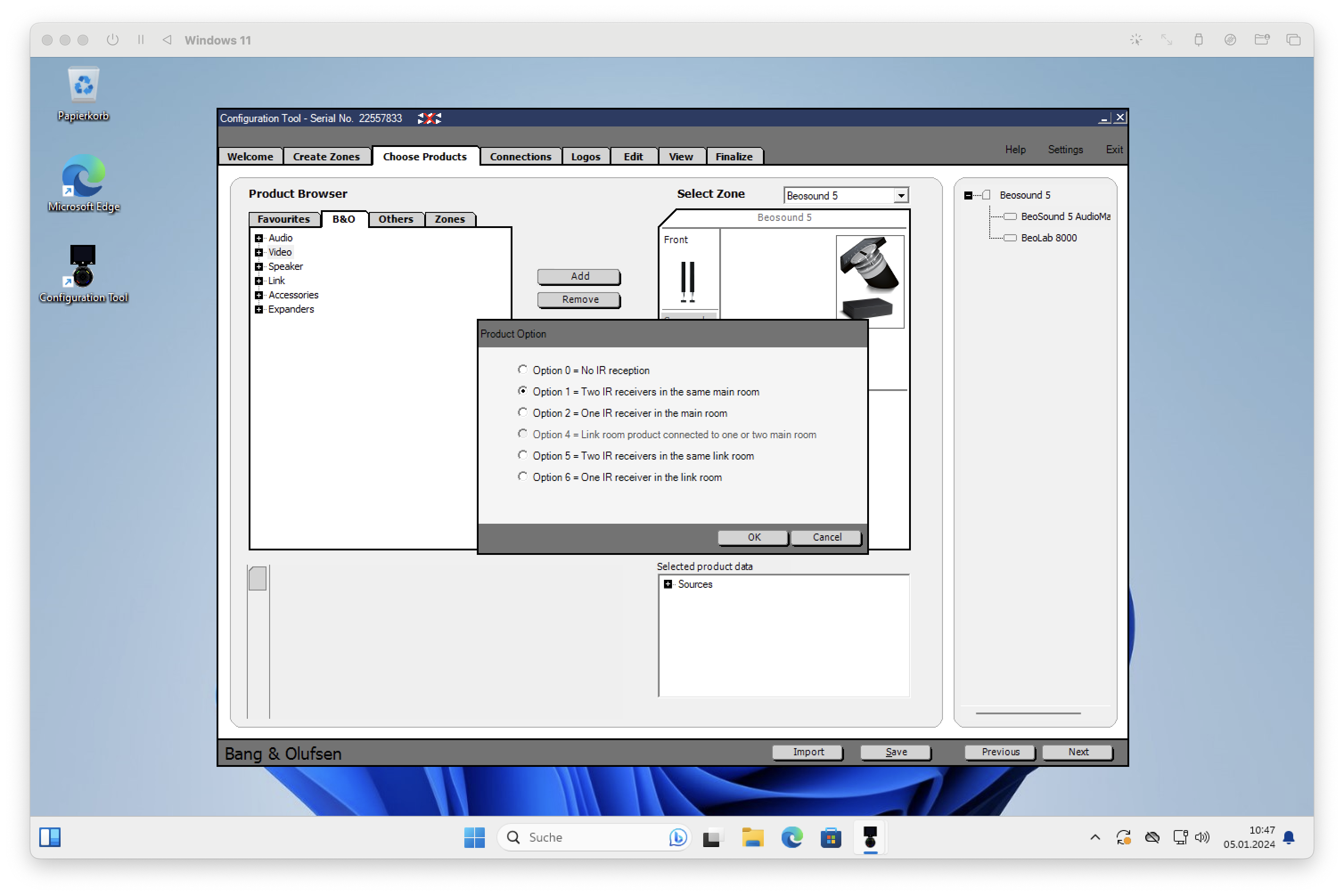

In the configuration tool I have the following set up:
does anyone have a clue what I am doing wrong ?

GOLD MemberI’m not sure if it will help with your particular problem but, looking at your settings above, I think you need to set the setup to Option 2 because if you only have the BS5 and speakers ther will be only 1 IR reciever.
To set the option on the BS5 once you have set it on the Be06, you put the BS5 in standby, press the Red dot and center button on the Beo6, you will see “Option Pgm” in the list. press that and then press the button that comes up. (Beosound 5 on your screen??). That should set the option.
Onfortunately I don’t know enough about the BS5 to help with connection issues

BRONZE Member6 January 2024 at 17:17 #51501boarcastle
BRONZE MemberI just read Keith Saunders comment that Beo 6 doesn’t support modern WiFi standards. Only the outdated 802.11 b or g. If this is true the remote has no value for me. My modern router doesn’t even give me the option to set my WiFi to such outdated standards. ☹️
