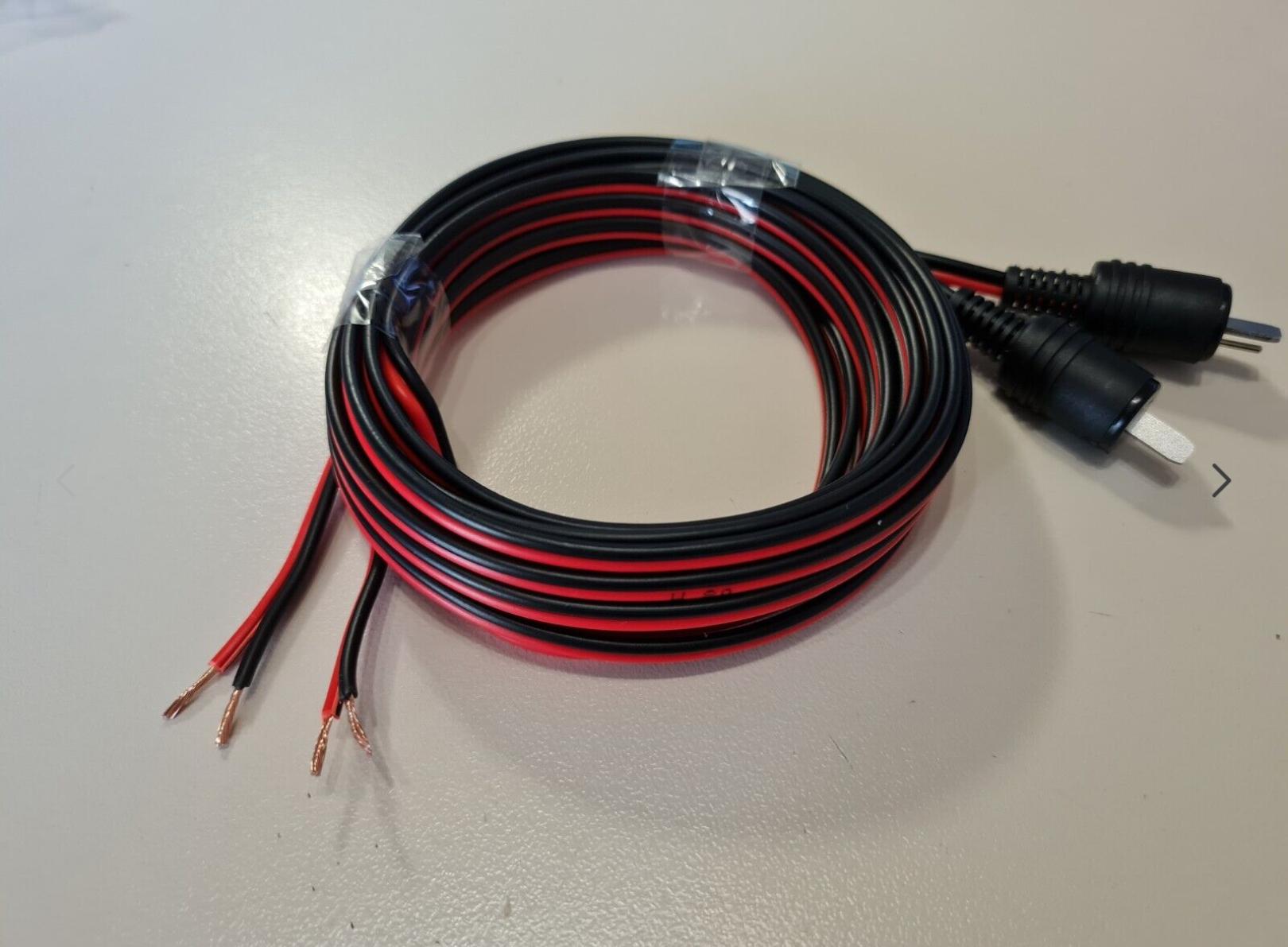

    Hi Rüdiger
    You’ll need something like this
    IMG_0880

    #57986
    Tschirner1929
    Hello again after a long time.
    I finally bought this cable and connected it.
    Unfortunately it doesn’t work and now I have a new suspicion and the next – for you B&O cracks probably very ridiculous and simple-minded – question. But hey, sorry, I’m just a completely clueless newbie in this subject:
    I know that my mother always used a remote control for this system. However, this was lost when she died and her apartment was cleared out.
    Could that be why I can’t get any sound out of the speaker? I put in a CD and both the Beomaster 7000 and the Beogram 7000 are switched on and the speakers are of course connected to the cables. The CD also seems to be spinning in the drive.
    I can’t find a manual option on the device to change anything! Is it possible that the devices cannot be operated without a remote control …and if so, are there still replacement remote controls available today?
    Thanks again for the support of an idiot! 😉
    Rüdiger
