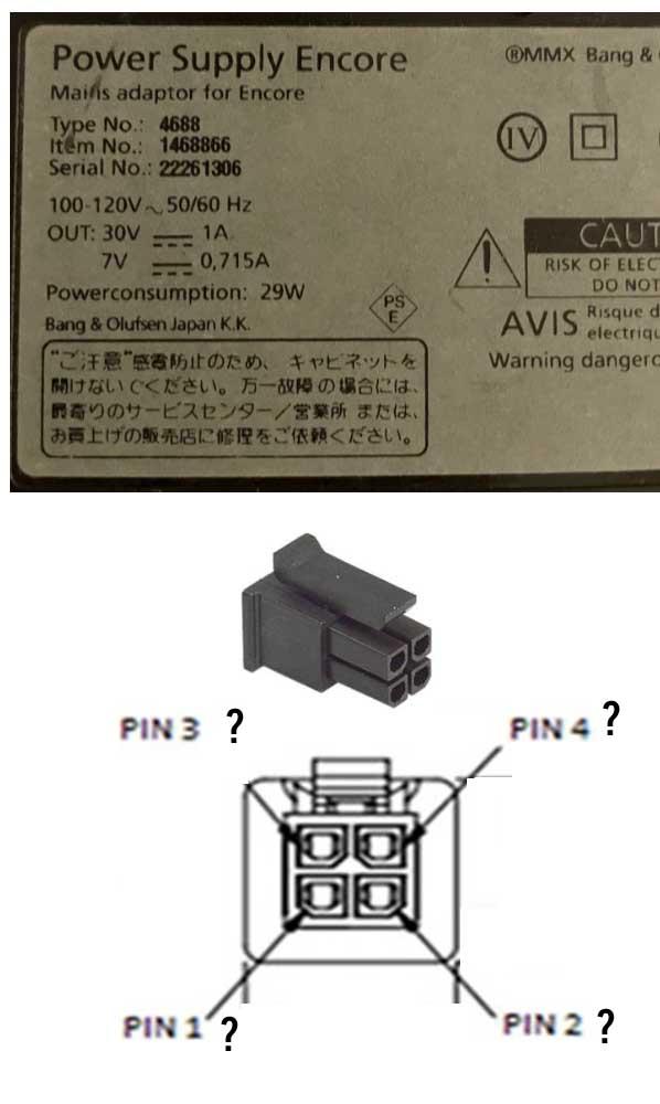

    Hi,
    Can I use a regular 12v DC power adapter for Encore 5? I lost my original B&O power adapter.  I’m thinking to modify the DC power cable.
    1. What voltage is required? 12v? 5v?    Do I require 2 separate voltages to power up?
    2. What’s   IR   at pin 4?
    I don’t require to link to external speakers or such, I’m only using the headphones OUT jack. So just looking to power up the Encore 5 will do.
    thanks in Advanced!
    #47670
    ayay
    i realised my connector is this…
    does anyone knows which pin goes to which?
    #47671
    Madskp
    GOLD Member
    I would suspect that 2 of the pins is Ground and probably internally connected.
    If you have a multimeter you could do some continuity testing to find out if any of them is connected.
    hope this could help you a little
