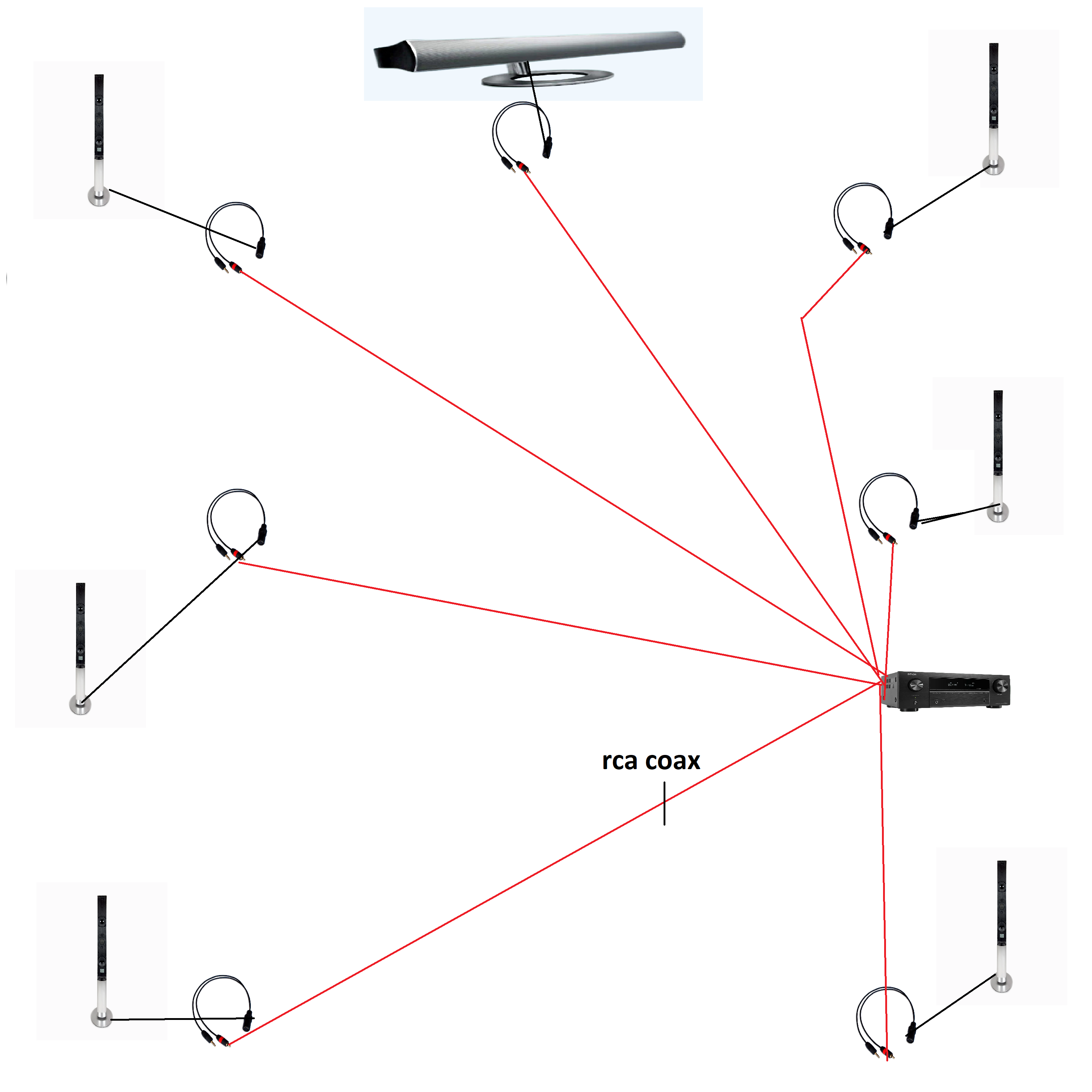

    Trying to connect 6 beolab 1 ,and a beolab 7.2 in a surround setup using my denon avr`s pre out.
    using mk3 cables for the all beolab1 speakers and mk2 for the 7.2 speaker.
    the trigger cables are placed with the avr .
    Problem: a slight noise in the beolab 1 speakers and more noise in the 7.2 .
    changed the trigger cable for the 7.2 to a type with usb instead of the mini jack that pluges directly into the denon.   that did help alot , but still some noise.
    It seems the noise is mostly from the denons trigger output (bought a filter,but did not help) , so my question is :
    will it be better to run coax rca from pre outs directly to where speakers are placed – in to trigger cable there and then in to speaker.?
    will connect a smart relay to trigger out on the denon and a smart relay where the trigger cables are. they will then activate when avr is on.
    will this help with the noise ?

    this is why I was wondering if it is better to mowe the trigger cables to the speaker location and use rca coax from avr to the trigger cables .   There is at least 12 meters from avr to the furthest speaker.
    I am thinking the coax cables is less likely to pick up noise ?  So if someone knows if this is a better solution or have something else that could be better I would like to know 😊
