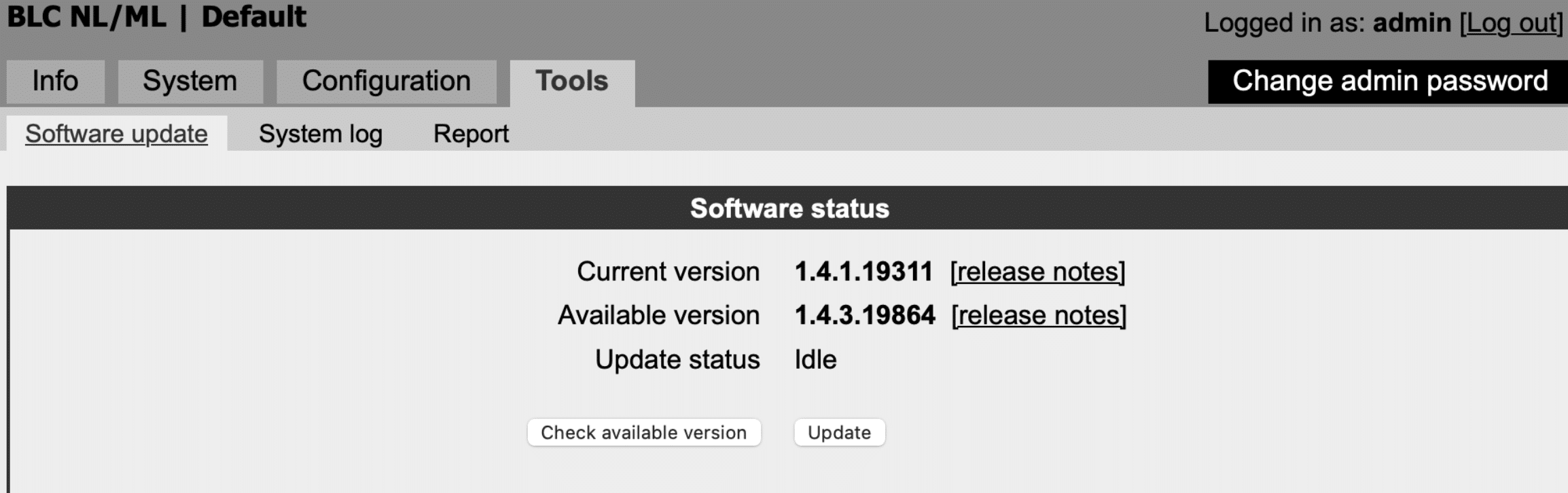

19 May 2025 at 09:03 #65698Ce Lee
BRONZE Member4 June 2025 at 21:27 #66196 Rolf2GOLD MemberA dealer will be able to upgrade your product. Updating online is no longer available.

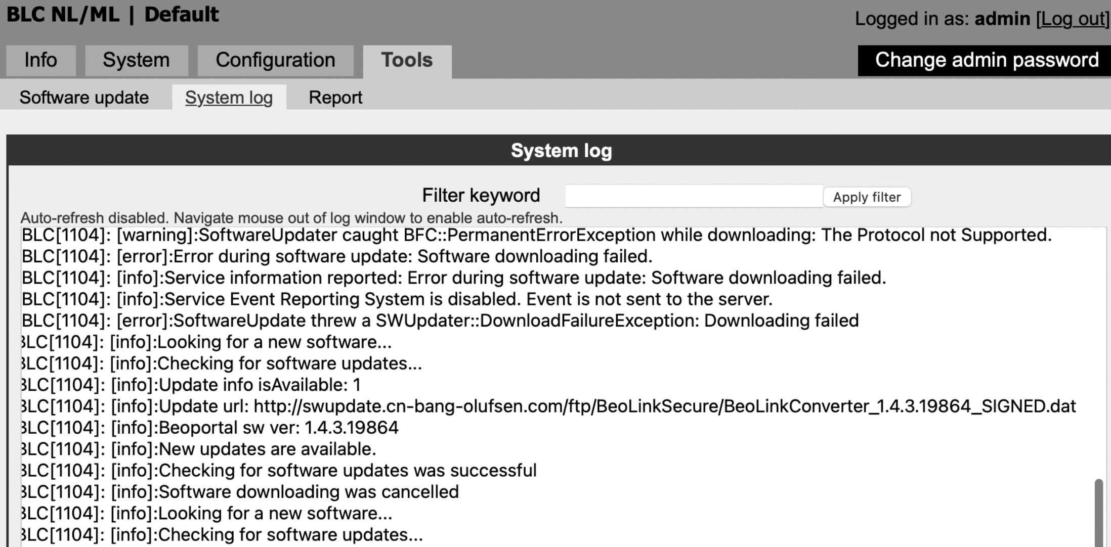

30 October 2025 at 11:22 #70781
kallasrBRONZE MemberBefore installing my newly acquired BLC I wanted to install the latest software (it runs on version 1.4.0.18322).
Just learnt it is not available for download anymore.
It is a shame, it does not update anymore by itself.
Since I do have the software itself, I’d just need the Service Tool MK2+ to install it.Any chance this can be provided by someone on this Forum?
Thanks in advance.
