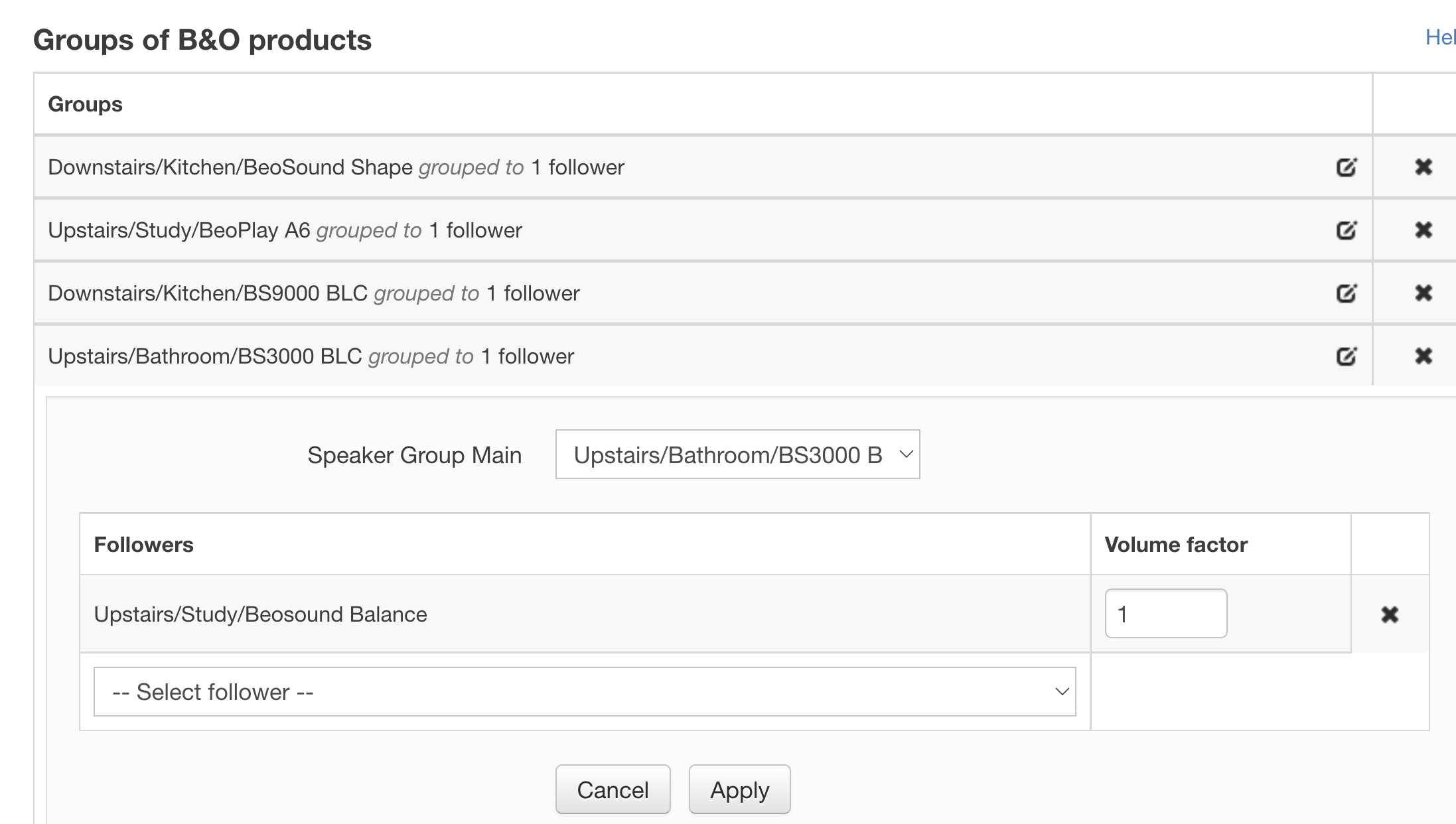

BRONZE MemberThis method describes a way to “integrate” a BLC with a Harmony/Eclipse/Balance/(maybe Theatre) using an existing feature of the Beoliving Intelligence .
Program in the Beoliving Intelligence a group of B&o products with the BLC as main product:

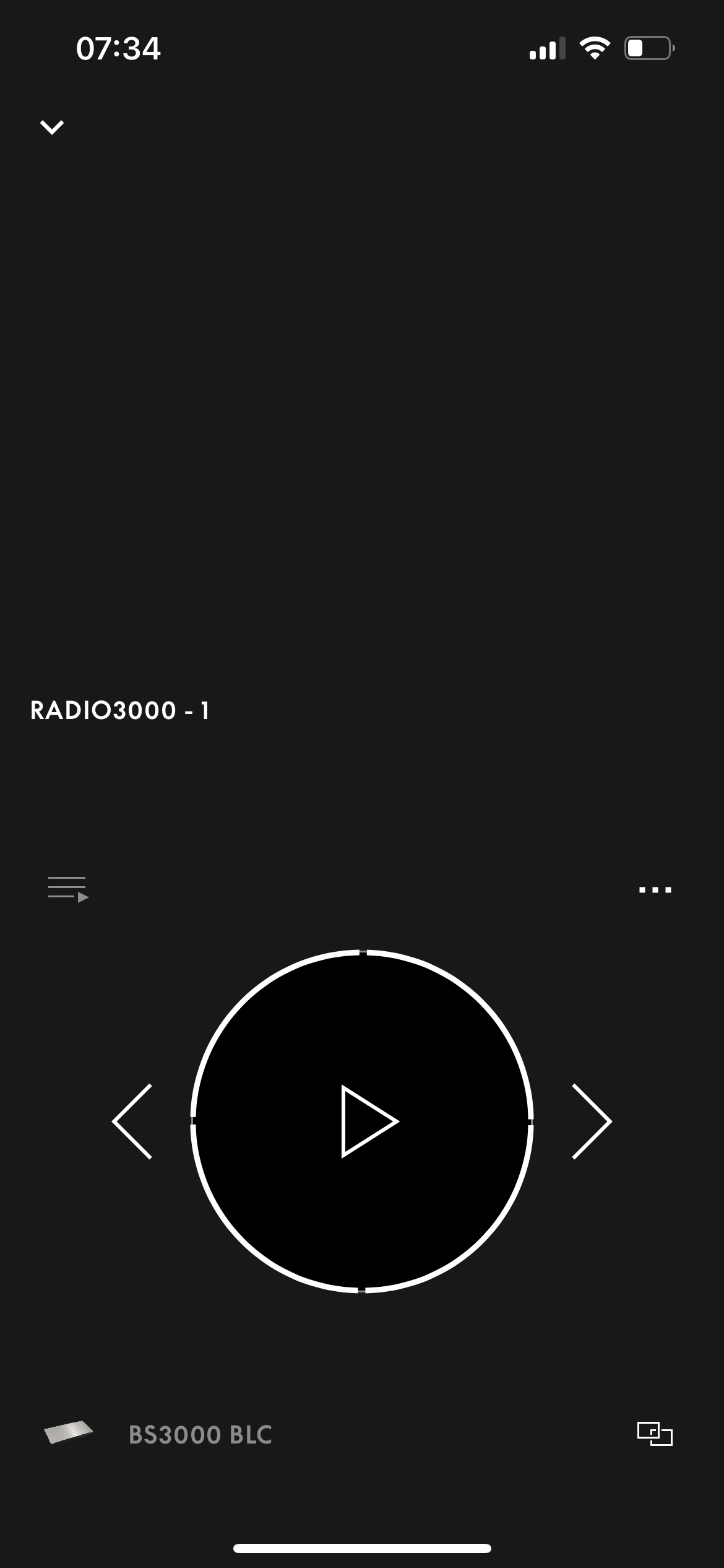

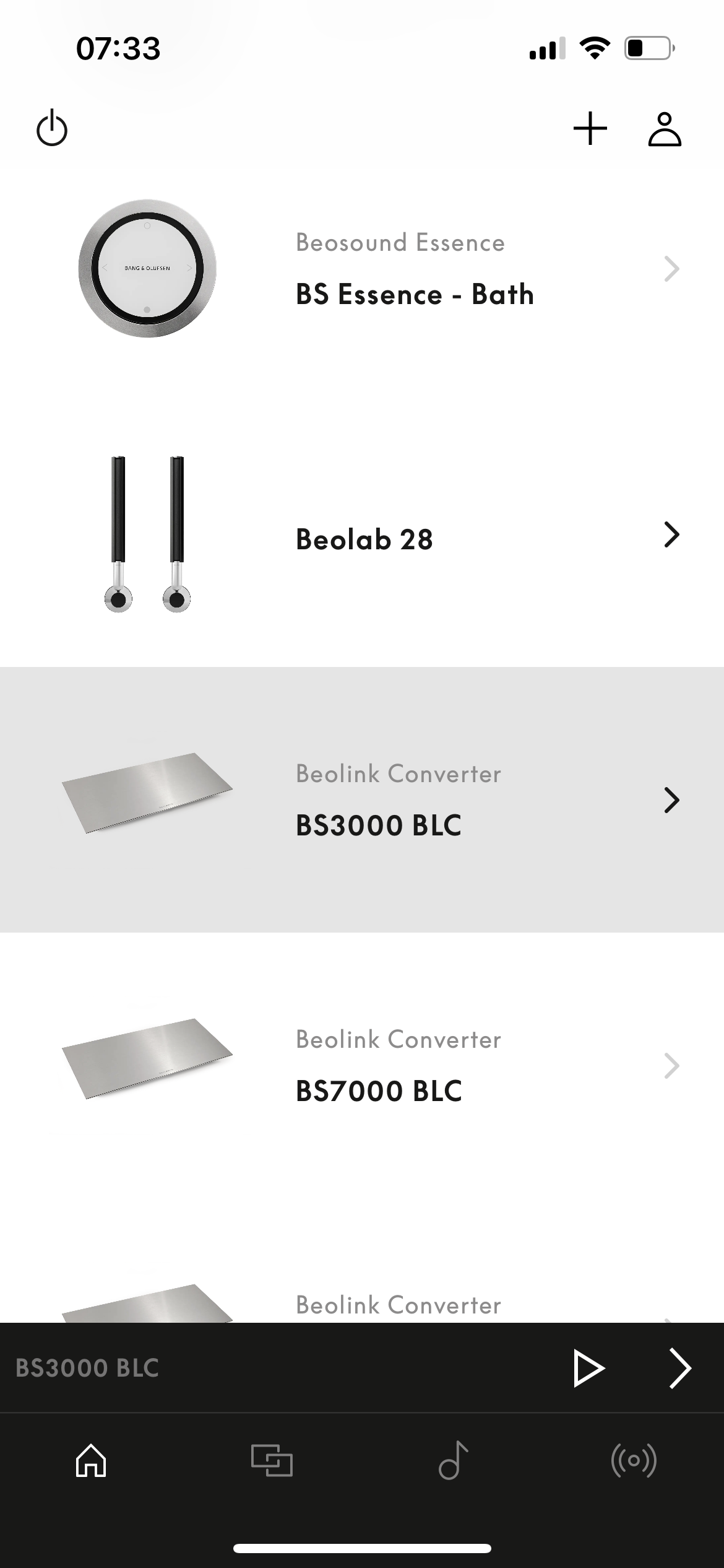

on this example the main is the BS3000 BLC and the follower the balance.To start the BS3000 Radio or CD, go to the BLC in the B&o app. Start f.e. the BS3000 radio on the Beosound Balance:
