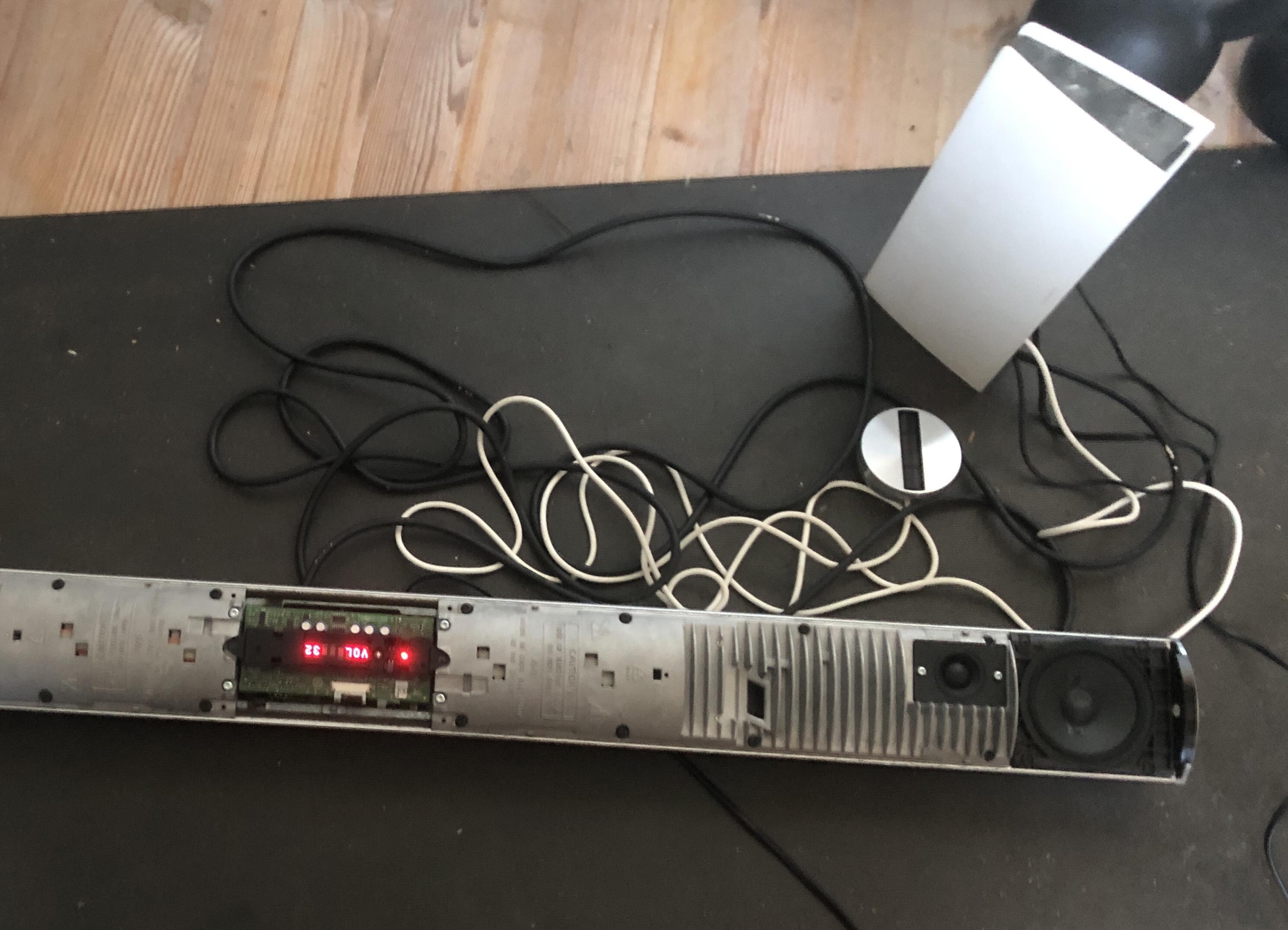

Did a little disassembly to investegate on pinouts. Removed display module, cross field PCB and Micro computer.
After putting it back together I can now set options again, but no way I can choose a source.
Pressing Menu, menu, 0, 2, GO now I sometimes get an error 1, 2 or 4 with both of my BLC 1611.
hmmmm what to do

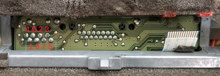

GOLD MemberWhile I had it open i did some probing with a multimeter to find out what the pins on the 8 Pin DIN connector goes to.
The PCB for the plugs are clearly redesigned compared to the MK1. For example PIN 2 is in use on this PCB. I have shown where the pins end up on the PCB in the picture below.
Pin 1 – As far as I can tell it has no connection to anything
Pin 2 – Ground for audio. Called GND REF on the block diagrams in the servicemanual
Pin 3 – Audio left – Called PL in L on the block diagrams in the servicemanual
Pin 4 – Not really sure. I measure 100 Ohms resistance between the numbered soldering point and the pin 3 on the flat cable to the crossfield PCB. It is called SP ON on the block diagrams in the servicemanual. Unfortnuatly I can’t trace it further from the connecter on the crossfiled PCB which looks very much the same as in a MK1 BL3500
Pin 5 – Audio right – Called PL in R on the block diagrams in the servicemanual
Pin 6 – DATA – Called DATA on the block diagrams in the servicemanual
Pin 7 – Ground for data – Called GNDD on the block diagrams in the servicemanual

GOLD MemberPressing Menu, menu, 0, 2, GO now I sometimes get an error 1, 2 or 4 with both of my BLC 1611. hmmmm what to do
Started fault finding. Replaced the IR board with the one from the MK1 BL3500. Nothing changed.
Replaced the microcomputer board with the on from the BL3500, keeping the MKII IR board. Still errors.
Replaced both the microcomputer and the IR board. Now it works fine, so I think I can rule out the crossfield and plug board.
So the fault is probably in the Microcomputer or the IR board or both. Don’t know how dependent they are of working together from MKI and MKII.
Next step will be to control some voltages

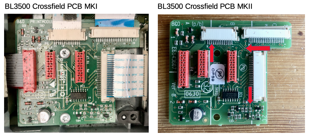

Location: Denmark11 June 2023 at 12:20 #44582Madskp
GOLD MemberEvent though the BL3500 MKII is faulty I can still do some detective work on the PCB’s about the PL connection.

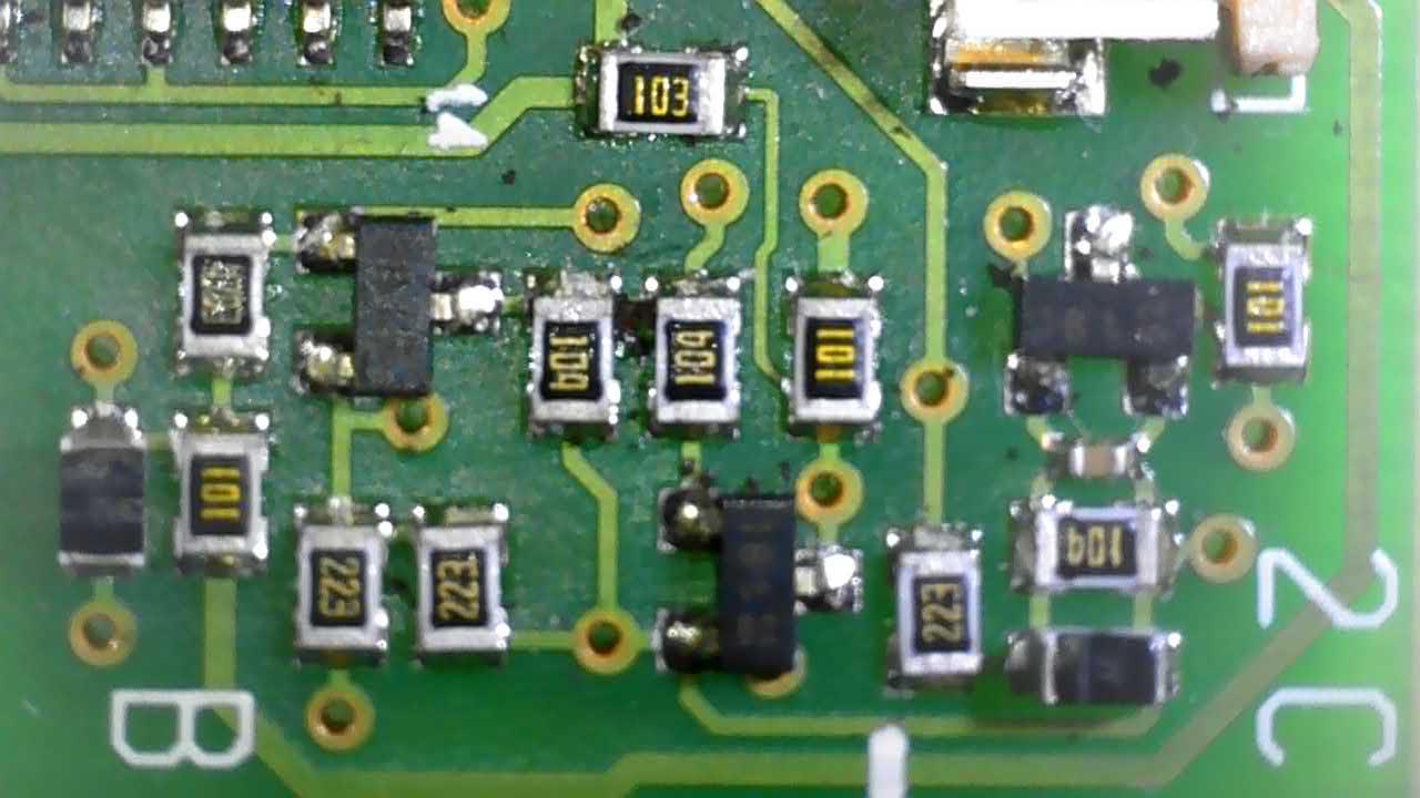

I have to admit that I was wrong in my quick assumption that the Crossfield PCB’s was that same in the MKI and the MKII
Having a harder look and probing with my multimeter I found the place where the connection from PIN 4 on the powerlink connecter goes. I have marked the route with red arrows on the above pictures. It ends up in a area with 3 transistors and some other components in the right bottom corner. The PL data signal is also comming to this area.
This area is clearly rearranged compared to the MKI.
Looking at the diagrams for the MKI I can see that this is where the MCL data signal come in on that and pass to the microcomputer
I have yet to analyze how the PL pin 4 signal is comming in to this circitry, and if there are changes in it.
One thing is for sure though. The PL pin 4 signal is not present in the MKI.
I have done a test with the MKI earlier https://forum.beoworld.org/forums/topic/bl3500-and-the-mcl-pl-connector/page/2/#post-17635 where I was able to activate the speaker with powerlink data conncted instead of MCL data, so the use of the PL Pin 4 signal might have to be in combination with powerlink data.
I just did a quick test on the MKII with powerlink from my MCL2AV just to see if it would activate anything, but no luck. However that could be due to the other faults I have on it.
Location: Denmark12 June 2023 at 10:52 #44583Madskp

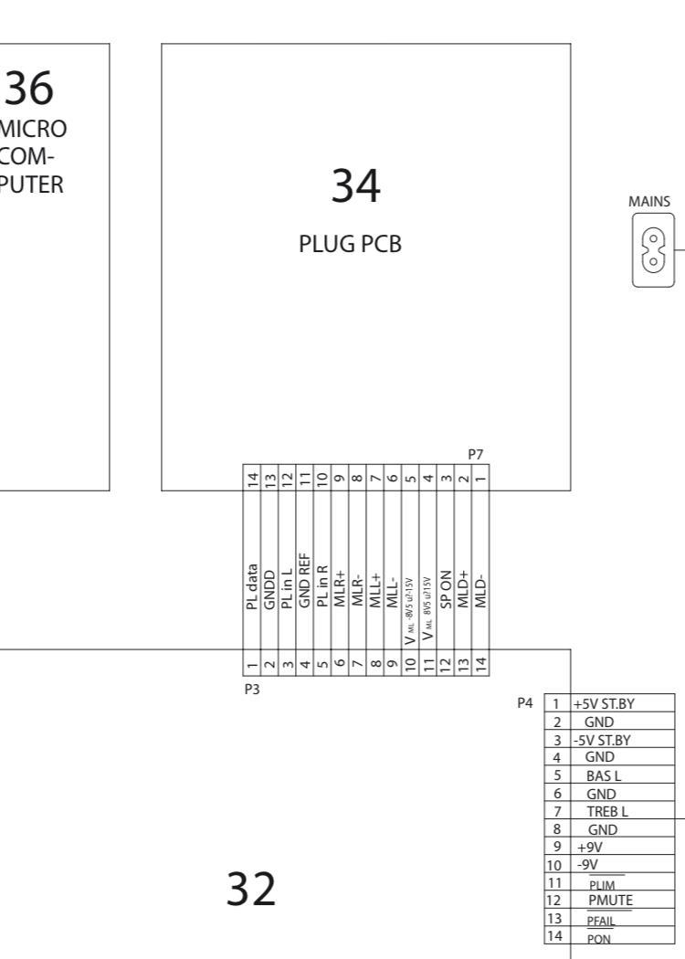

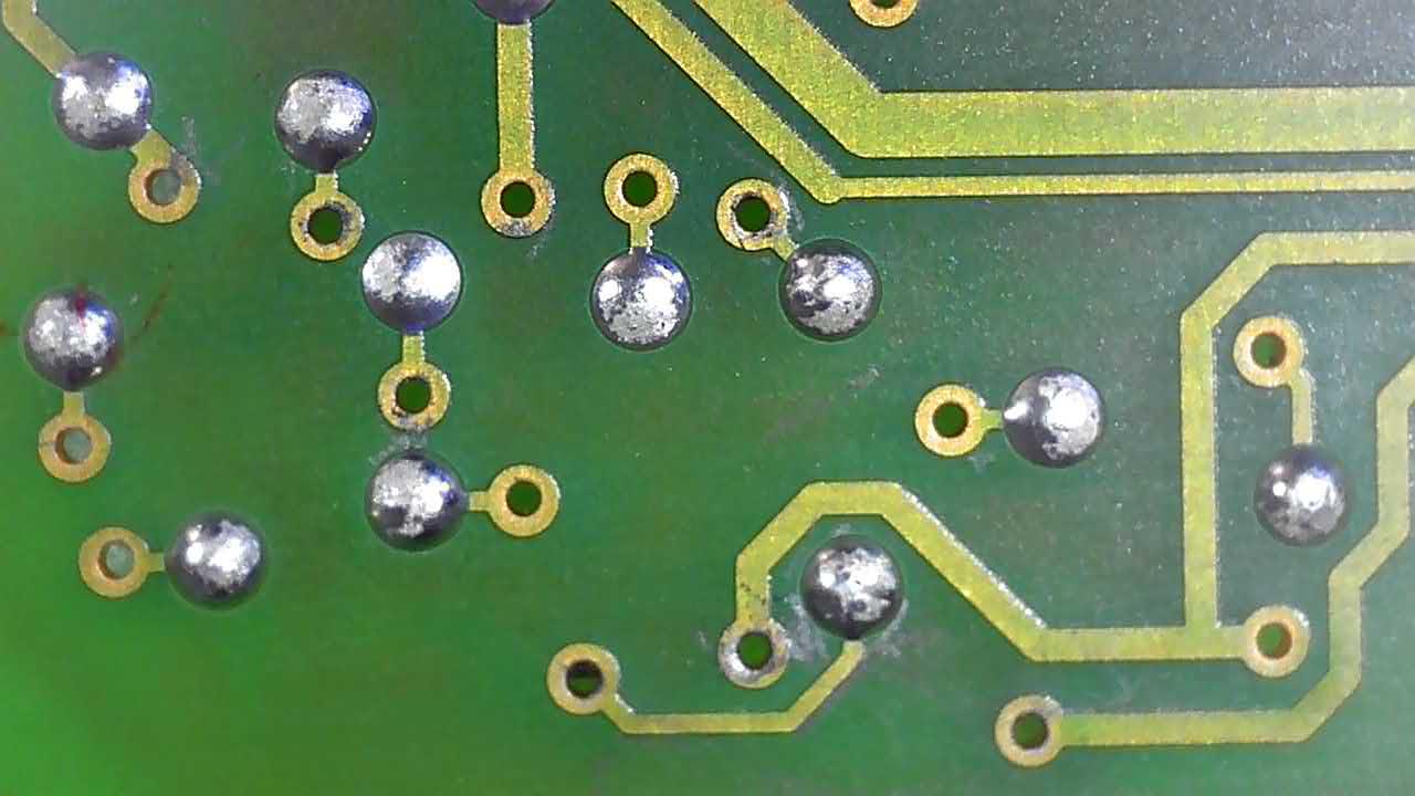

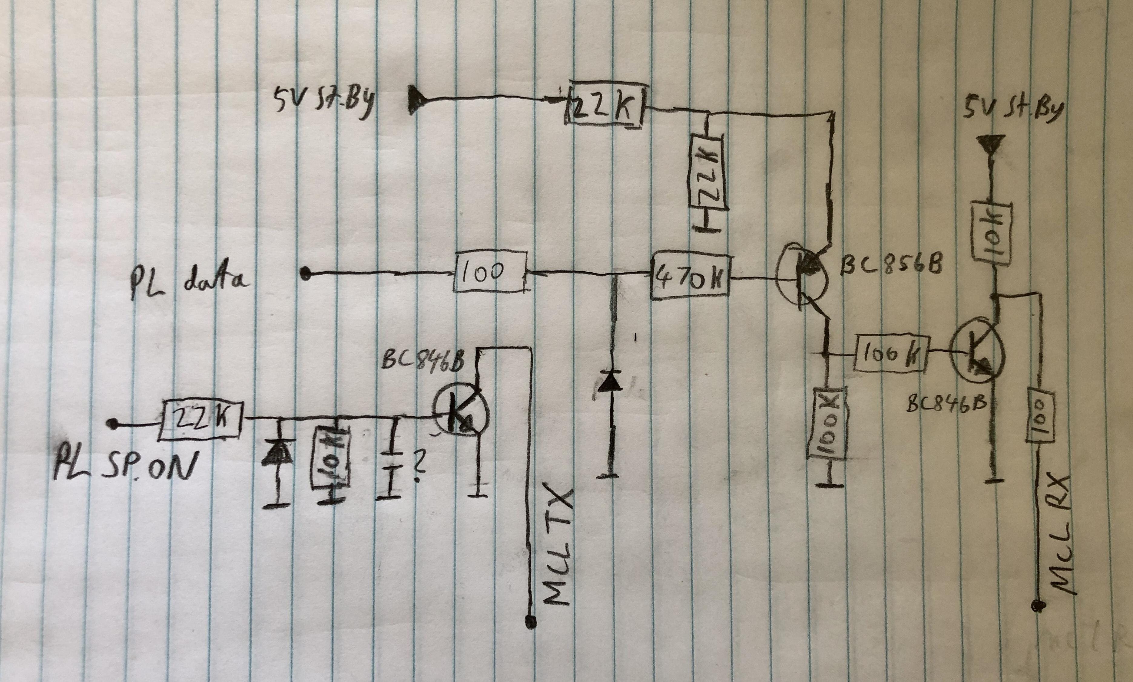

GOLD MemberIt took some time, but I now think I have found out how the circiut is constructed in the MKII. I used both multimeter and microscope to spot all the connections. Microscope picture here:
And from the the other side of the PCB:
Most of the VIA’s just end up in testpoints with a solder blob on them. This is a little confusing when trying to figure out where the traces go.
This is how I have analysed it to look like in diagram form. I have tried to make it in the same form as the diagram in the MKI service manual to make comparison easier.
I have used the names from the connectors in the MKII servicemanual. It might be a little confusing as there is both use of PL and MCL in that.
One thing to notice is that the circitry is now divided in two. One with the PL sp.on from PL pin 4 which is connected to MCLTX, and one with the PL data from PL pin 6 which is connected to MCLRX.
Location: Denmark12 June 2023 at 14:51 #44584Madskp
GOLD MemberA little test to see what is happening when powerlink is connected to the MKII BL3500. Powerlink signal from MCL2AV.
When in standby the voltage at MCLTX is 4.93V, and when powerlink pin 4 SP ON is activated MCLTX drops to 0V. That could be an interesting lead as to how the speaker should be activated when in working condition.
On MCLRX I see small voltage drops when a remote command is used, much like when measuring on MCL data lines, so nothing I can make anything out of.
